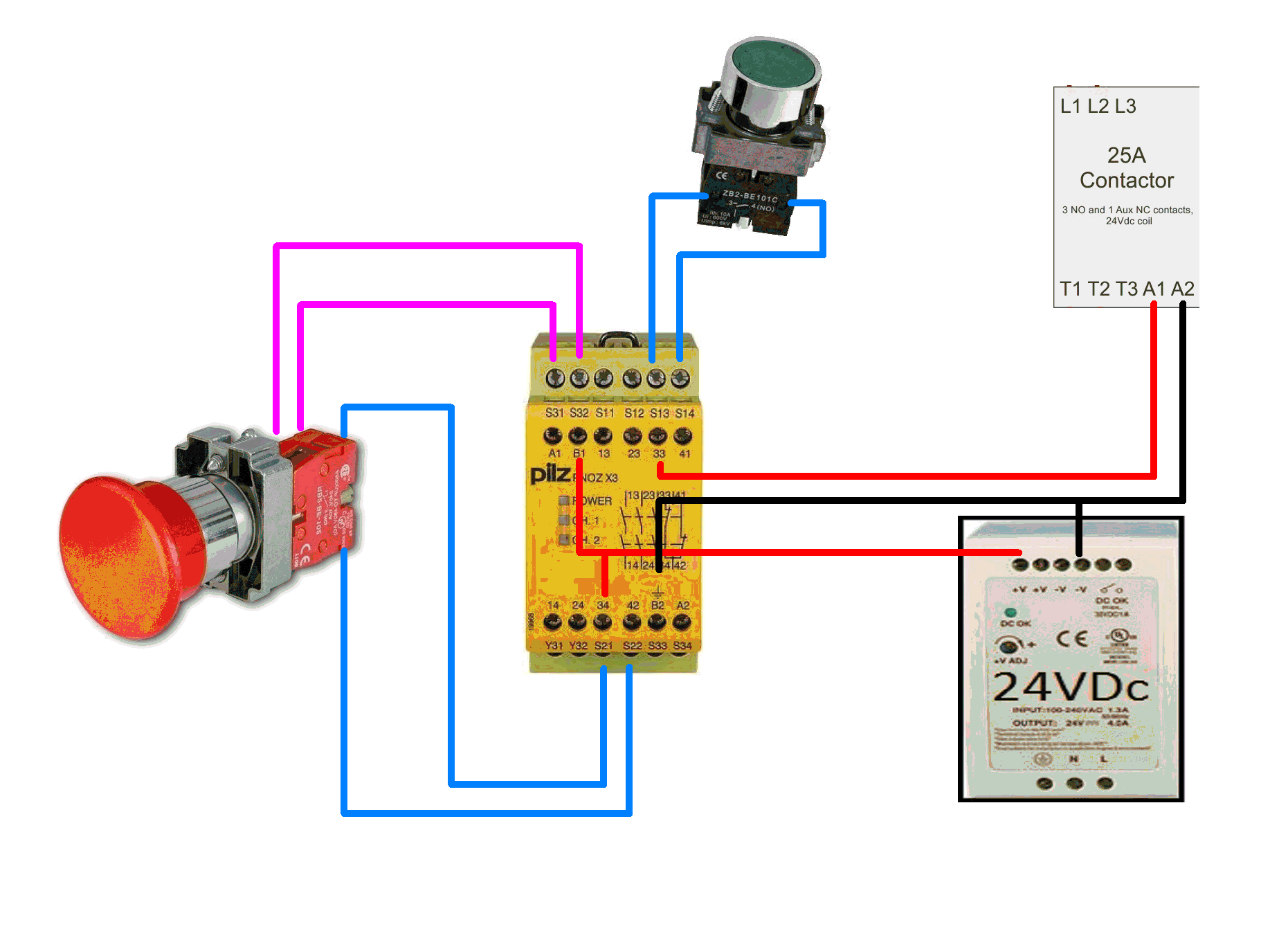

    That's the only thing I'm clear on Dean, what I'm struggling to get my head round is which terminals look at which relays. I'm not going to be switching AC now I don't think as I've got a 230V contactor with 24v DC coil coming (3 NO & 1 NC contact) so will switch the AC through there...
    Neil...
    Build log...here
  2. #552
    Easy neil.
    13 & 14 NO Contact
    23 & 24 NO
    33 & 34 NO
    41 & 42 NC
    If you want Short circuit across contacts detection then use Dual channel E-stop which means 2 x terminals on each E-stop connected as below.
    Contact #1 between S21 & S22
    Contact #2 between S31 & S32
    Then jump wire between S11 & S12
    Reset button Between S13 & S14

    Ok so those are the connect through terminals, which are the ones that control them? There's 11 & 12, 21 & 22, 31 & 32.....
    Like this Click image for larger version.

    Quick hand drawing of power circuit so far. Pilz X3 is switching the contactor to kill power on e-stop.

    Christmas morning today...Pilz came so knuckling down to finish the wiring diagrams so I can get it wired up....
