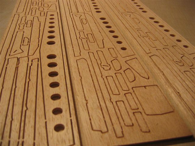

    Below is the sort of thing I'm looking to cut on the MDF router. No drilling, I'll be using mostly 2mm cutters (somethinig like this I guess 10x Carbide Drill PCB End Mill Engraving Bit CNC 1.2mm | eBay )in the E50 Proxxon I have but yes will look at height for tool changes.
