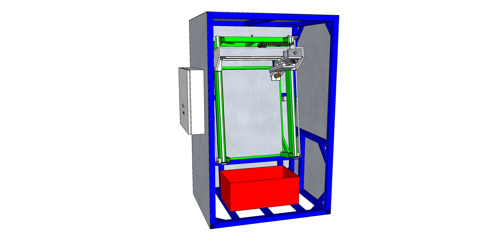

    Clive, my router is going vertical so that's not really an option for me, looks a great solution though! I'm going to build a frame/enclosure to put it in which will eventually be fully enclosed with interlocked doors (safety because it's at work) which will also stop the chips from being flung all around the shop floor!

    I like the idea of keeping the water cooling on the Z axis, might look at small PC radiators and fans....

    I'm torn between mounting it on the Z axis or on the enclosure frame. I'm sure that the small volume will be OK but I'm erring on the side of caution and thinking of mounting it on the frame, that way there is a bit more water in the system. I've got a 240V small 200 l/hr pond pump, but it's a submersible one so I might just go with that in a bucket with a lid for the time being and then adapt the water circuit later....decisions decisions!
