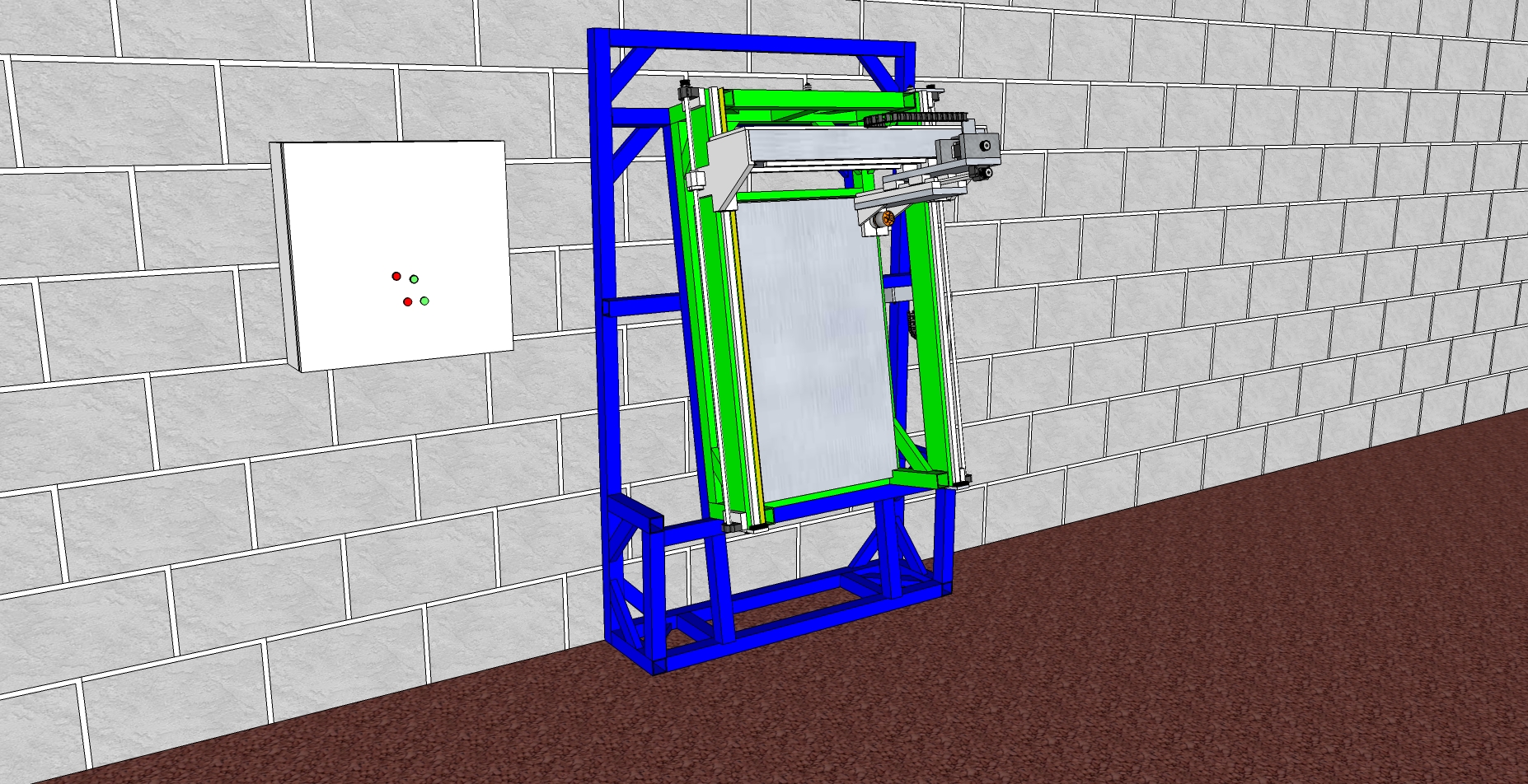

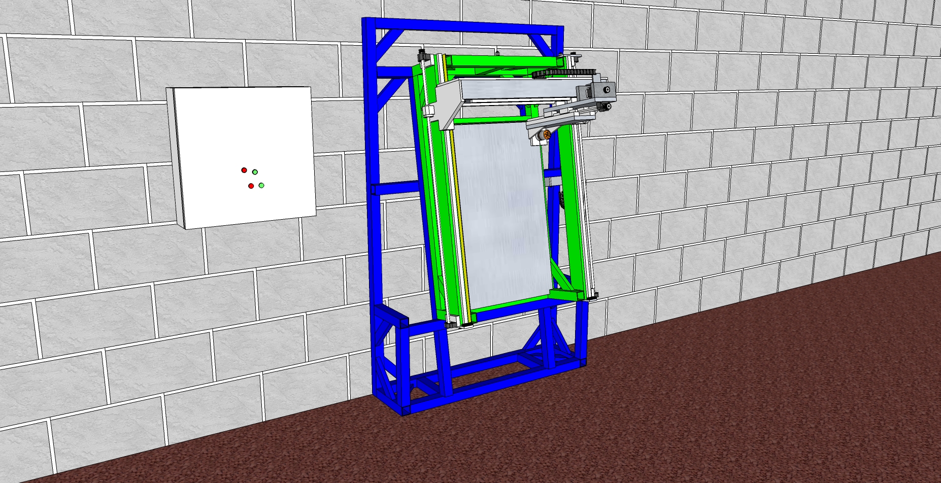

    Unfortunately not had a chance to do any more on the machine as real work has got in the way. Still I ordered the steel for the frame (re-designed it to a basic frame that I can then box in if required) which came today.
    Neil...
    Build log...here
  5. #664
    Frame re-design....hopefully I can keep the number of re-draws to below 6 this time. router is held to the frame with 4 off M12 bolts
Name:	Small CNC Router Frame.jpg
    The frame is going to be mounted to the wall and floor rigidly and adjustably so it can be mounted level and slightly off the wall to get access to the botls holding the router to the frame (I can see a re-design on its way already...)
