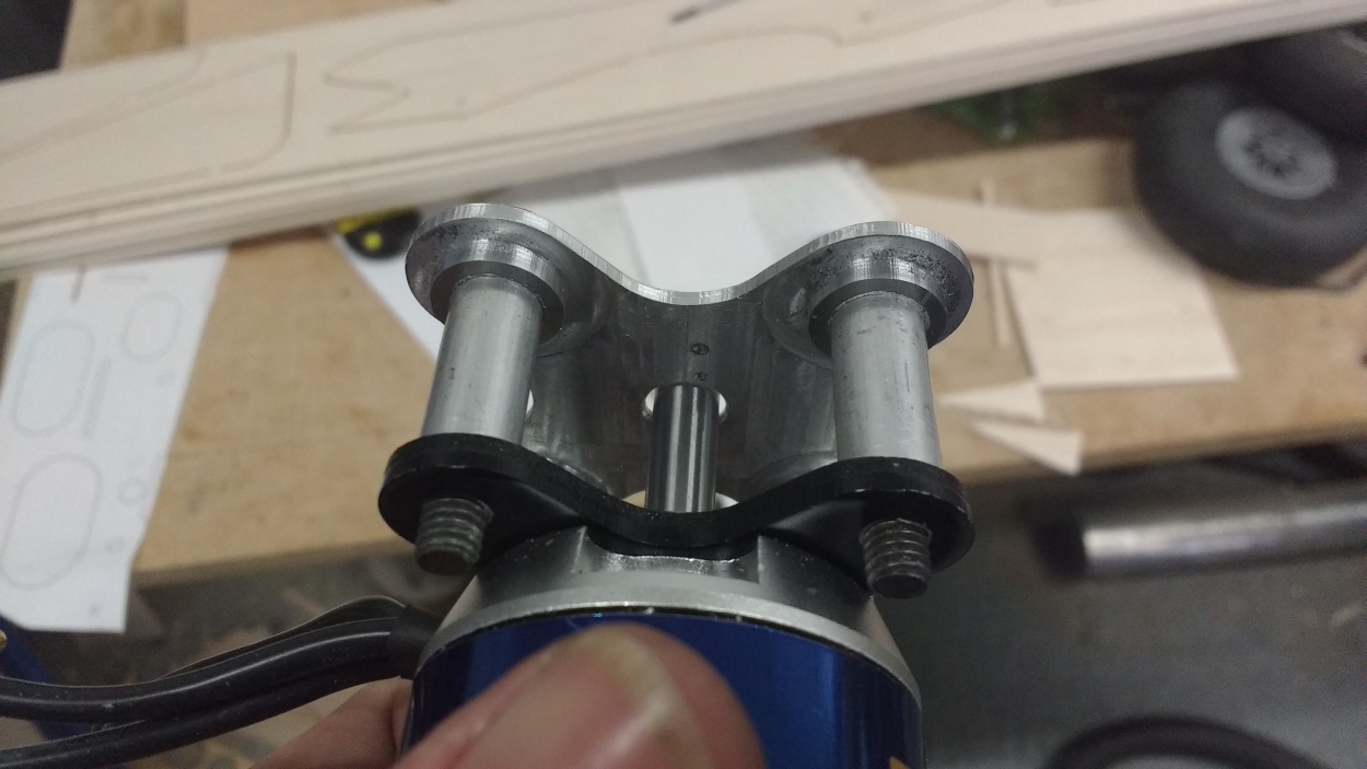

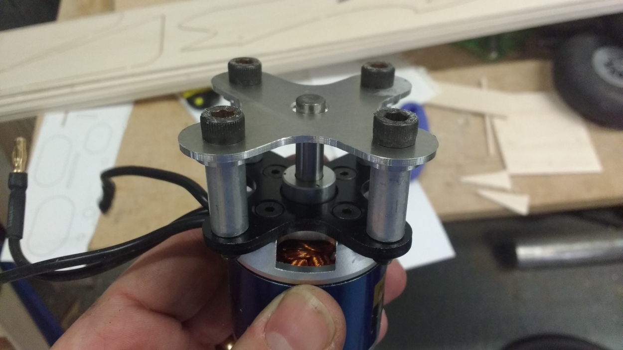

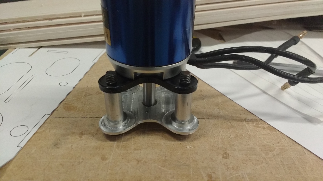

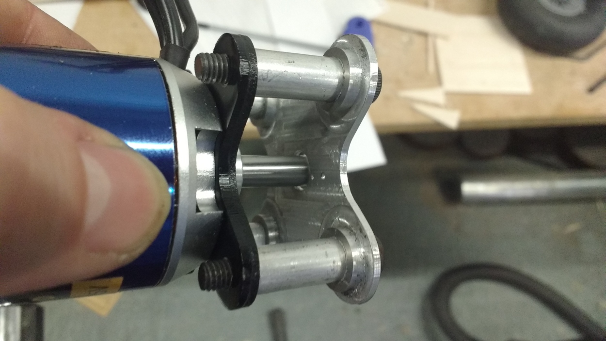

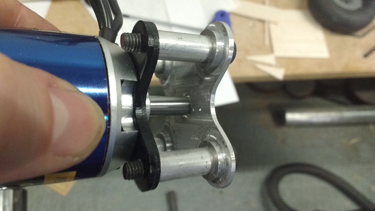

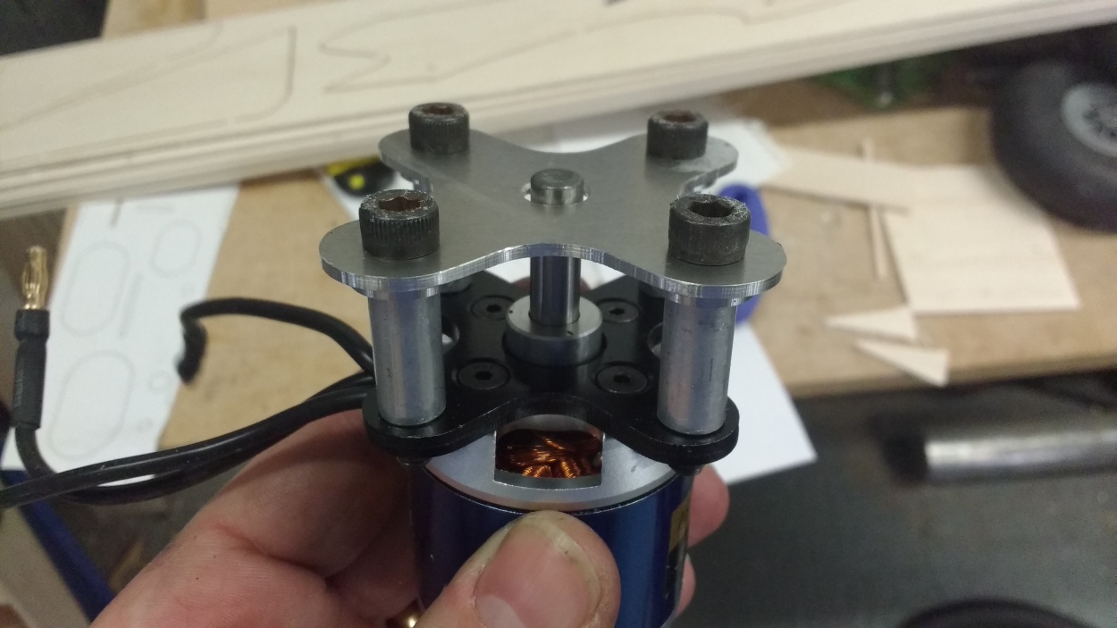

    Just finished the Mk2 mount....could have been a Mk3 but this will do! Did put some engraving in the middle but got the depth wrong and it snapped the engraving bit Still I forgot the hole in the middle for the shaft to go through (manually drilled) so that would have gone through the engraving anyway....Pressed the tubes into the plate on our hydraulic press and at 2.5 tonnes pressure I don't think I need to use the Durafix to weld them in...might do it anyway but I'll see. The bolts are pulling the tubes into the plate so they're not going anywhere, just the torque twisting them. Might get a big block of Ali and mill it out of 1 block though I'll probably not bother if this works...

    No it's simply a spacer to hold the motor off the firewall so the propeller sticks out the nose the correct amount...
