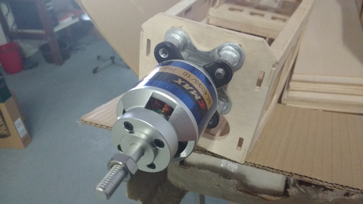

    Here's the bracket after I've made a mess with the Durafix, machined 5mm off the tubes (lathe) and bolted it to the firewall....only got 2 bolts in at the moment but WILL have all 4 in before anything electrical gets connected I promise!!!

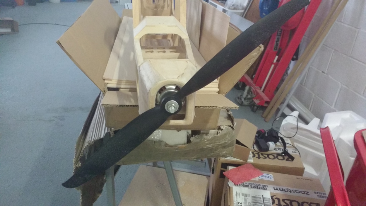

    Put the nose cone on and fitted the prop (18" diameter x 8" pitch) to see what it was like...

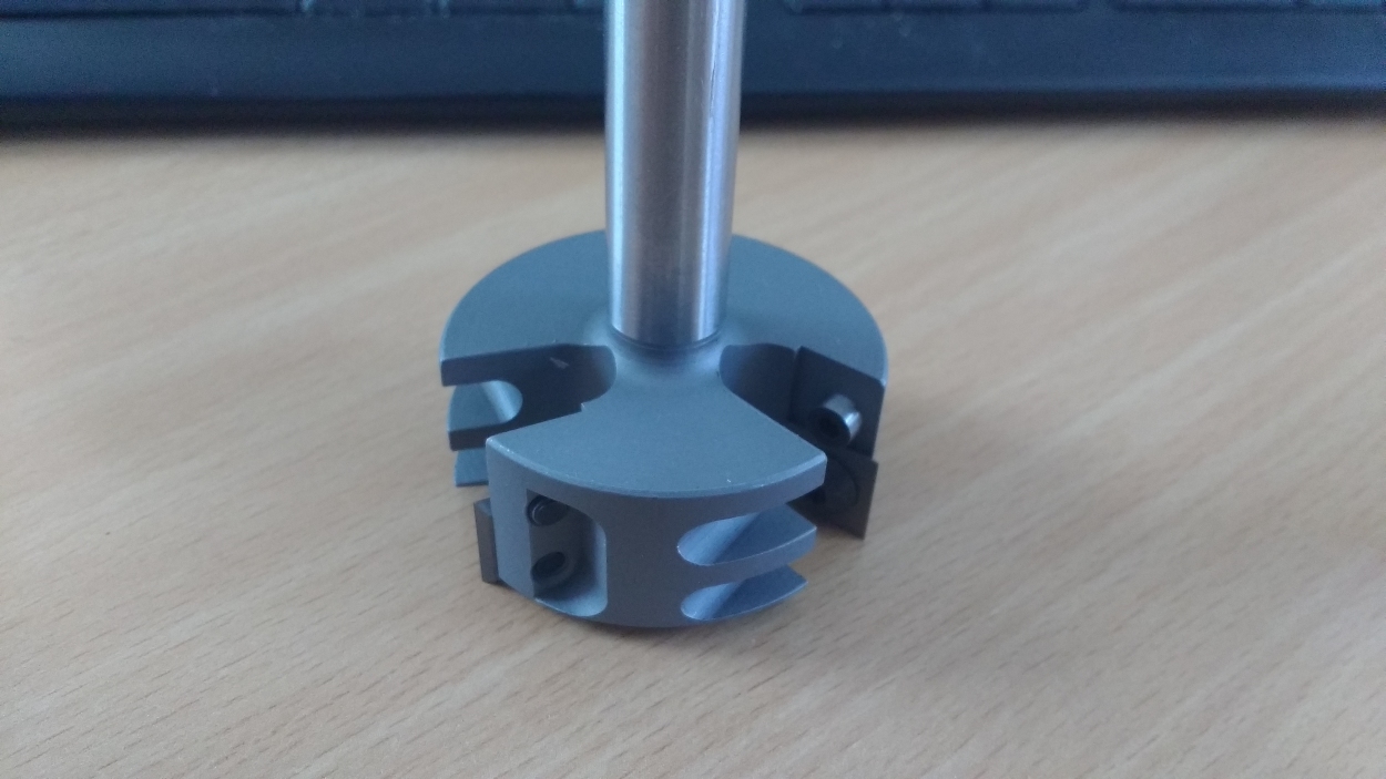

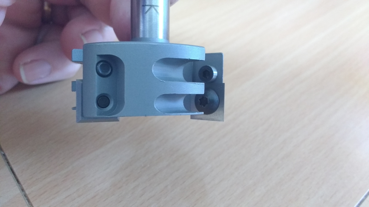

    Right or wrong it works, installed 2010 screenset and used the simple tool zero and yep......it works!!! Had the bit loose in the collet just in case!! Bought a trepanning tool from Wealden as recomended by Dean and set the height to the base and took 1mm off the bed (it's really bad!!) Felt some ridges so tweaked the spindle right by 0.2° and the bed seems pretty smooth now...

    Just need to do the limits so I can home the machine and put the fixed tool change plate on (when the new bed is on the machine!) and make the frame....dust extraction unit....put electronics in the box....etc. etc. etc. etc............

    That looks like a nice cutter - might grab one myself when ordering from Wealden next (I've been very impressed with their routing bits etc. to date).

    I can tell you one thing....there's no way that I'm using that bit to drill a hole in my head!!! However it does surface the bed beautifully
