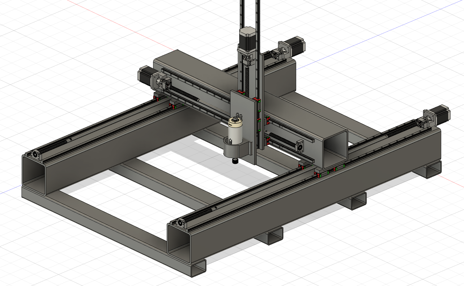

    I am planning on making my first cnc router, without much experience. I want to cut wood, and hopefully the occasional sheet of aluminum and some copper.
    My draft use 200x200x10mm steel tubes for the X- and Y-axis. Two 20mm linear rails and a ball screw on each section. 20mm steel blocks on top of the rail carriages. Z-axis use 10mm steel plates. I’ll look into adding a house for the Z, and maybe removing the spacers there as well.
    The bed rests are 120x80x6mm steel tubes, bolted on to the square tubes as I don’t know how to weld. Total machine size is 1900x1400mm, with the gantry and Z-axis taking up about 400mm. Weight about 500kg without table. I guess I could make it shorter and try to tile my projects. Ignore the long rails on the z-axis, I’m still new to cad.
    Currently looking to use levelling epoxy for the rail surfaces, but the surfaces are rather large. Any experience with epoxy for this large an area?
    The gantry and Z-axis with spindle will be about 130kg. I haven’t done the math, but could two closed loop/hybrid servo nema34 steppers move it? Not looking to go very fast.

    200 x 200 is a bit overkill why this size.? 200 x 100 would work just as well and save weight and money, also easier to epoxy.
    Twin rails on the long axis are not needed for a machine this size and usage. Again drop them and save the money.
    Regards saving epoxy then just create a strip for the rails by fastening thin lengths of 10x6 steel on the surface and use these as dams.
    With the 130Kg and could closed-loop steppers move it then yes easily if you use 230V mains drives. Regards the speeds then you are making the classic mistake by thinking you don't need to move fast. To be honest it's got nothing to do with what "YOU" want to cut at and everything to do with what speeds n feeds the material and tool require to be cut at.
    Get this wrong and you'll have poor finishes and wear out tools or worse broken tools.
    You need to seriously work on the Z-axis. What you have now, factoring in the rails not being correct, would be very weak. There would be no point building the base frame and gantry so strong only to fit a weak Z-axis.
    The Z-axis is THE single most important area of a machine because it holds the spindle. Your's needs a lot of work and seriously strengthing. I would consider moving the top rail from the front face to the top face to give more spacing between the rails and support the Z rear plate more.
    For Z axis plate you can bolt some flat bar to the sides to stiffen it up.

    100x100x3mmm tubes works best IMO as most simple the build and could be cut at home using Rage or normal saw. And yes, if you could find sth like 80x120mm even better. The ideal for the gantry is 200x80, but as no such 2x 100x100 or similar will be alright.
    Better do the Z with the rails on the front plate and they to slide, not the bearings. makes a stronger Z. I would concentrate on the Z mainly and do the machine around it. As the machine is as strong as its weakest link, the Z is the weak spot most of the times.

    Thanks for all the good feedback! I need to implement this for the next draft.

    My own welded steel router is built from 50x50 and 100x50 steel box, all 3mm wall thickness (search for "AVOR" on this forum for a bit more detail). Overall size roughly 1800x1000 with a cutting area of about 1500x750. I'm happy with the overall strength of the machine but if I were doing it again, I would use at least 4mm, maybe 5mm, wall thickness steel. Not for strength but mainly to control vibration and resonance in the tubes. It also makes it easier to bolt on the rails, etc, as 3mm is a bit too thin for a decent tapped M5 hole. 10mm wall thickness seems way too much for the uses you suggest - that's heavy stuff!
