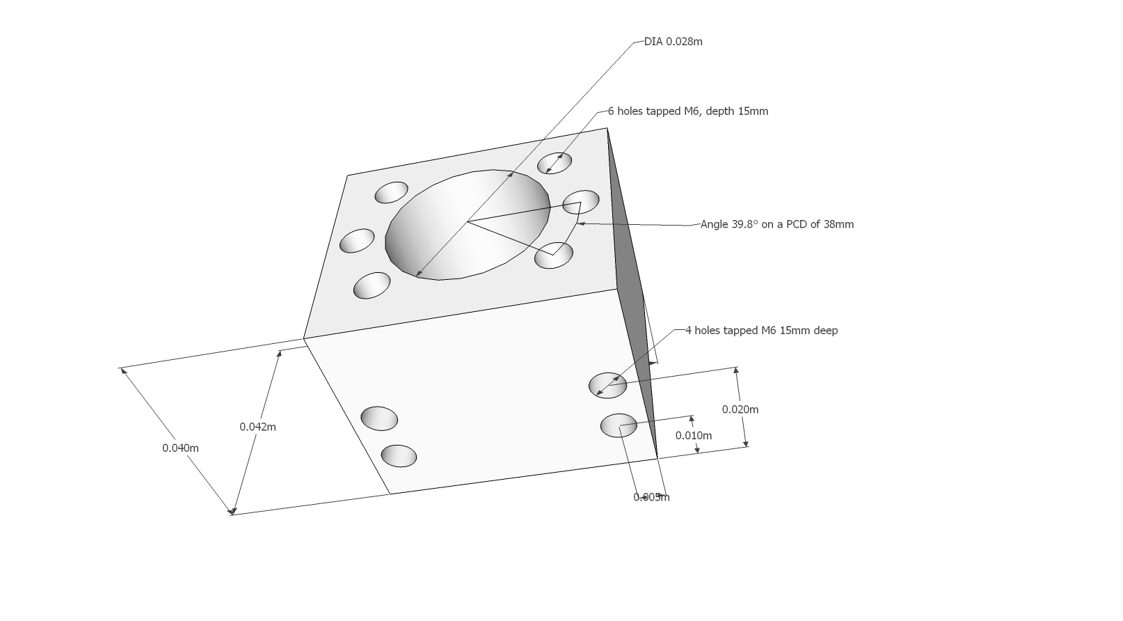

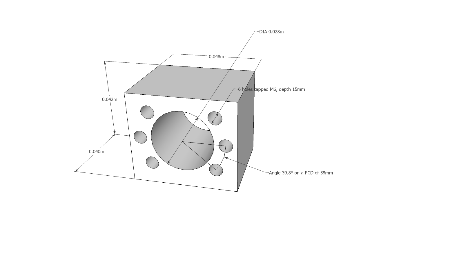

    What's special about the Z-axis ballnut mount that causes you to need a custom one?
    These are what I've drawn...
Name:	Inclined Z Ballnut housing_1.jpg
ID:	10383Click image for larger version.
Name:	Inclined Z Ballnut housing_2.jpg
    I wanted them low profile to cut down on the machining required, i.e. so I don't have to get the Z axis plates machined for clearance and so I can get the rails nearer together which I know is not ideal but as I'm mostly going to be machining balsa, ply and carbon fibre will be fine!
