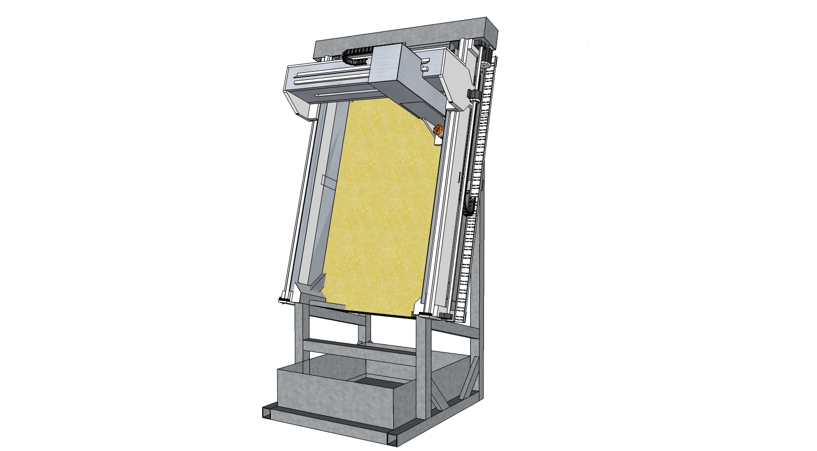

ID:	10150OK Dean, switched the gantry around again to how it was before. Have put a folded aluminium enclosure over the Z axis, on the bottom of the Z there will be a rubber cover (5mm thick rubber with cut outs for the rails) to stop chips going up into the bearings. Have put deflectors on the X axis to stop chips hitting the linear rail, also put a deflector down the bottom so chips slide into the bin. Have altered the ballscrew mounting so it's on 20mm block and not the aluminium box section as I'm not using that anymore. I will also put a cover over the X axis belt and steppers.
    Couple of questions now...
    1. I'm going to use 1 stepper and belt (T5, 15mm wide) and pulleys to drive the X axis, what number teeth pulleys would you recommend? I take it that it's worth getting spare pulleys and belts so that the option of 1:1 and 1:2 (stepper to ballscrew) is available?
    2. For the belt idlers/tensioners I was going to use skate bearings (as I've got sh*t loads of them) and penny washers, I couldn't see any specific idlers for the belts?
    Depends on how your having belt system.? My machine is setup with 2 pulleys bolted together on one screw with a single pulley on other. A short belt goes from motor to first pulley then connecting belt goes between screws. The ratio is 1:2 motor with 40T and first pulley 20T Connecting pulleys are 36T. I then have 2 spare pulleys for 1:1 or 1:3 ratio 20T & 60T.
    Connecting pulleys could easily be 20T for simplicity sake but I just happened to have spare 36T so used them.
    Don't go smaller than 20T other wise you don't get good tooth engagement and the belts wear quicker or worse they can jump. I'd also use HTD belts/pulleys not T5 has thou they are very similar the HTD just seem better fitting belt.
    Yep skate bearings and large Penny washers work fine for idlers.!!

    I was thinking along the lines of this, but measuring it is just over 2000mm long so might have to re-think it...oh and before someone comments I know it will have to be a belt and not a piece of string

    I'm not planning on being able to shove long work in and out, won't be practical anyway as I'm limited by the roof and floor as mine's almost vertical. I've just added some bracing to the legs so that's made the cutting area smaller with my previous width of Z axis....so I've narrowed it. I'm hoping that it's not too narrow, it's now 145mm wide. I'll have to check the 15mm carriages but I think they'll be ok at that width...

Name:	Mounting Frame.jpg
