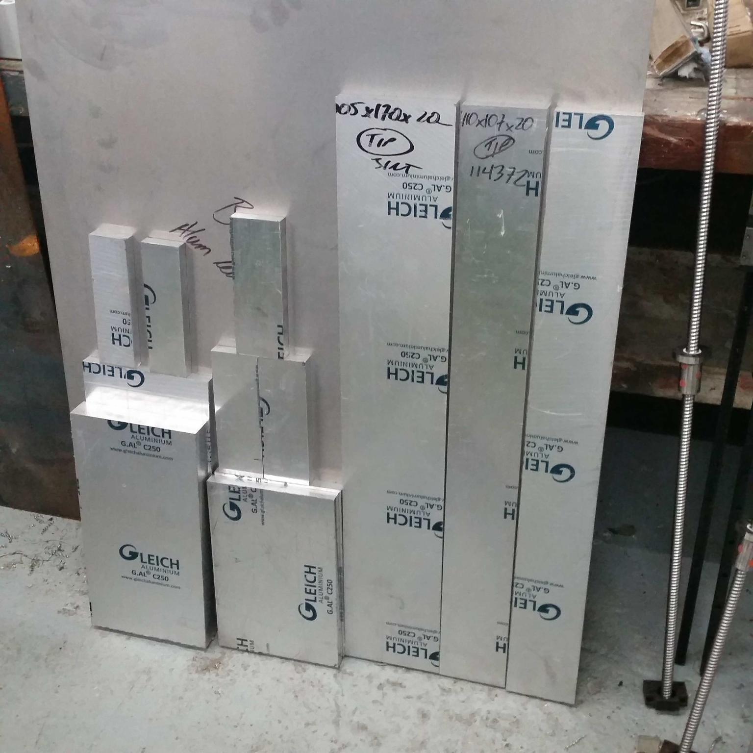

    Picked up the cut tooling plate just now....gantry build can start next week though first got to design and build a pantograph arm for putting in M6 UNC bolts and grease nipples into 1000 units we're currently assembling for a contract....oh, that's after I've finished machining a custom unit that's just been ordered. Work keeps getting in the way of playing!

    Neil...

    Been drawing up the gantry in Geomagic 3D program today. Getting there, so far all the holes etc. line up!

    Yeah its good software, we just got the Mill package that goes with it so should be able to draw parts and then mill them on the router or the next project which is CNCing the mill...
    No I can't wait to get stuck in. Taking my time making sure it can be put together etc...
