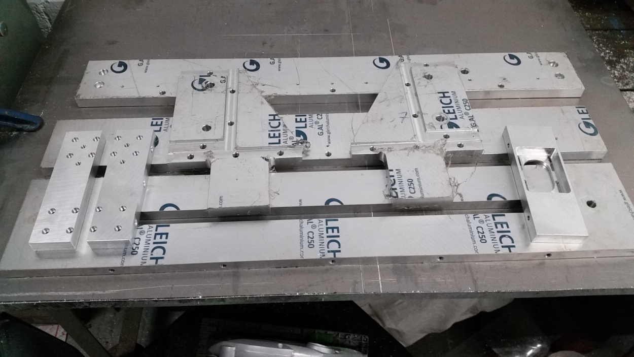

    The Z Axis plates are still to be done as are the Y carriage mounts.
    Should be able to get the second X Axis rail aligned using the gantry soon

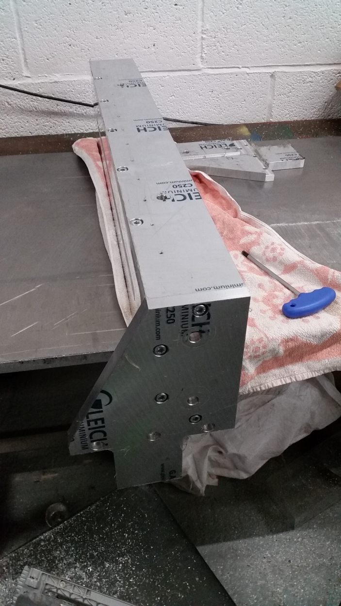

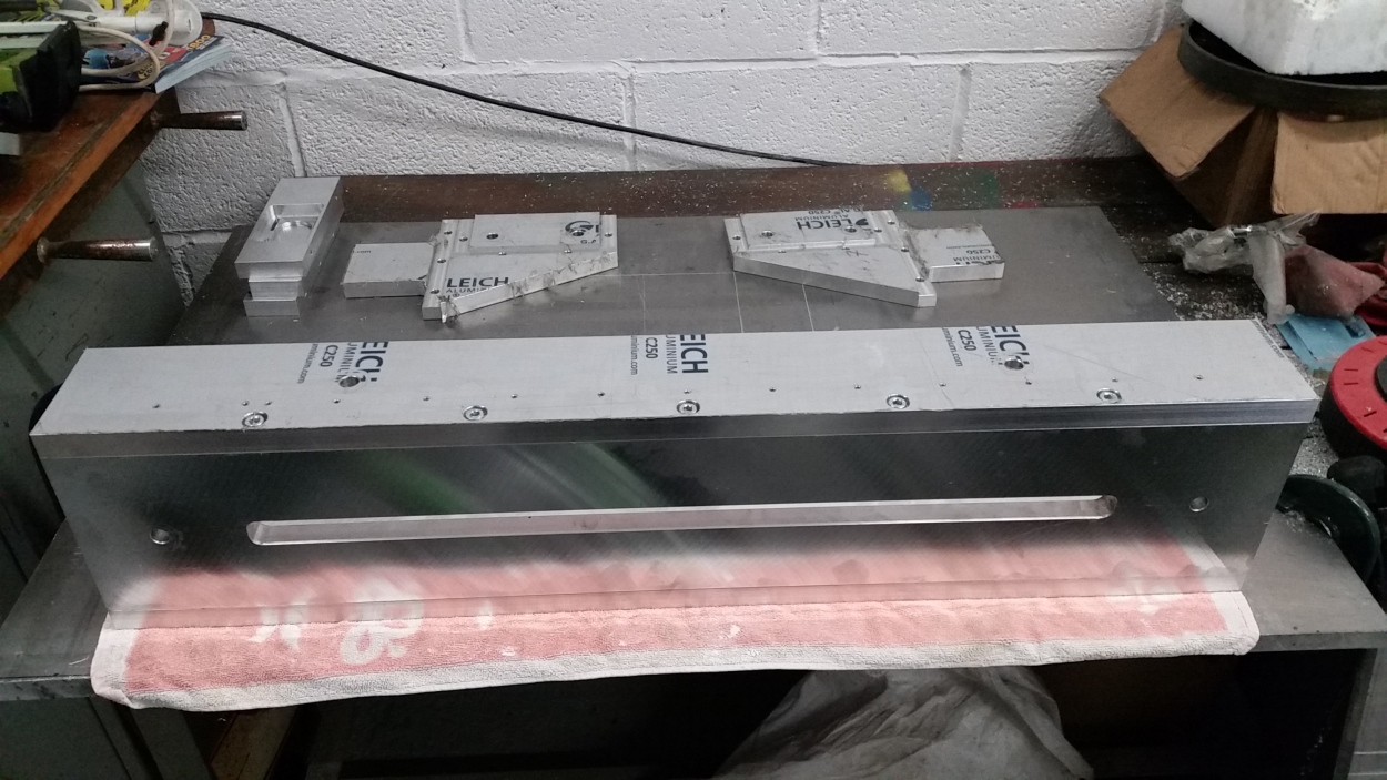

ID:	14646 Click image for larger version.
ID:	14647 Click image for larger version.
ID:	14648 Click image for larger version.
ID:	14649 Click image for larger version.
ID:	14650 Click image for larger version.
ID:	14651 Click image for larger version.
