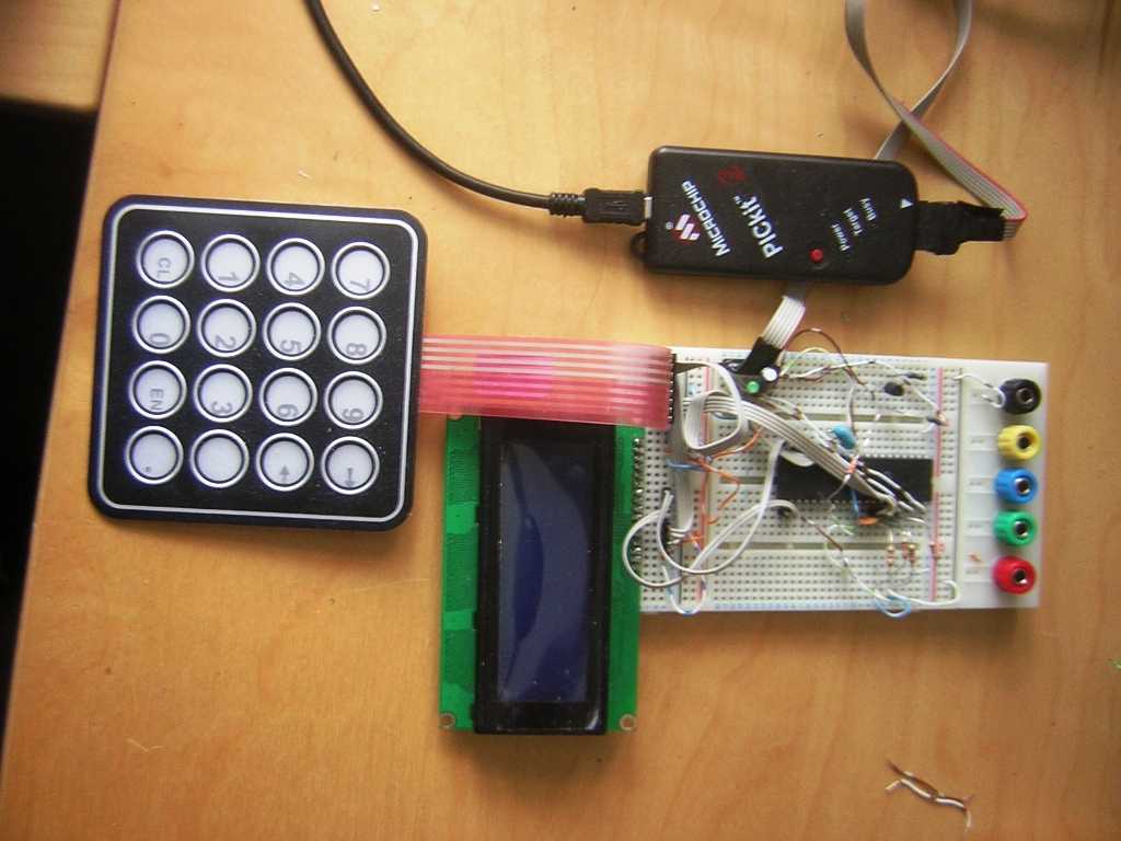

    lol don't knock stripboard, it has its place... I use plugboards now for prototyping (pic is my basic setup) but for some things where you want a copper ground plane, stripboard still works bette as a prototyping medium...

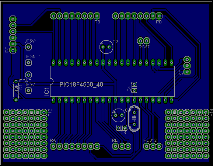

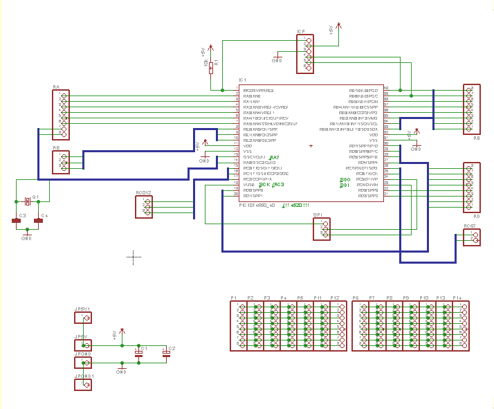

    Heh, general dev board looks a little different these days

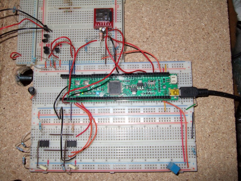

    and prototyping a little more advanced

    That's a few Dallas temperature sensors, 80MHz cpu board, 32K external RAM, 4MB external flash and a 1GB micro SD card. Add a little test software (http://forum.sparkfun.com/viewtopic.php?f=19&t=17217) and things have come a long way :)

    ecat's Eagle .brd looks good. Must investigate ...
