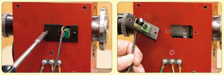

    Here's a stripdown of machine and points to where the sensor is located,theres obviously a wheel in the stock castin housin inside.

    Hi Irving, the stock minilathe sensor is hidden in the spindle housing.
    I don't like the idea of a retro-fitted slotted disk twirling around - most mounting locations make them vulnerable to clonks. Hall-effect on a gear is the most robust choice in my opinion.

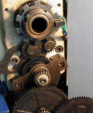

    here's idea I posted earlier...

    ... and a sensor on the fixed gears may well be easier...
    'tis the very sensor. Mounting it is a bit of a pain, currently in epoxy. Hopefully somebody who knows how it should be done will chip* in.
  5. Quote Originally Posted by Tom View Post
    hmmm, wouldnt be hard to strip headstock down and mill out a section...
  6. #36
    Tom's Avatar
    Eeek - not hard if you have a mill! :nope:
    How about epoxy gluing the allegro sensor onto the end of a modified M10 screw, and passing the wiring up the centre thro a ~5mm dia hole. Then it's just a drill and tap needed to fit, and you can make the screw on the lathe you're modifying. Might need to check clearance to the speed control PCB (locknut if there's room, loctite if there isn't).
    I'm desperately trying to avoid buying a mill! You lot are not helping! :naughty:
  7. #37
    Well if you're willing to go that far?....there's a complete opening at the bottom of the casting where it was milled out to begin with,giving you access to the gears...only takes a drilled hole then to pass the wires through to the board.
