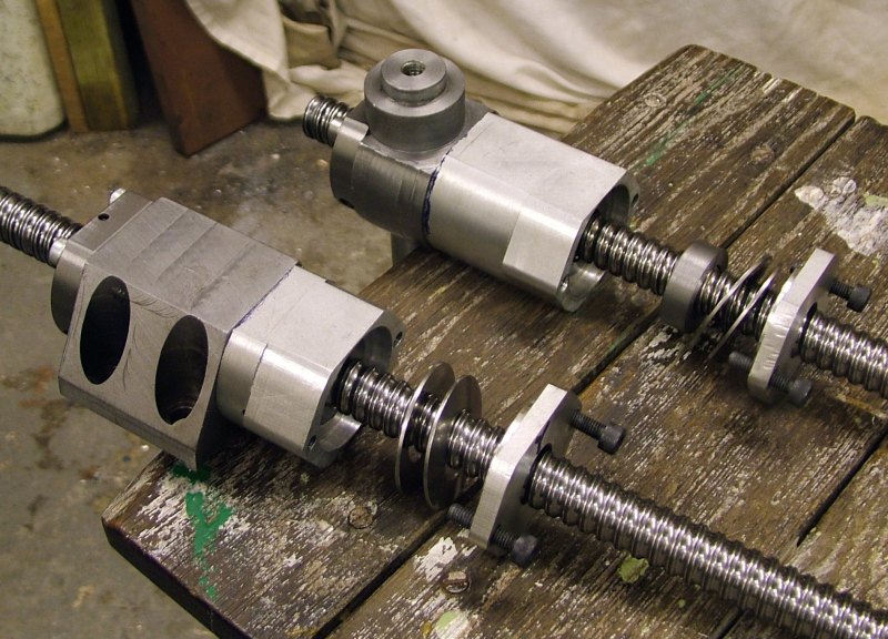

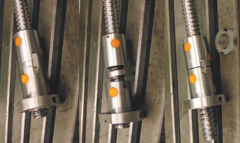

    Put two ball nuts close together on the same screw, arrange it so neither can turn but one can slide. Add springs to push them together or apart.
    I use Belleville washers and preload them to about a quarter of a ton, so I get zero backlash up to that point.
    Obviously this won't work with ordinary nuts, they'd just seize, has to be a rolling contact.
    I also spring the thrust races holding the ball screws in place. It's complicated to do but solid as a rock
    Robin
