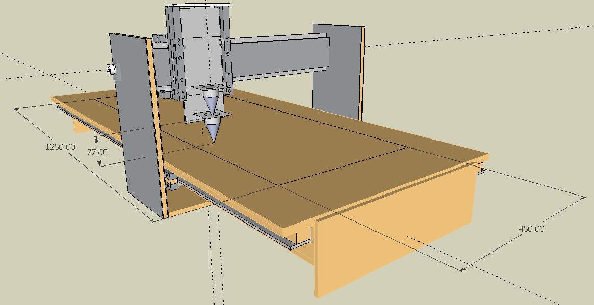

    Well, I've decided to start building the router I pictured over at CNCZone.
    Shall i build this router?

    Attached pics: (how do I get them to appear in the thread?)
    Initial sketch

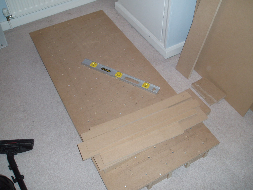

    Pile of MDF, with the base layed out dry
    Base glued and screwed, with gantry MDF cut
    Top surface of base, showing screwholes, and holes for later workholding (M8)

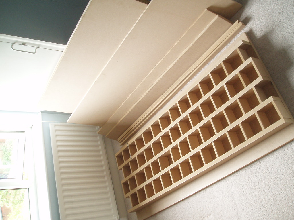

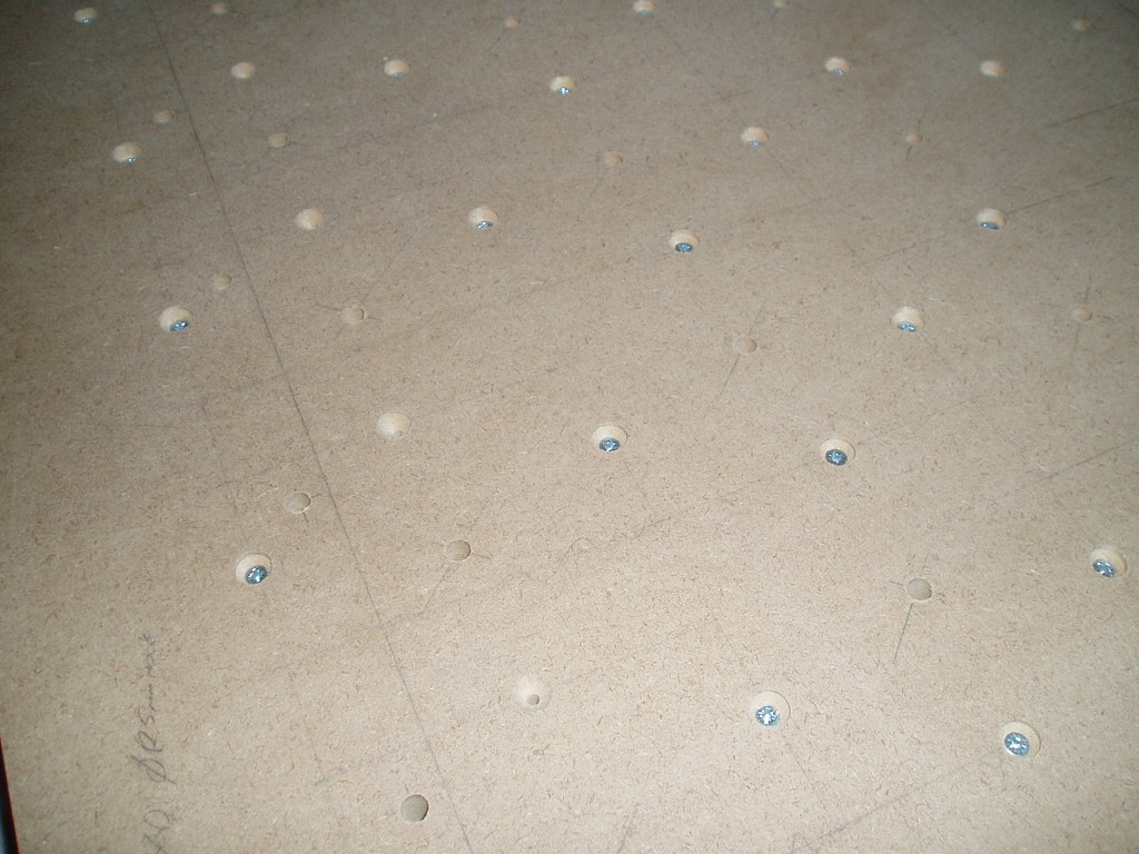

    Attached pics:
    Initial sketch
    The only changes since I made the initial sketchup sketch is I've built the base from 25mm MDF, instead of 12mm. I saw the prices at Great Barr Sawmill and decided it was worth the extra £10. GBS also do a great service of ripping the sheet up to your dimensions free of charge (within reason) using a professional table saw. I got them to cut all the base pieces out, and I've cut all the gantry pieces myself. Fantastic service, and well worth the 1.5hr round trip.
    Steel's all ordered tonight for collection tomorrow from Eggleston Bros, so I might have a weekend of pillar drilling and bit sharpening ahead of me....
    Bearings are also on the way (ordered from ebay), so all the stage 1 ordering is done.
    Just got to build it now ,,,,,,

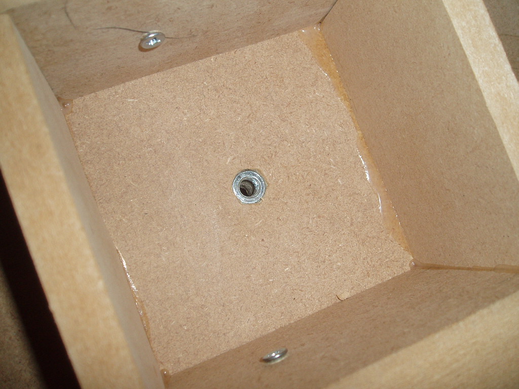

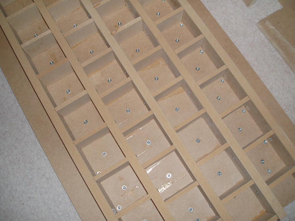

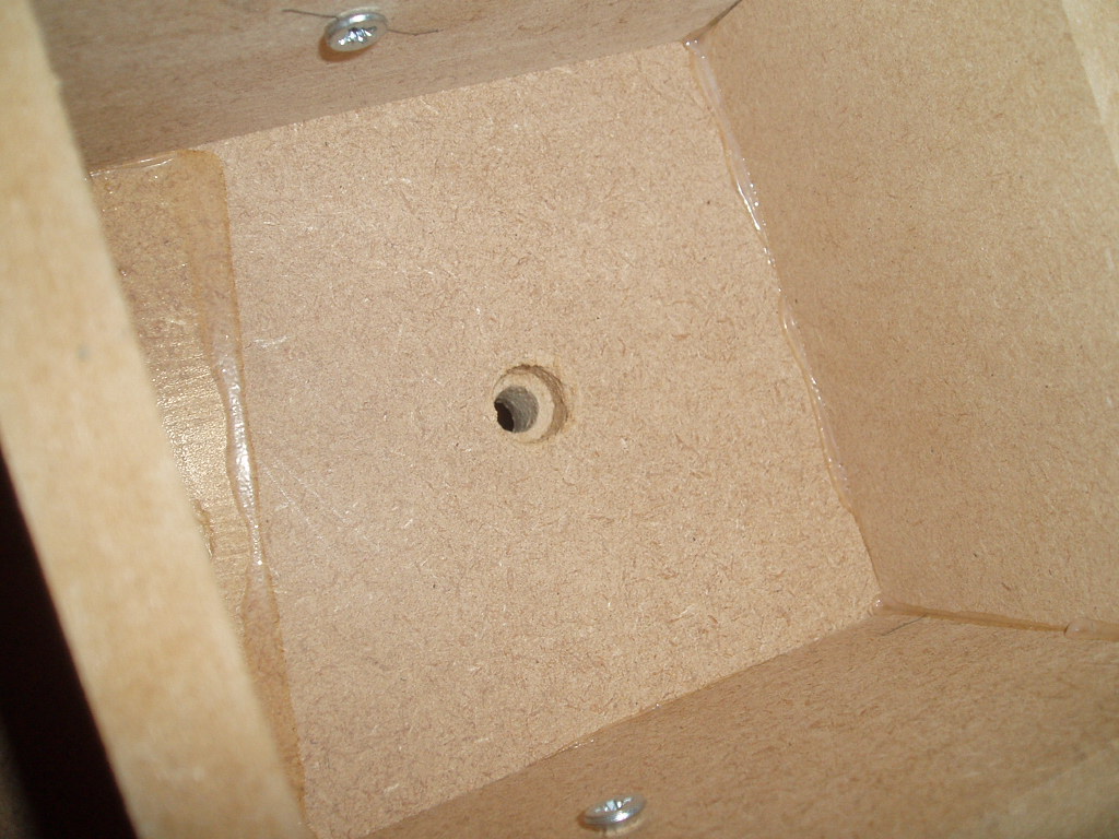

    Some progress tonight - I got the M8 nuts fitted to the inside of the router base. I thought it would be a 30minute job....
    Ho hum. 74 nuts and 2.5 hours later I've just finished!
    Pics:
    I counterbored the 8mm holes with a 12.5mm bit on the underside of the base.
    Then pulled a nut into each counterbore using a screw. M8 nuts are ~14.5mm across the diagonal, so they're staying put.
    Finished. Just need to put the underside skin on now.

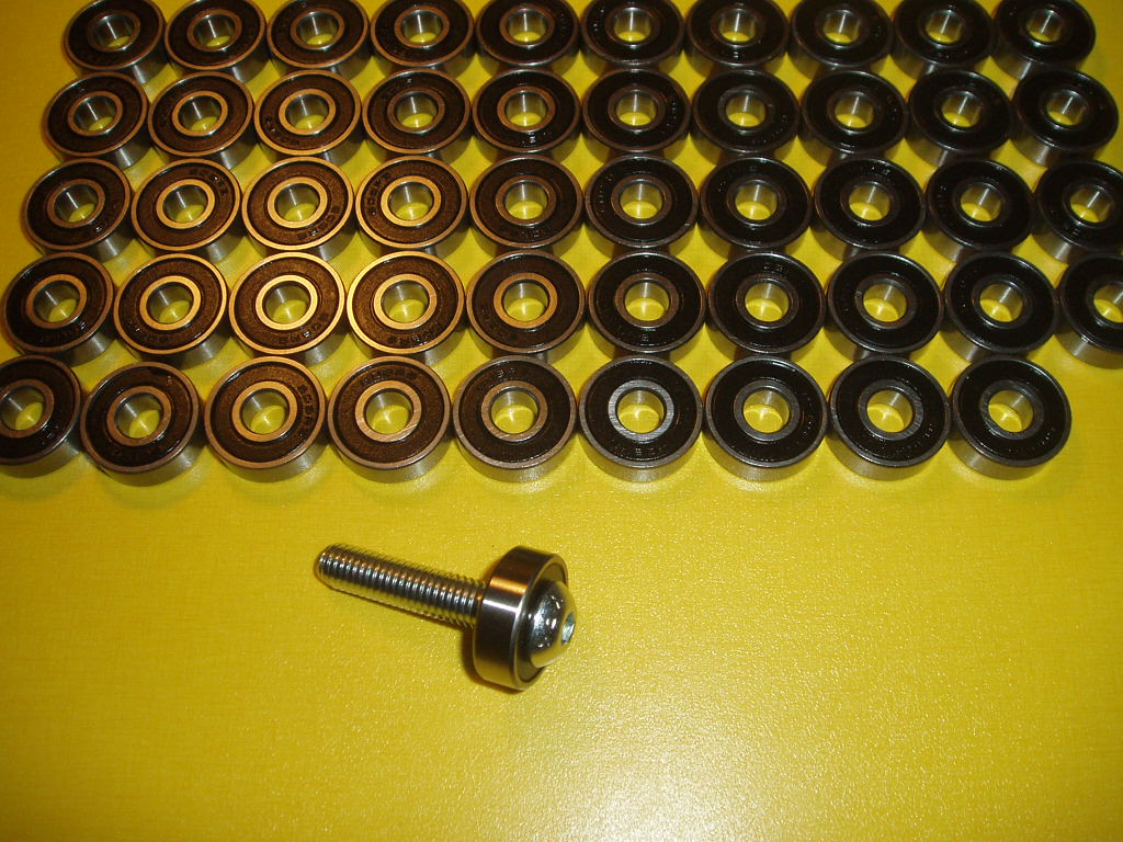

    Tom's Avatar
    My bearings arrived today. At 27p each I can't say I was surprised when they weren't packed in individual Nachi Bearing boxes, but I was pleasantly surprised by the quality. They're smooth and were bulk packed very cleanly with no grit in sight. They'll definitely do the job.....! :-)

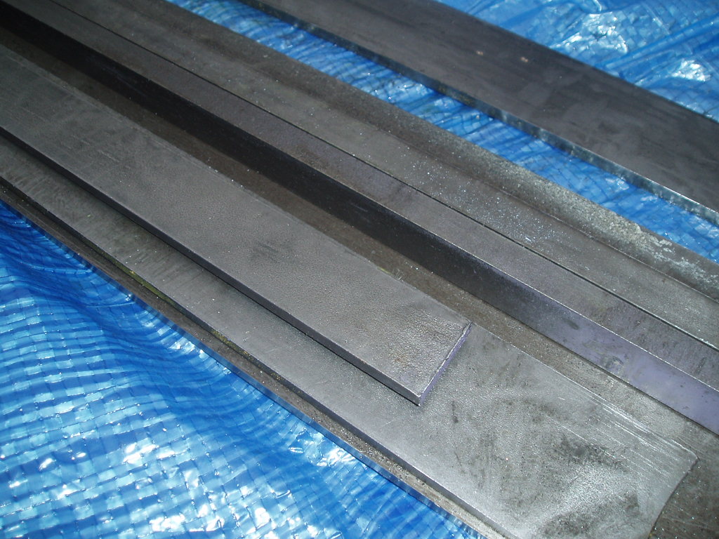

    Also collected my steel tonight. Very heavy. And about 1m longer than a VW polo.
    Hows your arms?
    Arms are recovering thanks... They need to - they've got to hacksaw this steel up into at least 29 different pieces before I can spend any more money!

    27p "don't bet your life on 'em" bearings
    Worra lorra steel (quite nice sharp corners - never worked with bright flats before)

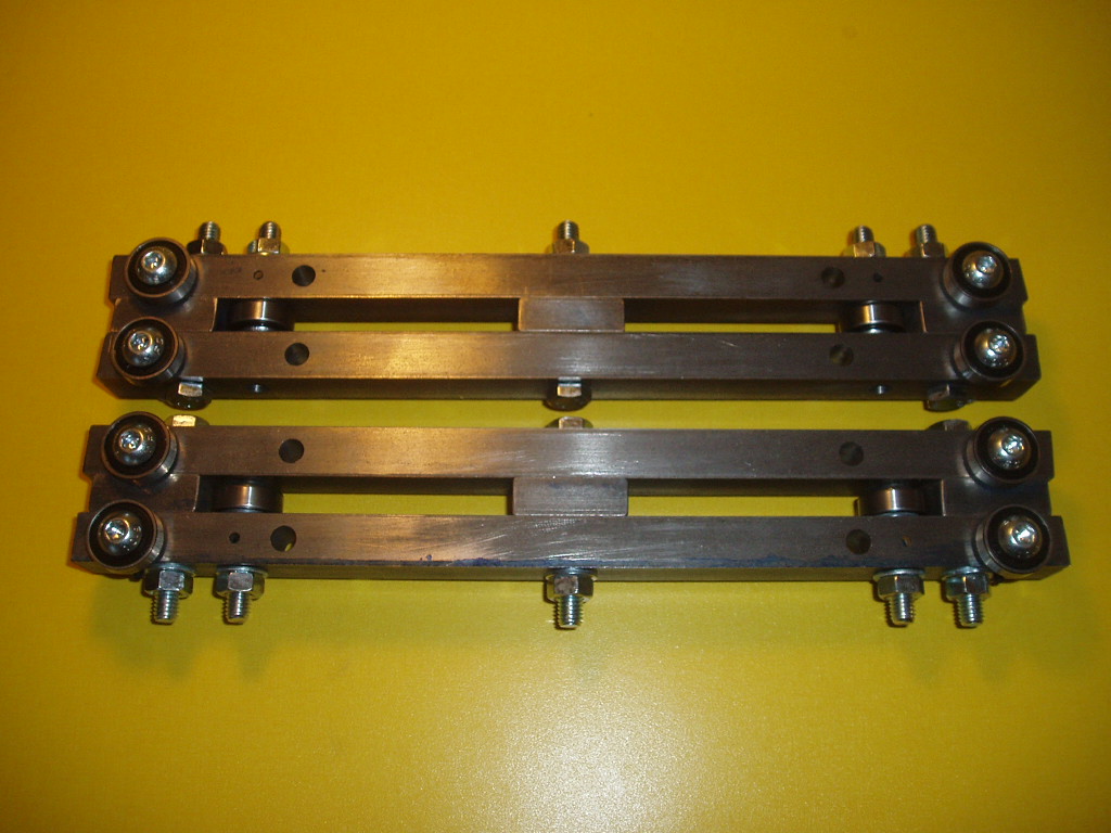

    I made the X carriages today (probably put pics up tomorrow). Funnily enough the hacksawing (5 cuts) took half an hour, and the pillar drilling took most of the rest of the day! (44 holes centred, 4mm pilot, then 8mm final size) The end result looks tidy, but blimey that's a lot of holes.

    Tom's Avatar

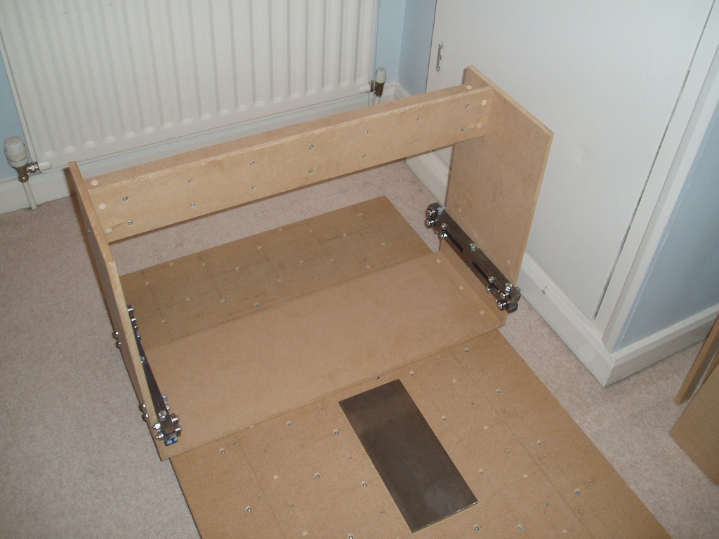

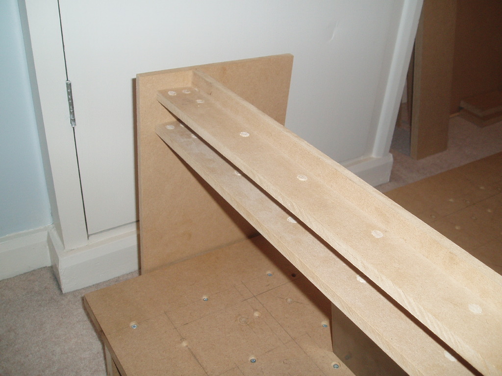

    Lots of hacksawing and hole drilling this weekend.
    Pics:
    1) Finished X carriages
    2) X carriages mounted to Y gantry
    3) Detail of rear of gantry with emergency dowels - without these the 12mm MDF was splitting, and the gantry had almost no strength.
    4) The gantry wedged under the table to see what it looks like. Z plate is propped up to get an idea too.
    The next step is to get the X rails drilled and mounted to the underside of the table. Can't wait to get the gantry rolling... I've tested the carriages on the rails already and found them smooth rolling, but sensitive to quite small pieces of debris on the rails. Hopefully having them mostly tucked out of harms way will keep them fairly clean - if not I'll add some oiled felt wipers later.
    I'm quite enjoying this! Hopefully there'll be a 2nd working router in Derby soon,,,,,
