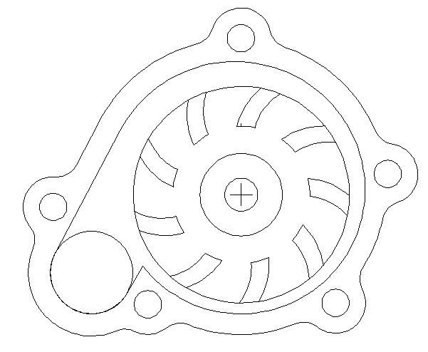

    Quote Originally Posted by CheekieMonkies View Post
    Have you got any pics of your pump
    I have the working drawing if that's any good, the pump is up at my shop.
    That's a 40mm impeller, (I just happenned to have some 40mm diam polyurethane)
    I drive it with a DC motor through a variable voltage regulator, that way I get to adjust the flow using a pot on the front of the machine. Works good :D

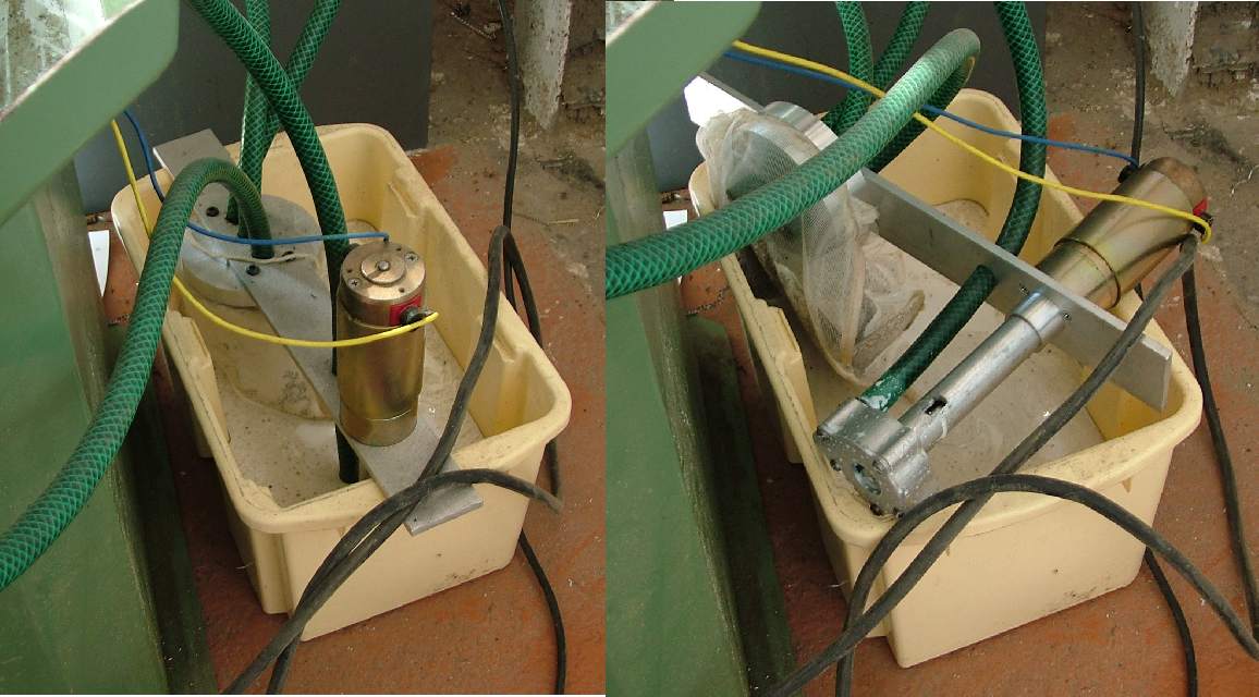

    Would be nice to see some pics if you get a chance Robin, will defo come back to this at some point.
    FWIW, a picture :D
  4. #14
    Now that looks KOOL !
