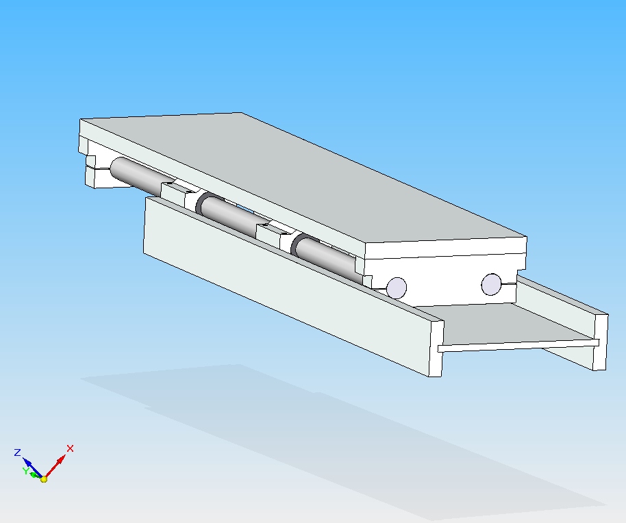

    It looks like you are using an 'I' beam for the router mounting plate. You're only considering the bending in one or possible two directions, which will give you good results on the deflection for these load cases. ...
    For such an overhang, you might want to choose RHS for the part which attaches to the router/spindle... bolting into this section should go all way through with spacers inside to get the loads into the section, rather than locally deflecting the wall. The calcs all assume good load transfer.
    Just to clarify I'm not using actual I beam, just 3 aluminium bits slotted and bolted together to make an I. I can't find RHS in the right dimensions so I guess I'd have to use a similar approach, just now with two 6mm aluminium plates instead of one. I'm concious that using RHS is going to further increase the horizontal distance from the router to the Y axis. Would it be ok to cut the front out of the RHS (to make a C shape) just where the spindle mounts. It's either that or get big enough RHS to fit the spindle inside?

    Thanks for the help. I'll have another look for what steel RHS I can get hold of and modify the drawing accordingly.

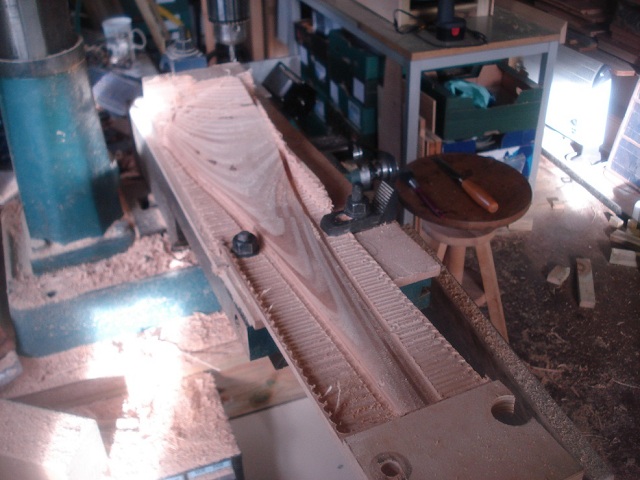

    Ash would be nice, maybe pine ... depends what I can get hold of really! Either way it's not a hard material, and anything I make which is a hard material won't be more than say 75mm tall so I think the making two of the bearings moveable and supporting in the middle is the way to go. Doing it that way would surely be sturdier than if I'd designed for 75mm in the first place - it will just take a bit longer to set up.

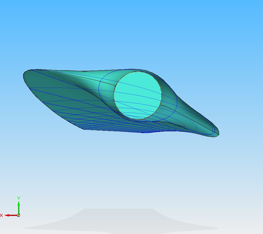

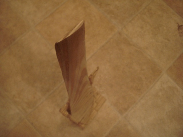

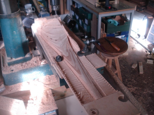

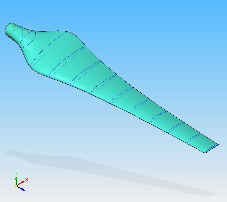

    Here's one of my blade designs. This one was optimised for less Z axis travel but as you can see it's still quite a lot. The calculations show the root at an even steeper angle, and hence need a good Z travel. I agree this blade won't need 400mm, but I really don't want to be faffing trying to squeeze the blade into the available space!

    The blade there is a 0.7m blade I made for a smaller with turbine. Plywood isn't so good...
    Do you think the 160x80x5mm box section will be sufficient?

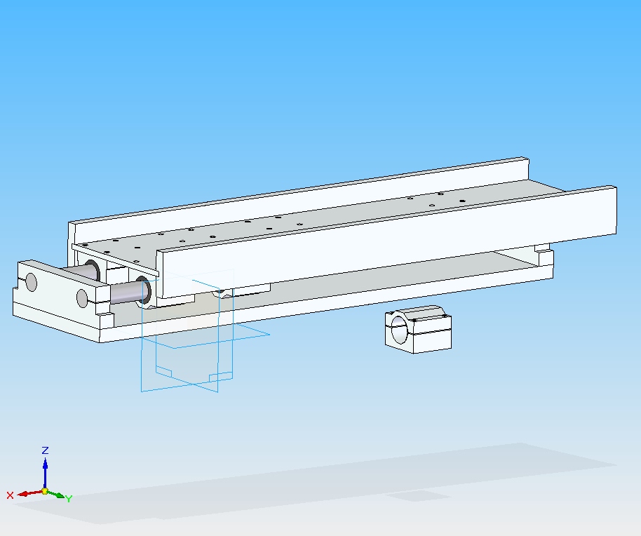

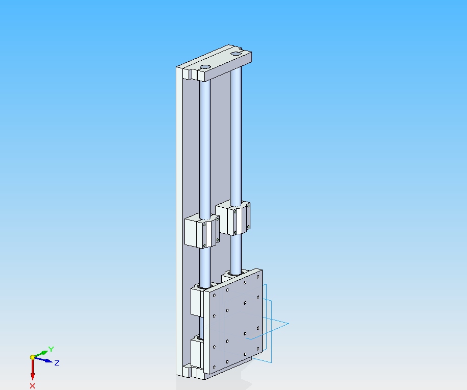

    I've edited the drawing to include holes to mount the bearings further down when I want only 75mm travel:
    The thing floating around is a support for the middle of the rail. I've designed it in two parts since that means I can fix it on without removing the bearings from the rails.
    I've not put the box section in yet. It's just occured to me that mounting the bearings to box section sturdily is going to be a lot more difficult! Would fixing the bearings to just one side be ok, or should I put a spacer inside the box section and use a long bolt?

    Having now seen it fit so well on the mill I think you would be better for off building a VMC, but optimised for wood, 400mm z axis on linear rails bolted to a column would be be no problem. The other way to deal with the large Z axis you need is to fit a 4th axis and then rotate the blade to the tool, I've seen furniture machinces work like this.

    Erm, it doesn't really fit so well on the mill. To do that 0.7m blade I had to do half of the length at a time on each side - so a total of 4 setups which is less than ideal since getting it aligned is a pain.

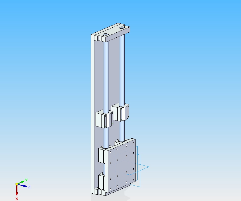

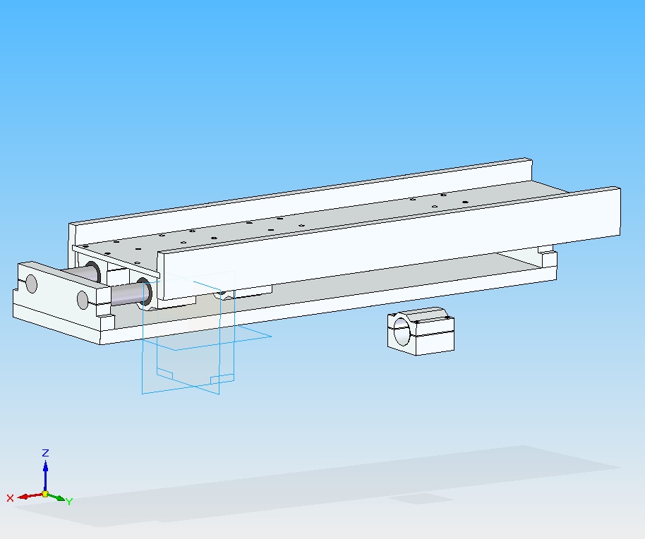

    Here's my latest plan for the Z-axis:
    I've changed it so that the rails move and the bearing are stationary. This significantly reduces the weight / cost. The supports in the middle of the rail limit the travel to 75mm, so I'd remove them when I need the full travel. I guess I'll mount the stepper motor on the top of the slide - shame about the added moving mass there.
    The aluminium plates in that drawing are 15mm. I'm thinking I could make the bigger one 20mm thick, to better resist torsion, then *if necessary* add side pieces like in the previous design.
    So, do you think I should go ahead with this design, or spend another whole day designing :lol:?

    Have you considered to make the bed rails adjustable at each corner? this way you could keep the 'Z' shorter and do the machining in stages? It would make t machine very flexible for different uses.Spacers or a wind up/ down mechanism could be done fairly easily.
