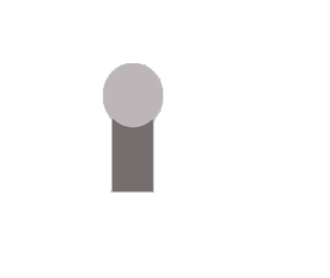

    Why does it have to be drilled?if we make a block like the pic below out of ally? fixittothe base/bed then place/clamp the rail on to this temporarily to get the precise height for the end support rail mounts.

  6. Because george, that will on provide support in one direction... when used in a Z-axis the forces are both into and away from the support...
