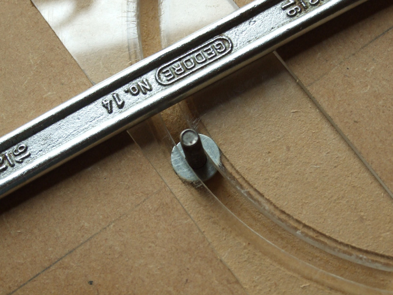

    Trying to drill a series of 3 or 4 holes in a spanner shaft without any joy
    The spanner is dropped forge steel and the HSS bits have just about scratched the sufacelol
    Any ideas to get me out of a pickle?
    This spanner is pemanently located under my router table in a manner it will be withdrawn from the collet nut and fed onto the nut when needed but I need to cut/drill a cutout in the shaft for it to go on the arc slide here.....

    A carbide bit will drill through a file if you don't mind a few red hot sparks, or you could draw the temper or you could weld a tab on the side then drill that.
    Nice one Robin,think thats the most easiest option as I don't have carbide bit.
    Just use a masonry drill. plenty of pressure when done bin it.
