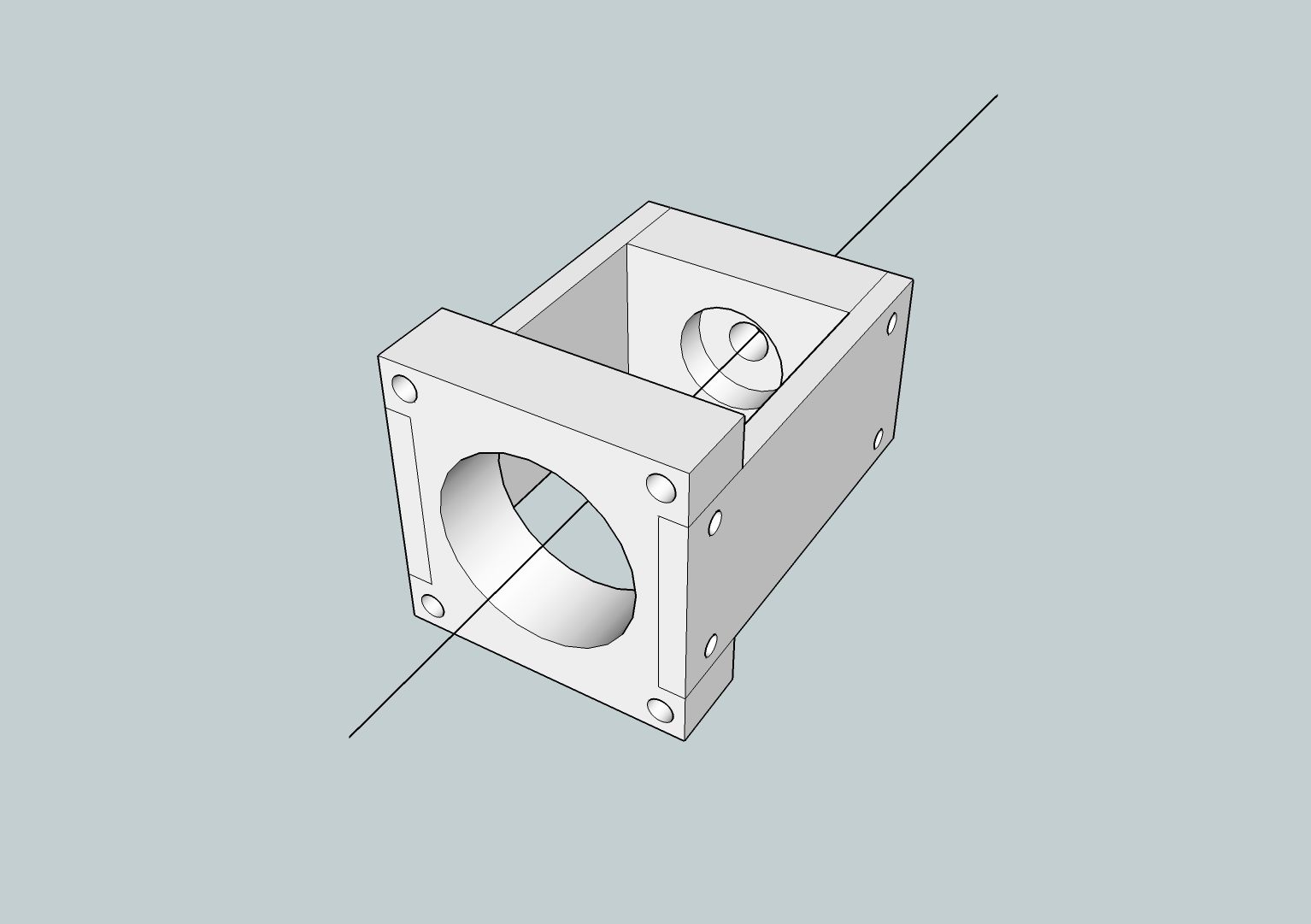

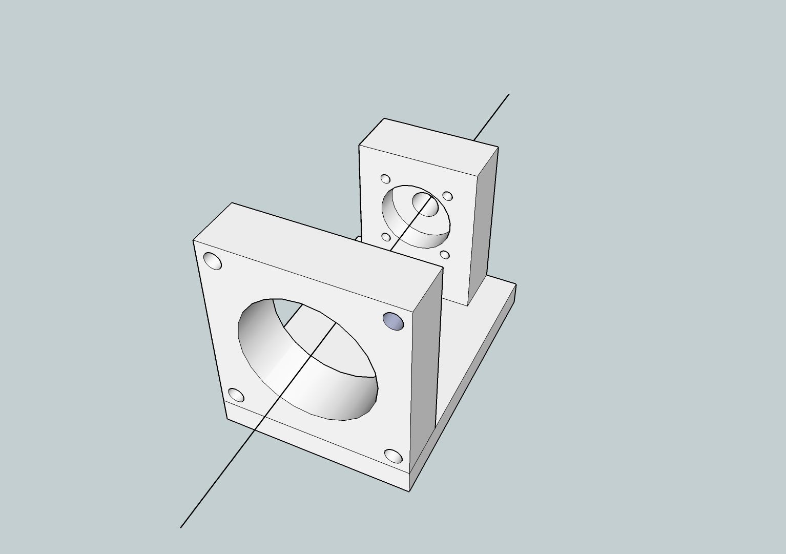

  3. Been playing around with Google sketchup and trying to decide whats the best design for a motor mount that:
    • Supports a NEMA23 motor
    • uses a 8 x 22 x 7 ballrace and two 8 x 16 x 5 thrust races (these go either side of the ballrace mount
    • a 6.35mm - 8mm motor coupler (the ones Lee sold me, whatever they are)
    • 10x2 or 12x3 leadscrew turned down to 8mm for 50mm and threaded M8 for the last 25mm of that.
    The second is slightly harder to make but is more compact and rigid I think...

    I have to admit that making motor mounts is very annoying, so I can appreciate what you've been doing (and it looks great)! I hadn't thought of using sticky-backed paper though (what I did was to drill the centre hole, clamp it to the motor in place, and then mark the drill holes).
    When I come to fit the other ballscrew to my machine, I'm cheating, I'm afraid - the guy whose workshop it's built in gets a lot of parts laser cut, so the new ones (and also ones to replace the existing mounts, since they're being relocated) will be laser cut from 6mm steel (although the plates will be tapped and welded in place). It comes to just under £2 per plate.
    irving - the second would be better, although I'm not sure I'd recess the plates either side of the motor mount (but would look nicer).
