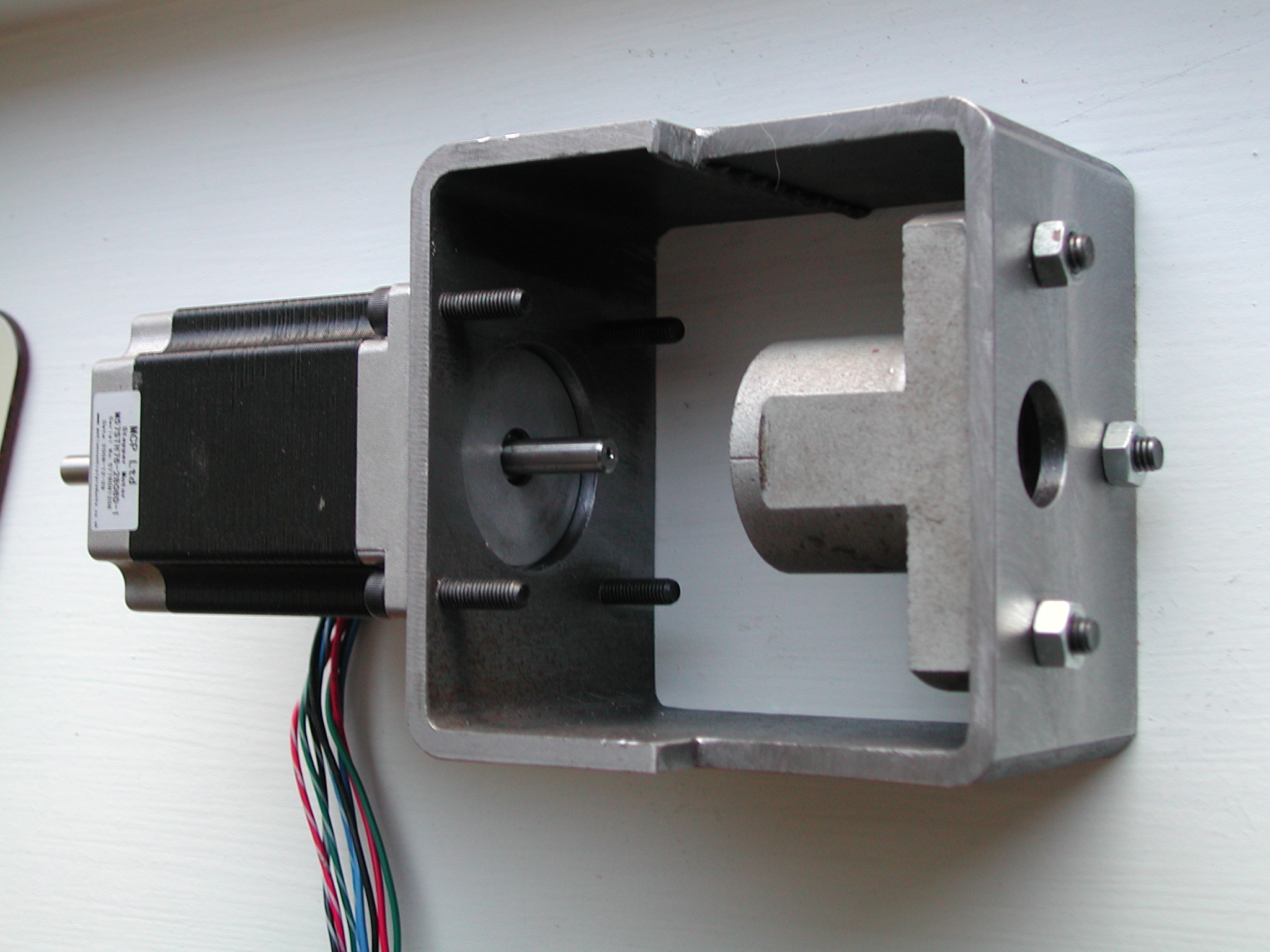

    I have just about finished retro fitting a mill.
    I found the easiest way to make a mount was to use 100mm box section.
    It had 4mm walls so was very rigid and thick enough to tap M5 threads directly into it. Just needed facing on 2 sides.
    The below is from the Y axis, the nuts and bolts are not the finished ones, just to test alignment.

  6. Quote Originally Posted by melee View Post
    regards
    Melee
    Now that is a neat bit of lateral thinking, wish I'd thought of it! Since I am machining up the ballrace mount and not using a ready made one it woudn't reduce the amount of work for me significantly but for someone with limited tooling thats an easy way to go.
