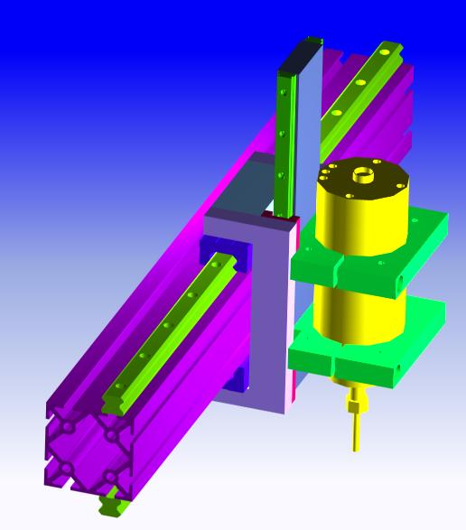

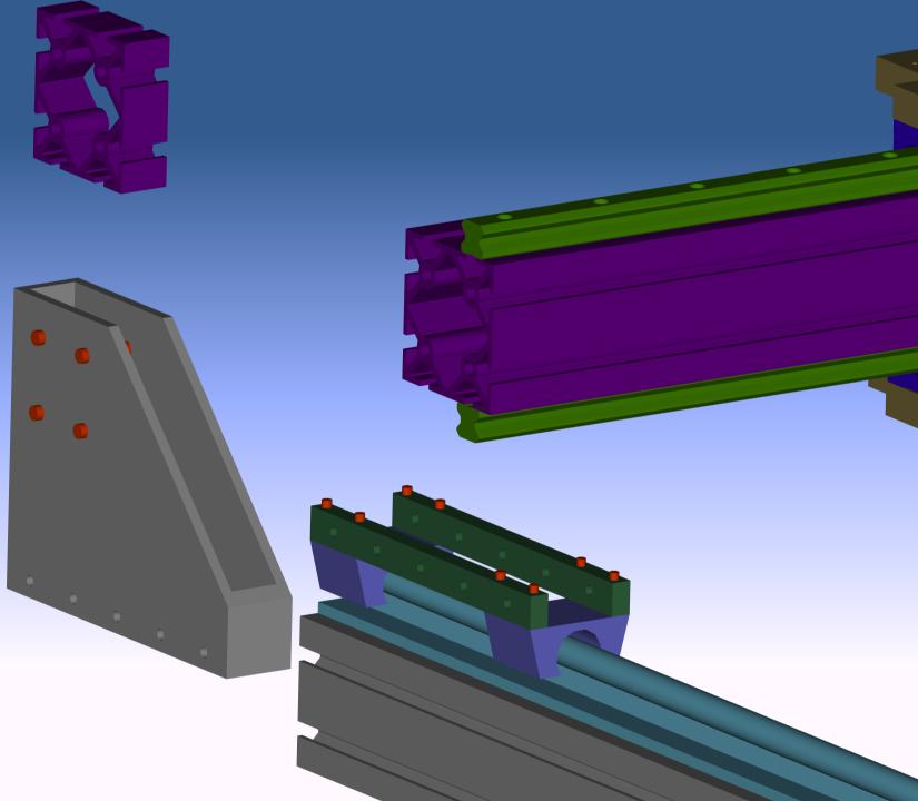

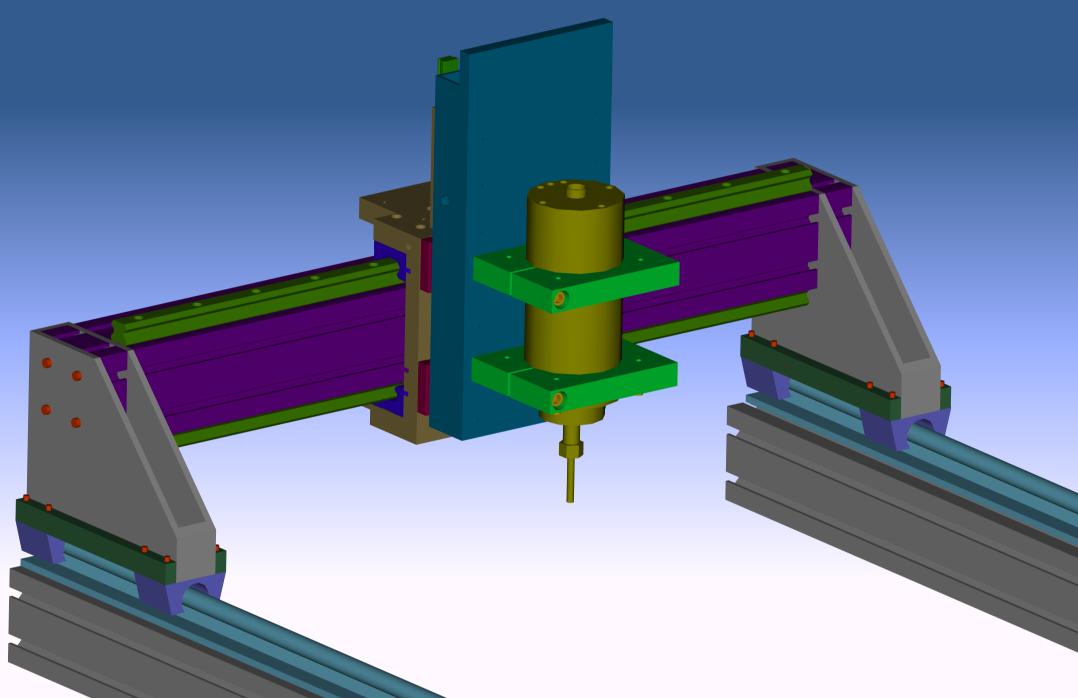

    Wow' thanks for the drawings! That looks like a good way of going about things - much less expensive aluminium plate which is a bonus.
    I've been trying to get the rails to fit on 3"x1" angle mounted too the plate...but it's just generally not working. I'll post more when I've got a drawing done.
    I'd also been playing around with a few ideas recently. Some of them are very similar to yours Ross!
    First off, tried to get Z axis as close to gantry as possible (using profile rail, which I'm fortunate to have) and came up with the scheme below (LH image).
    Also, playing with gantry sides idea using RHS, with an offcut from the gantry as a spacer to get the loads well into the RHS and avoid just locally distorting the wall (centre and RH image). Lower joint down to the X bearing is always an area for many ideas - thought using these bars each side were a bit neater than the usual double back to back plate arrangement.
    Option of TIG-ing a closer plate over the sloping part of the RHS, but probably not worth the effort.
    p.s. Looked at some of the steel box and RHS in the stores, and the ERW stuff would need grinding. The sides tend to cave in slightly relative to the corners.

    I like the idea of rhs with the spacer, nice and neat, you could probably get away with just gluing a closer stip over the angle to keep dirt and chips out.
    Where would the ball screws go on the first one? with those rails could you wrap the carridge around the beam and mount the srews and motors on the back or would the leverage be all wrong? not pull ing from the centroid etc...
    I guess there are no new designs its all been done before and when you start leaning out or designing close to the wire you end up at the same point any way. I'm sure I ve seen elements of my design else where and thought if i just change that a bit and move that over there it will work how i want it too.

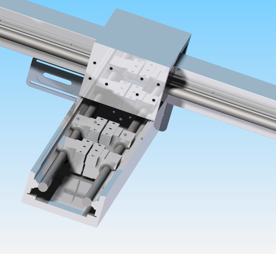

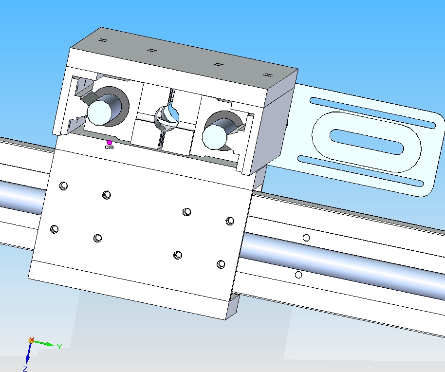

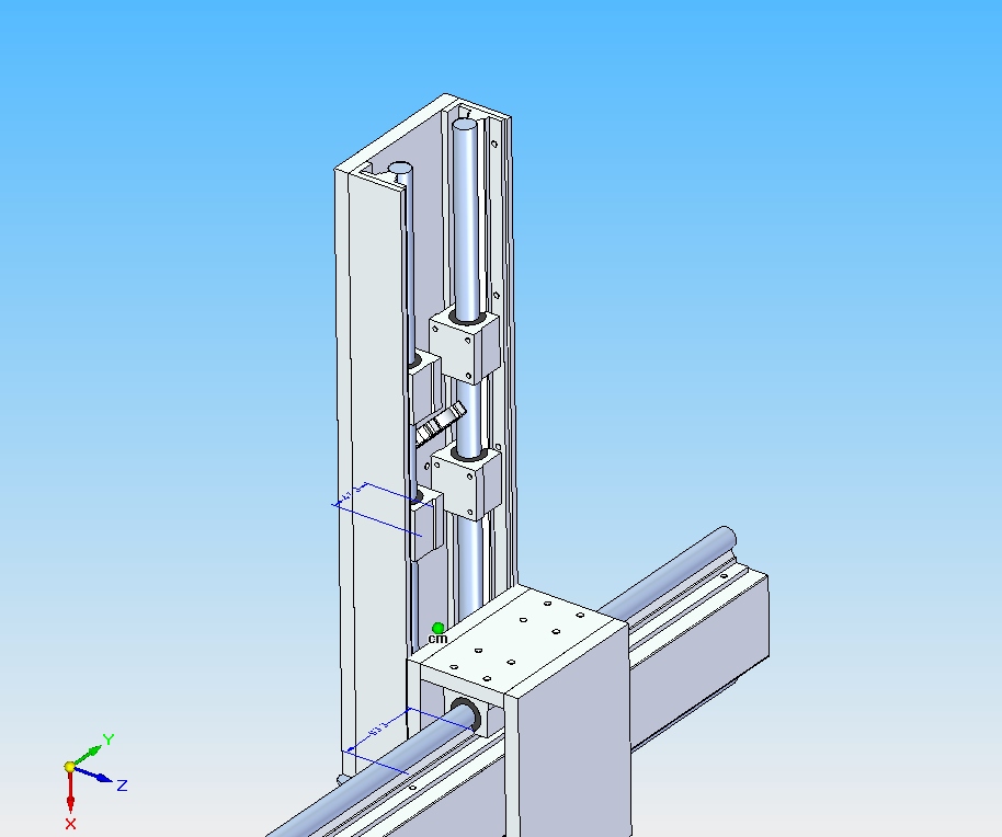

    Well, I tried 'borrowing' your design Ross but couldn't get it narrow enough for my requirements. Great ideas though.
    This is what I ended up with:
    Here's my current design. Just trying to work out how to fix the 4 blocks to the aluminium plate that slides on the Y axis. There's not much room and it's made more difficult because the bolts thread into the bearing blocks...I don't really want to start drilling those out.
    One plus of having the Z rails this way round is that that aluminium angle will stiffen up the 20mm aluminium plate significantly. Maybe I can replace the 600x160x20mm plate with 15mm to save a few ££'s?

  5. #15

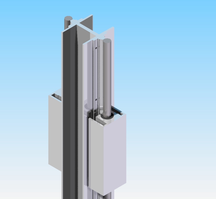

    Right, hopefully this will be the final final design!:
    I've rendered it with the Y axis off the blocks on the Z as otherwise you wouldn't see much.
    Have I done anything silly...does it look OK?
    The mass of all that is 25.9Kg, that's not including the stepper motor, screws, bearings and spindle.
  6. #16
    Some good development and ideas, but where were you thinking of putting the Z axis leadscrew? Looks like there's no space now.
    I wonder if you just turned the Z axis rails through 90deg and mounted the support rail onto the router plate, and mounted the blocks back onto the main Y axis carriage, you would be better off. Stiffness wise it must be similar, and you are no further away in terms of spacing from the gantry than the above dwg (judging by the dwg above). You could even include the angle pieces in there as well if you want.
