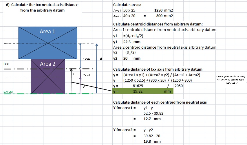

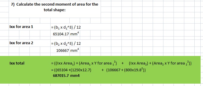

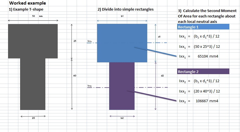

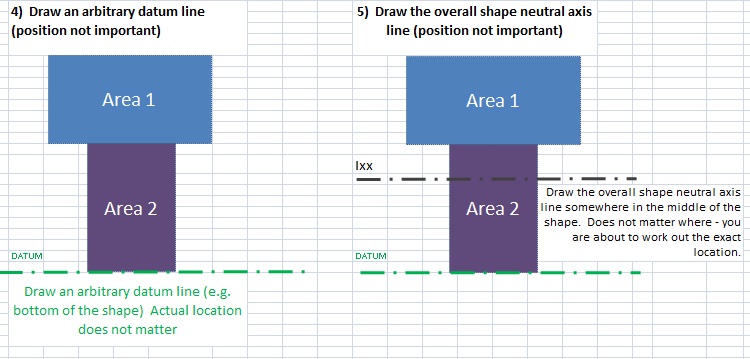

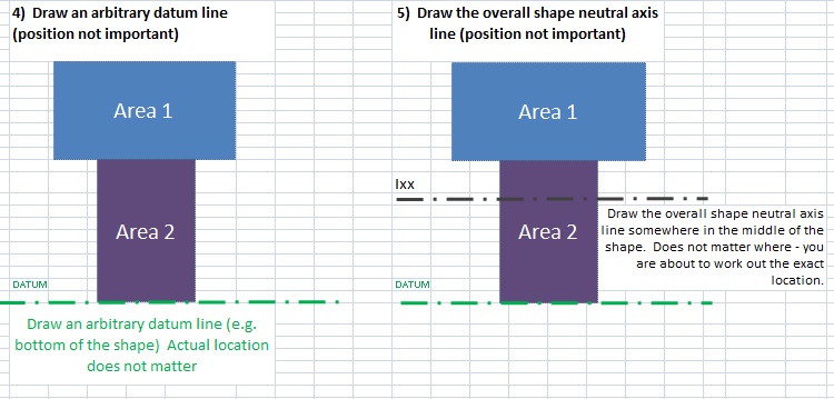

    That's quite a handy calculator, so it might be all you need.
    But if you want to know what it is doing, there are quite a few steps involved (which is why you are better making a spreadsheet if you want to do lots of them). I've shown a worked example which uses 2 rectangles in a T shape. You can make any shape using more rectangles but need to include more terms in each equation associated with each new rectangle.
    The T shape is worked through in 7 steps:

    Hope this helps.
