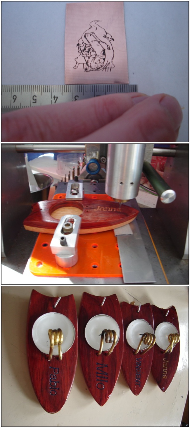

    Engraving
    • Building trajectory according to the cutter's shape
    • Defining different cutter's shapes

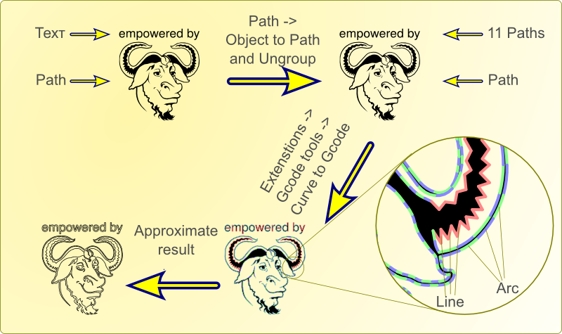

    Plotter cutting
    • Export to Gcode for plotter with tangential knife. Forth axis A is knife's rotation.

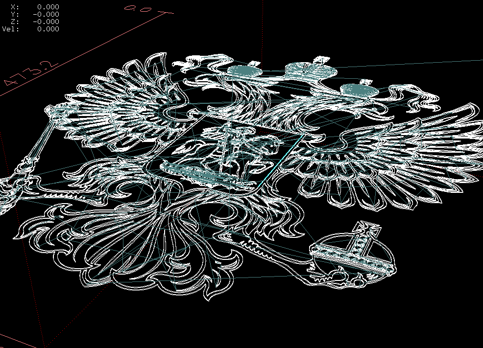

    PS We need more photos of work made using Gcodetools if you can do it I'll be glad to publish it. Unfortunately I can not do it myself because my hobby cnc is not finished yet.
    Here are some screenshots and made things...

ID:	2840Click image for larger version.
Name:	0092 Gcode tools Russian coat of arms.png
ID:	2841Click image for larger version.
Name:	0082 gcode tools engraving.jpg

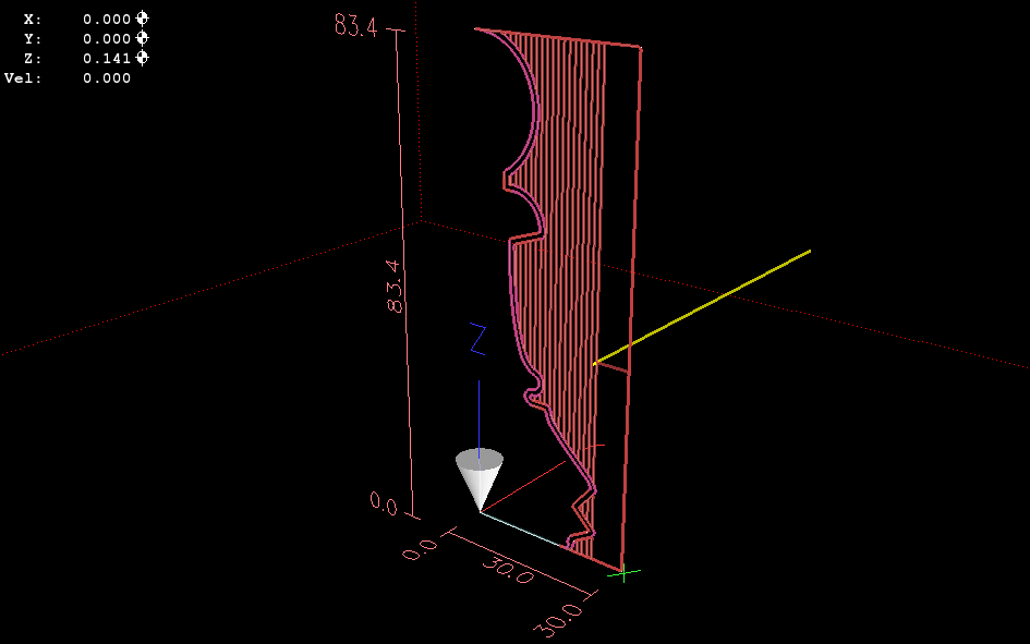

ID:	2842Click image for larger version.
Name:	0089 gcode tools lathe emc screenshot.png
