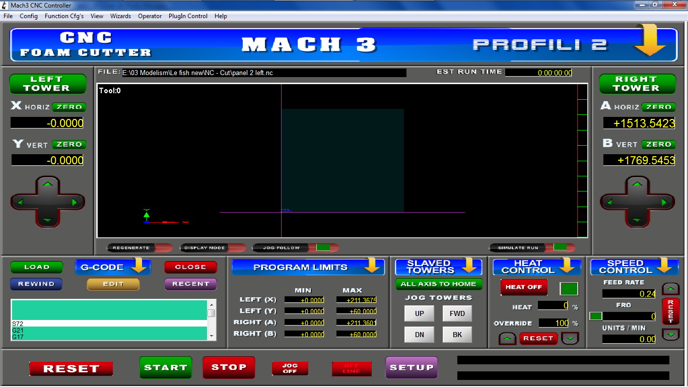

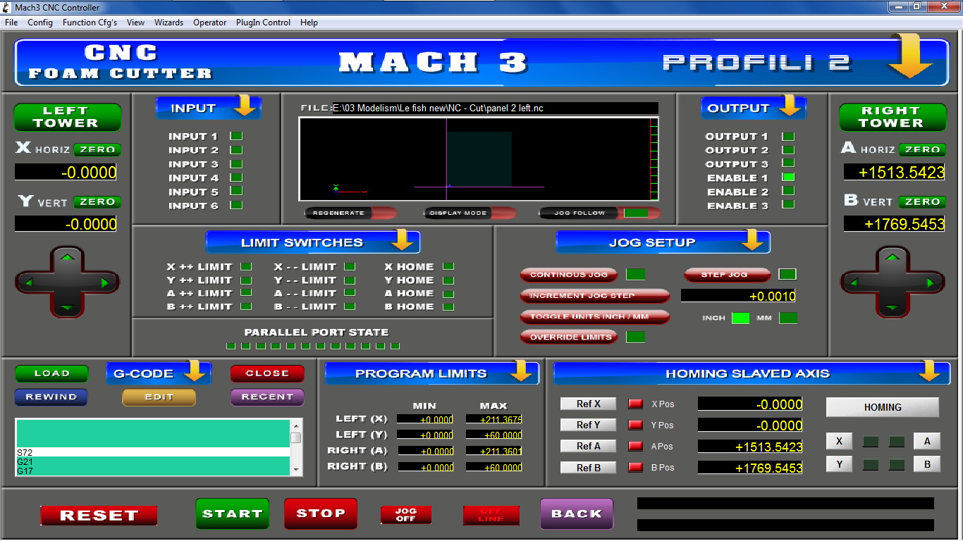

    hello gentlemen.
    starting from the screen is Sam, I made some changes. Normally, with the consent of Sam.
    I will keep you and other changes. I hope it will be helpful.
    with friendship,
    Allen

    Allen,
    Nice work on the screen. I would be interested in getting your profile xml file to understand the underlying hardware settings.
    Are you using any macros or brains to control the functions or is it all standard stuff inside Mach3? If you are using macros and brians would you be willing to share?
    I have my own machine that I've been working on for some time now and getting both towers to move at the same time in jog mode is something I have not been able to figure out.
    Any help would really be appreciated.
    Jim

    https://www.dropbox.com/s/f8iyaulvhg...Mach3.rar?dl=0
    XML file. all function is inside Mach3.
    I never went very deep in settings Mach3 but, as we have done all settings, the machinery works well in both 2D cutting (letters, logos) but also in semi 3D (model airplane wings, cones, pyramids)

  10. #18
    Quote Originally Posted by n257jybelo View Post
    Jim are the towers working as independant axis like seen on high end hotwire cutters or are they slaved as one axis.? Should Jog without issues if slaved but if independant then gets more tricky and some coding will be needed. Could possibly do it with brain but would need some testing.
  11. #19
    JAZZCNC,
    The axes are independent (X,Y,A,B). I left Z for a rotating platform to do some funky shapes in the future (but I get ahead of myself :-) )
    I have it running under G code control, but it is a real pain to get the wire close to the starting point of the cut when you cannot move the towers in parallel:) I've been trying to do with brains (mine and the MACH3- not sure who's winning yet:-) ), but cannot seem to find the right codes to use to make things happen. I have found no good info on what specifically each of the DRO, Button, etc. codes can do...
