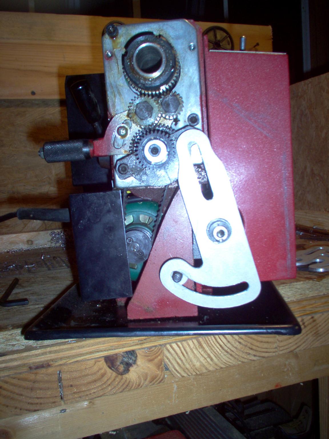

    already i got the materials for tailstock... but my little lathe crossed my imaginations...
    the first issue was the gears... for feed and thread cutting... when i tried to change gears, i discovered theres no 127... the reason lack of room for...
    getting on the net i find a few website about this nifty machinery... they talking about the 21 teethed gear
    so first looked for the whole problem what can be done on simple way...
    on the first picture you can see the original part, made of 3.5 mm hotrolled sheetmetal...
    you can see the design ""ignored"" the necessity for gears and modified to the available room for...
    so first i cutted a testpart, which one worked better...
    some more study on this, and find out the part has more room on the front... new design, and it is close what i would like...
    next issue was the gear...
    the inch-mm require the 127/120 ratio... even i moved the part to the front, still the room is not enough for... (due to the maximal teethnumber can be applied)
    the first test of this was a 51 teeth gear... actually it would require about 0.8 mm dia endmill, but i had only 1.23 dia... so toothroot has a little undercut, but it doesnt reach the main circle..
    127/120= 1.0583 the necessary
    21/20=1.05 error 0.0083
    51/48=1.0625 error 0.0042
    might be next week i will get from ebay the right endmill.. already ordered, just it takes time...

    the next issue is the rest... some website sells for, but originally i purchased from harborfreight, and they don't have this time...
    so i gave a try on this weekend for...
    it is made 1 inch thick aluminum billet.. first i cutted a paper template, which one not really worked.. so i just measured the tailstock..
    after dimensions were in hand, i drew it up in cad, andd cutted contur on the router, and slots were made on my mini miill.. a rongfu 45, 29x9inch tablesize...
    it is openable what like really, because the saddle can be leaven on its position and the jaws also not necessary to release...
    it is not ready yet, might be next weekend i have time for again...
    and some picture about the gear i tried... the steelgear is original with the lathe..
    i checked the dimension, on five teeth, but i could compare only with the caddrawing... i can't calculate involute a...
    thank you
