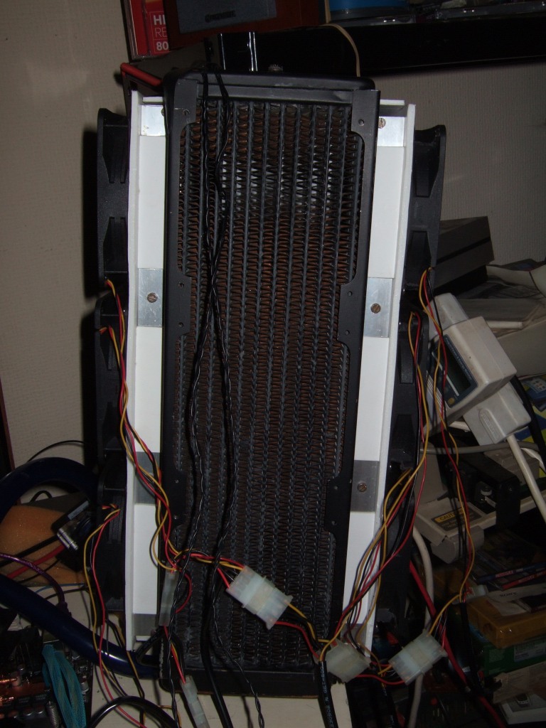

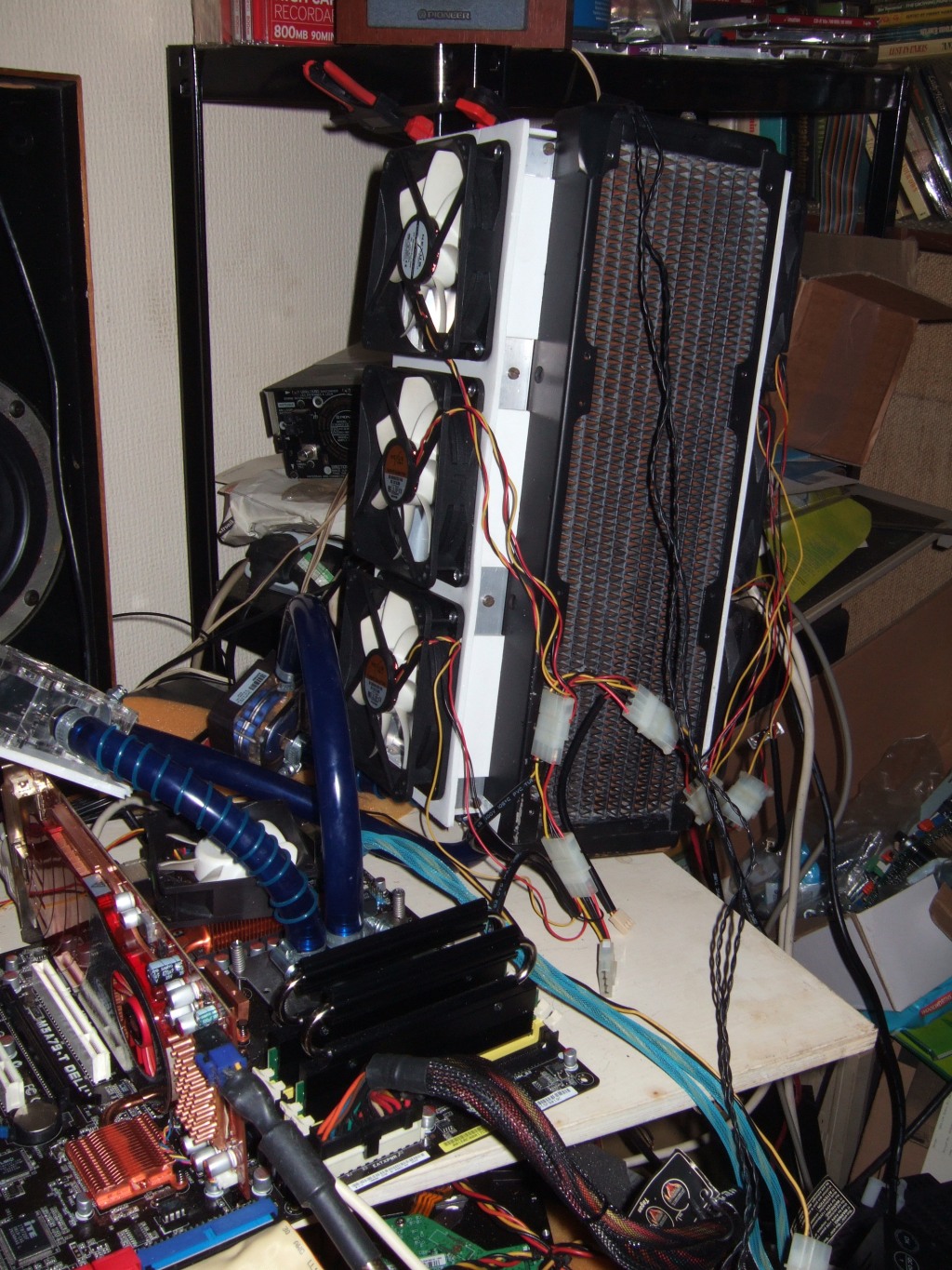

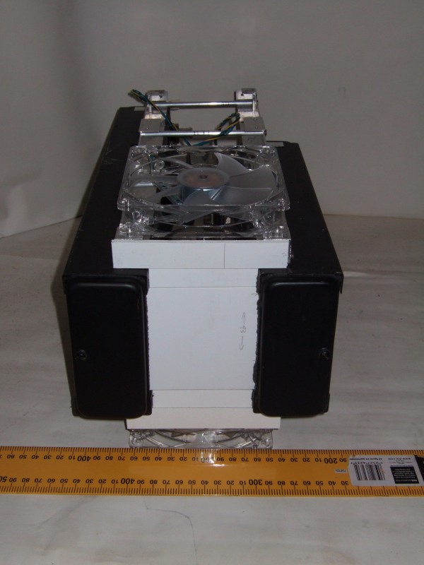

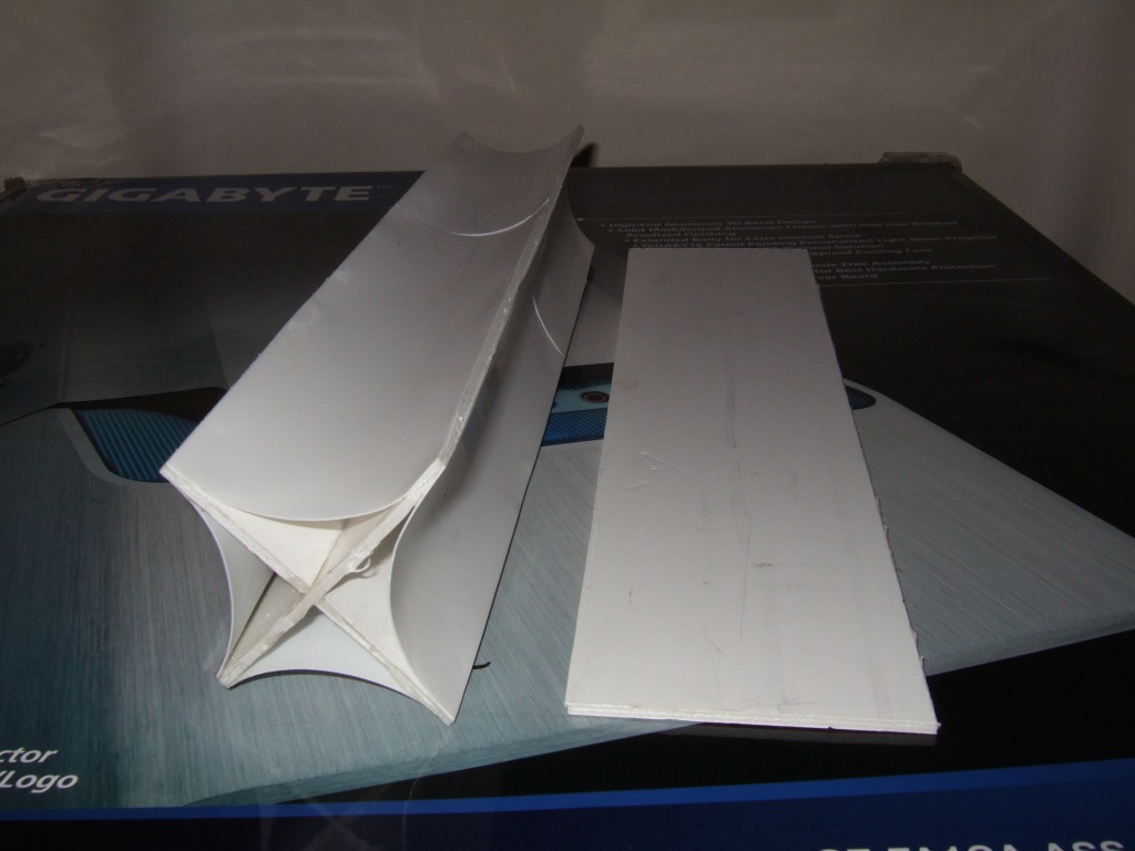

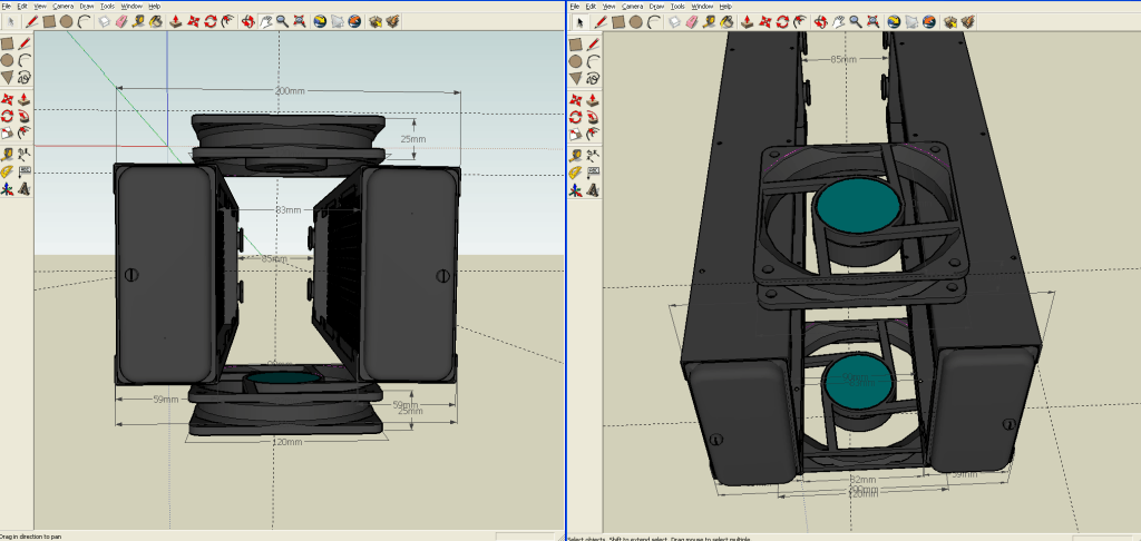

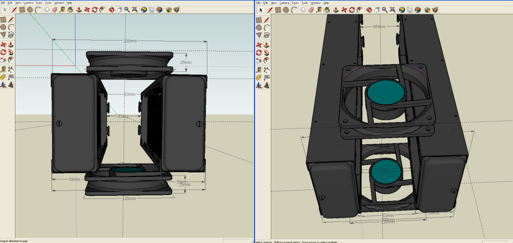

    Heh, found this, my design for a compact 6 fan cooler...
ID:	2883Click image for larger version.
ID:	2884Click image for larger version.
ID:	2885Click image for larger version.
ID:	2886Click image for larger version.
    ... you lose about 10% fan speed irc due to the fans fighting each other, the baffle didn't help at all. I'll have to get a case for this PC some day.
