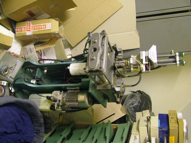

    I started making an injection moulder because I didn't have room for the real thing in the garage. Then I suddenly got space and bought an old 25 ton Arburg, haven't plumbed it in to the 3 phase yet.
    The point being, I have most of a home brew, fully automatic injection moulder about 6 feet behind me. All hydraulic, opens closes, ejects, injects from a hot pot a la Travin, measures plastic in, heaters all wired up with a digital thermostat, plugs in to a paralell port for all the critical timings etc.
    I don't really want to sell it, but I can be arsed to finish it. If you are interested I am sure we can come to some arrangement :naughty:

    That's proper hard core there Robin - I'm only after making a bobbin 50mm long! (the words crack, hammer & nut a bouncing around my head). A lovely looking machine though (every garage should have one)...but alas, everything I buy has to go into my workshop in the loft (this is London & not many have workshops!) - so anything/everything I buy has to go through a loft hatch!
    Re the book ...thanks for the offer, but I'd probably buy something rather than make something - I don't trust myself to build a proper injection moulding machine - anthing over what my car foot pump produces (pressure wise) & I start trembling & having palputations.

    Some work gone into that robin,did you ever finish it? or did you move it on?ive been slowly gathering the parts to knock one up.
    Quote Originally Posted by deisel View Post
    Finish what? The home brew? Just gathering dust. You could have that really cheap but you'd have to collect it and I'd want to keep the pump
