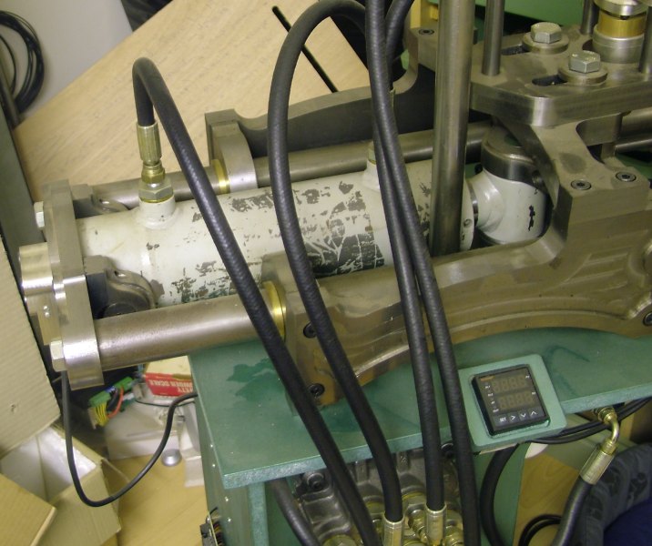

    I have a book telling how to make a really crummy lever operated press you could knock up in a couple of days. I can find it if you're interested.
    That's proper hard core there Robin - I'm only after making a bobbin 50mm long! (the words crack, hammer & nut a bouncing around my head). A lovely looking machine though (every garage should have one)...but alas, everything I buy has to go into my workshop in the loft (this is London & not many have workshops!) - so anything/everything I buy has to go through a loft hatch!
    Re the book ...thanks for the offer, but I'd probably buy something rather than make something - I don't trust myself to build a proper injection moulding machine - anthing over what my car foot pump produces (pressure wise) & I start trembling & having palputations.

  4. #14
    I will admit it is a bit agricultural :whistling:
