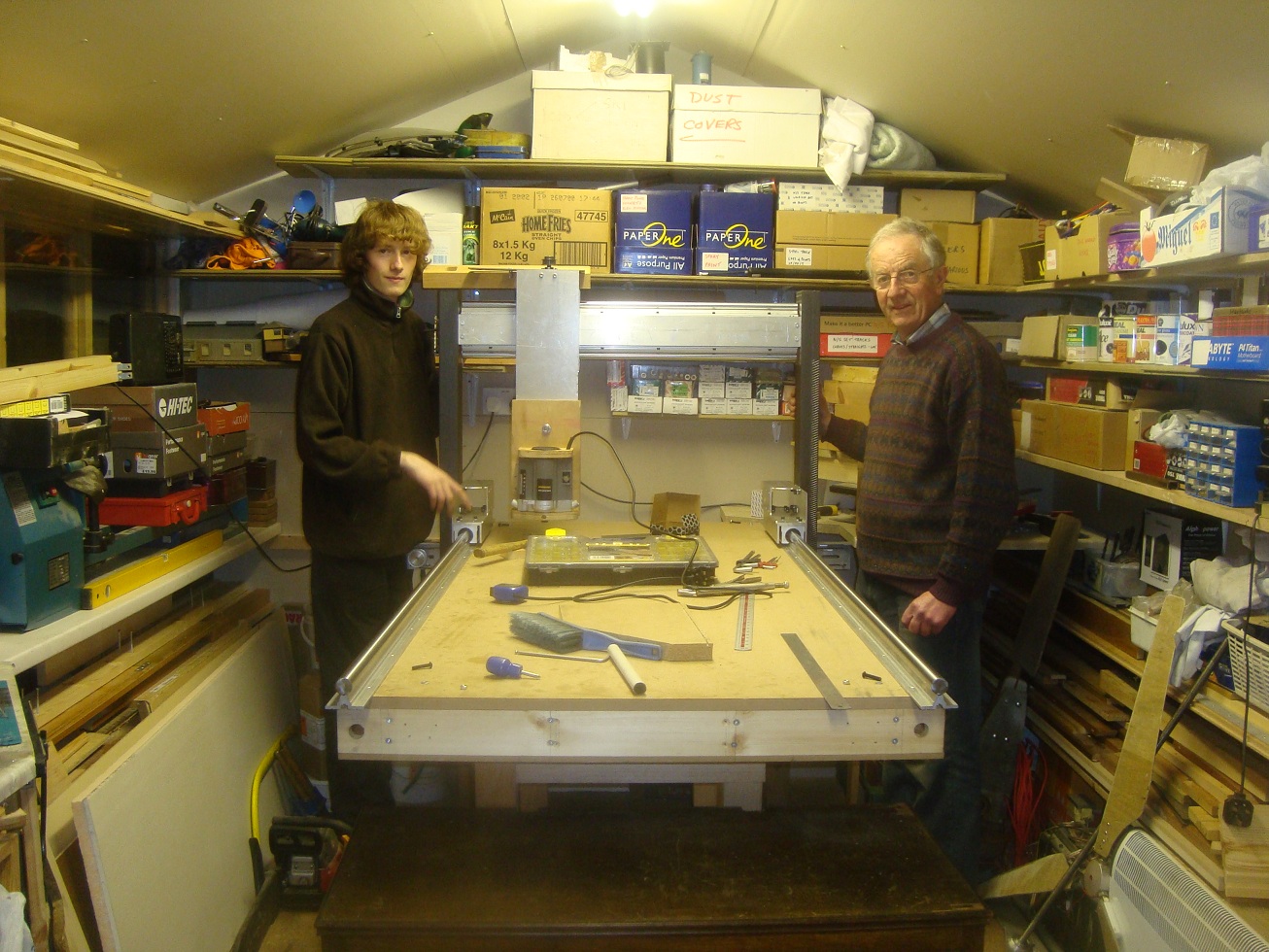

    Christ if i could keep my workshop as clean as yours is dirty i would be heaven................Where do you keep the tesla coil?

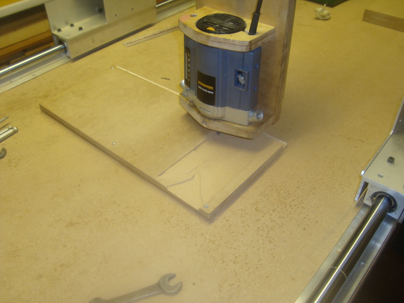

    I'll add photos/vid shortly.
    I did a relief thing, 200x200mm ... 1mm stepover with a 6mm cutter. Varied the feedrate and seemed ok at 3000mm/min. One of the X motors stalled, twice, so that needs looking into. The result doesn't look very good, but that's due to using a flat not rounded cutter since I didn't have one.

    Action shot, suspicious lack of swarf :confused::

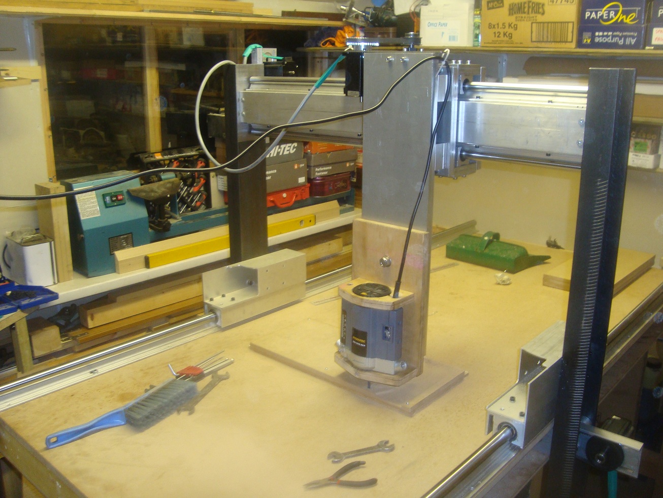

    View of gantry:

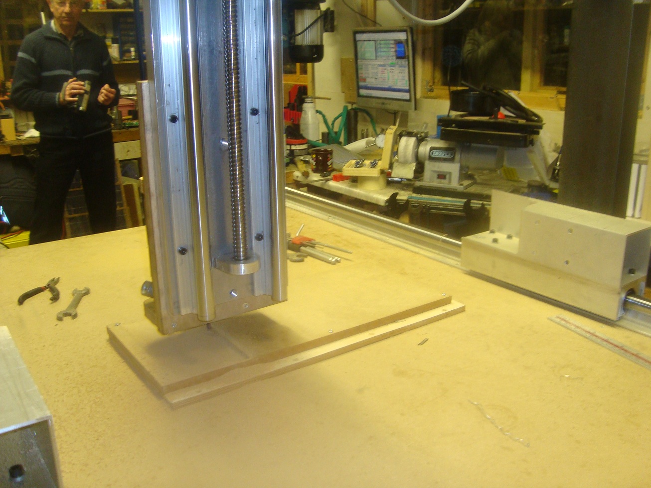

    Z axis, extended to about 390mm:
    Whole router, Dad snuck in on this photo (everyone suddenly appears in the workshop when it starts working!):
  5. #75
    looking good jonathan (the router that is, you need a hair cut :)
    hows it getting on with thet much Z ?
    have you made a provision to drop the whole gantry down for your smaller /finer jobs ?
    it is a good feeling when the thing springs into life :)
    iv was having trouble with one of my X motors stalling, i had to back off on the speed, i swapped channels and the same motor stalled, im thinking there is slightly more drag on that side
    i might swap the bearings for double row A/C bearings to make sure the drag is identical

    It seems fine. There's a bit of wobble visible on the latest part (see below), but I think other factors are contributing such as the whole router wobbling madly due to the floor not being strong enough...
    I have measured the Z deflection parallel to X. I can bend the Z axis by about 0.06mm if I push as hard as I can with little finger, so a reasonable force but not huge. It takes a lot of force to bend it more than that which makes me think it's the linear bearings that are a bit sloppy. Not much I can do about that.
    I've not made it so I can lower the gantry, it's far to heavy to be doing that sort of thing. I think I'll make a raised bed and machine aluminium stuff on that. It's a compromise, but the gantry sides are very strong.
    Yes one X motor is much stiffer than the other. It's limiting my feedrate...
