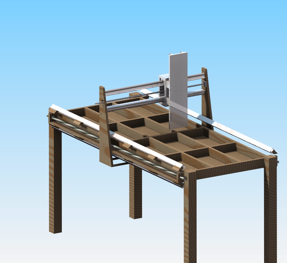

    I'll post some more pictures soon. Here a couple of the base and X/Y/Z axis' I made which will not be used for obvious reasons...
    Drawing....disregard the plywood gantry sides as above.

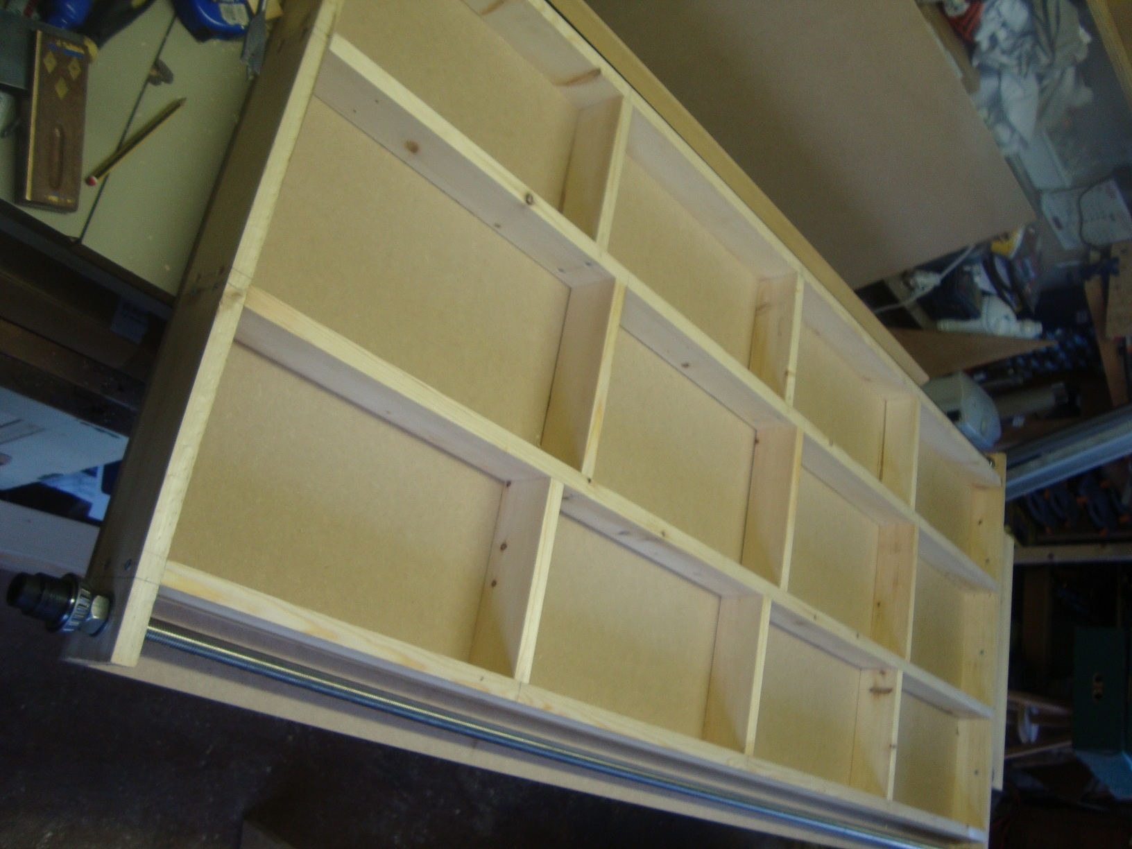

    Frame without top 18mm MDF sheet. Screws are M20x2.5

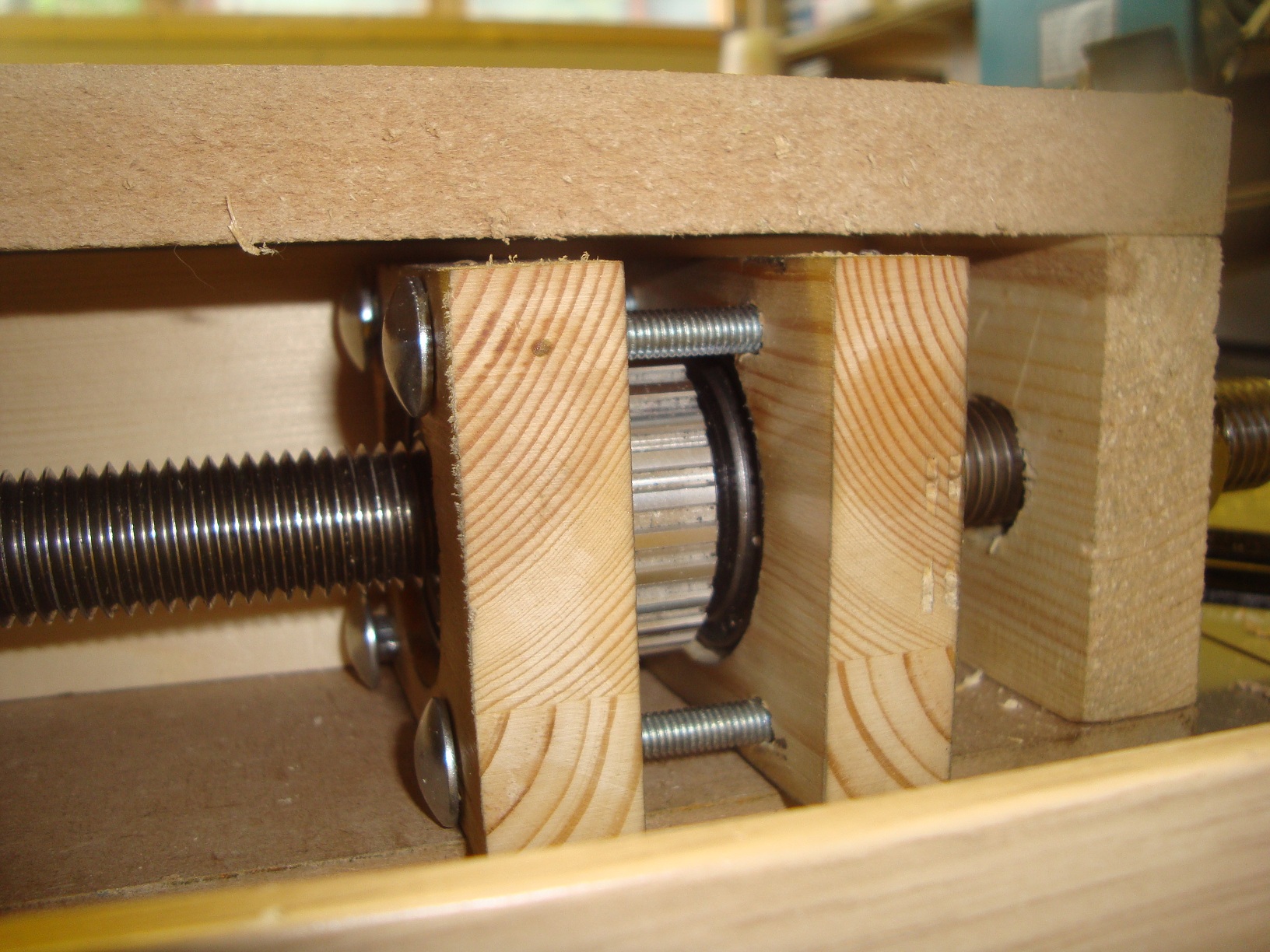

    Didn't want to be spinning those 2m long screws, so antibacklash nut placed between two tapered roller bearings. Those pine side bits are temporary until I make aluminium ones.

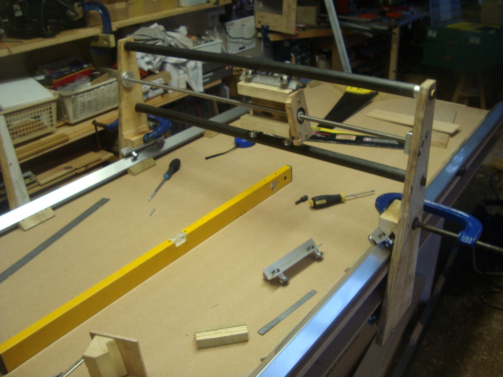

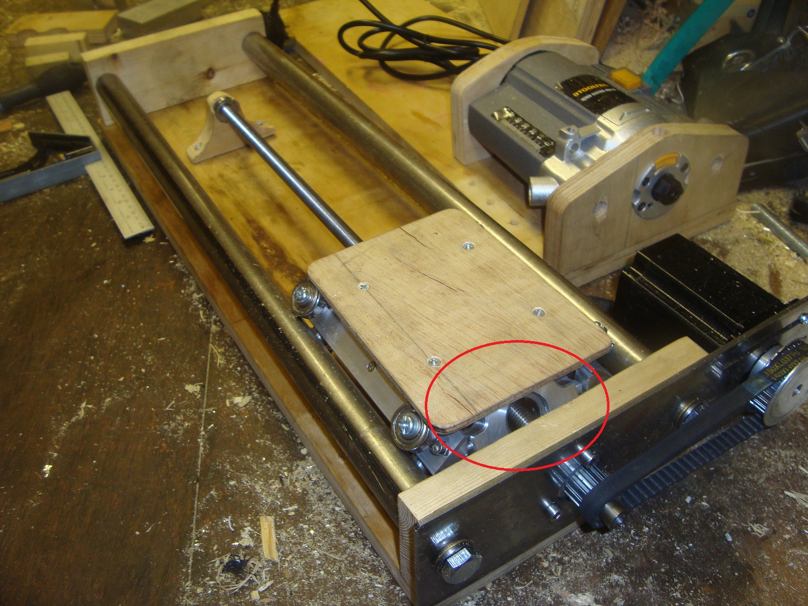

    Er, not much here....am I right in thinking I should rotate the X rails by 90°? At the moment the bottom one possibly doesn't really do much?
    Old Z-axis ... ditched that plywood idea! Do note the alternative to a nut i'm using for the drive on the screw though - bearing. More on that later.

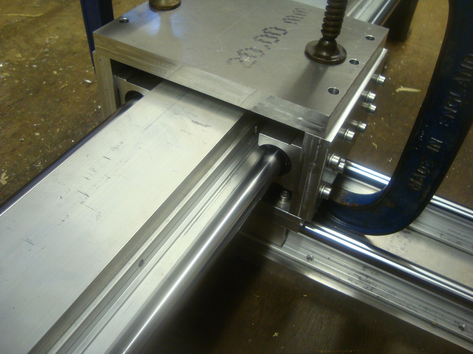

    Gantry...layout of the parts just to check it looked ok:

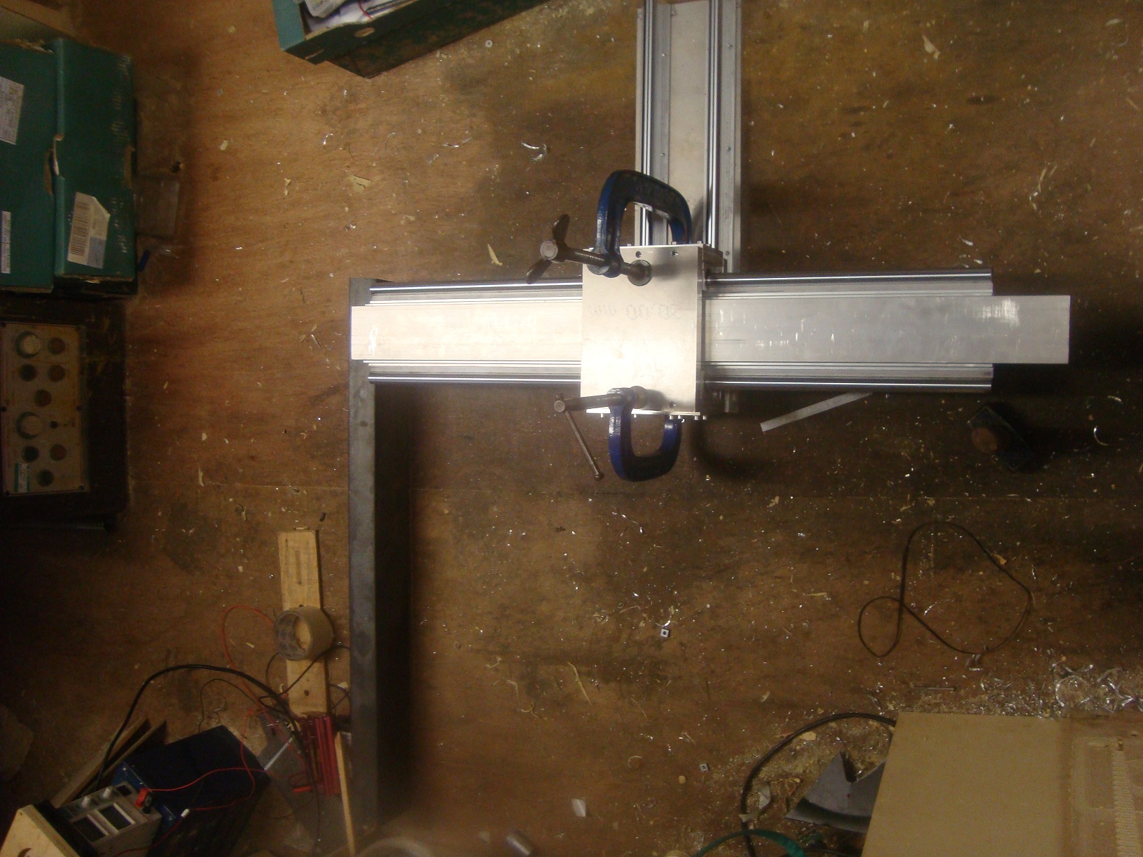

    Closeup of Y/Z axis'

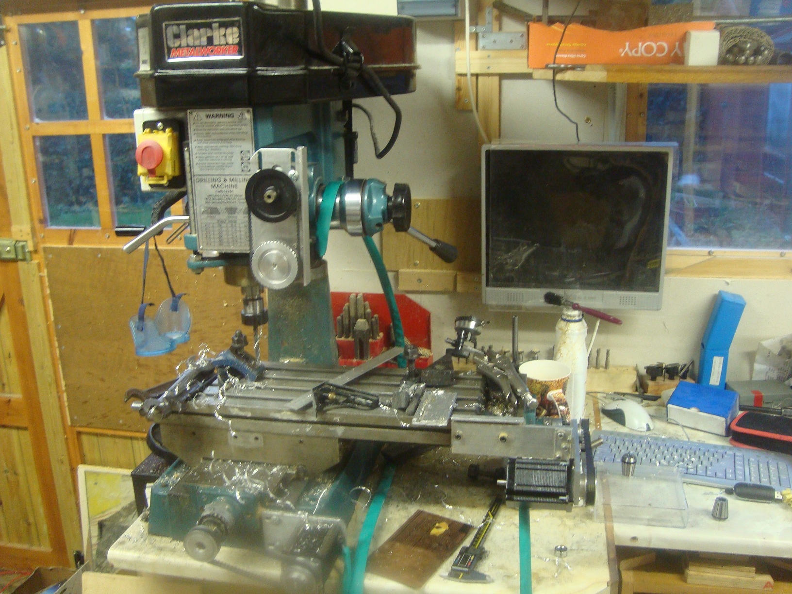

    My milling machine...
    Did you source or mill the aluminum support for the guide rail?
    Thanks, Jeromy

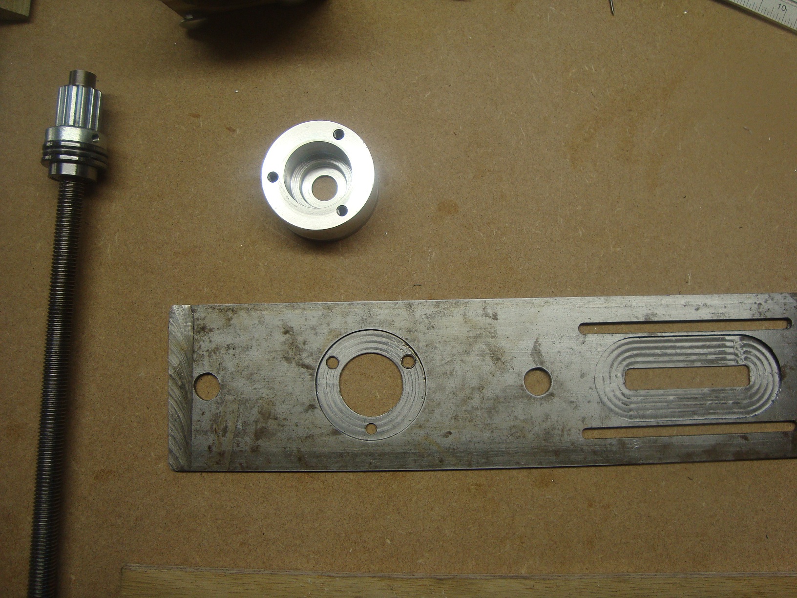

    Just got some M16 threaded rod for the Y-axis, thought I'd give a quick demo of the drive 'nut' as it's a little different...
    I know I should probably use ballscrews, but I reckon using this method is almost as good - rolling friction, low backlash... I measured the backlash on the plywood Z-axis I made using this method and it was <0.005mm which I think is pretty good considering the cost!
    I guess it'd be better to use trapezoidal and put an insert in the bearing to fit the thread better - I'll leave that for a later date though.

    Now that got my attention ... have you detailed it elsewhere?
    Haha, thought it might!
    I've not detailed it elsewhere, shall I start a new 'thread' about this?

    Very nice machine you have there Jonathon !did you get anywher
    e with the 'twisted bearing' screw drive setup ?
    Rich
