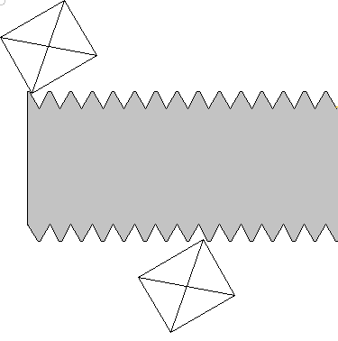

    Just got some M16 threaded rod for the Y-axis, thought I'd give a quick demo of the drive 'nut' as it's a little different...
    I know I should probably use ballscrews, but I reckon using this method is almost as good - rolling friction, low backlash... I measured the backlash on the plywood Z-axis I made using this method and it was <0.005mm which I think is pretty good considering the cost!
    I guess it'd be better to use trapezoidal and put an insert in the bearing to fit the thread better - I'll leave that for a later date though.

  8. What have you done there? Can you give some more detail
    Er, not much more to say really? Standard thin section bearing with bore bigger than the thread (20mm here, but more would be better to get less axial load on the bearing) placed on the thread at an angle. I'll use a strong spring to pull the bearing against the thread so that it rides over any imperfections. That's what the tabs are for on the mount, to mount the spring.

    I'm toying with the idea of pressing a brass insert into the bearing lathed to better fit the 60° thread profile. It's tricky to work out the exact dimensions though...
