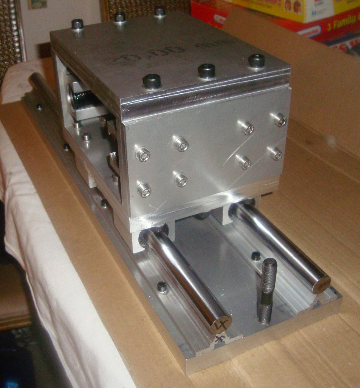

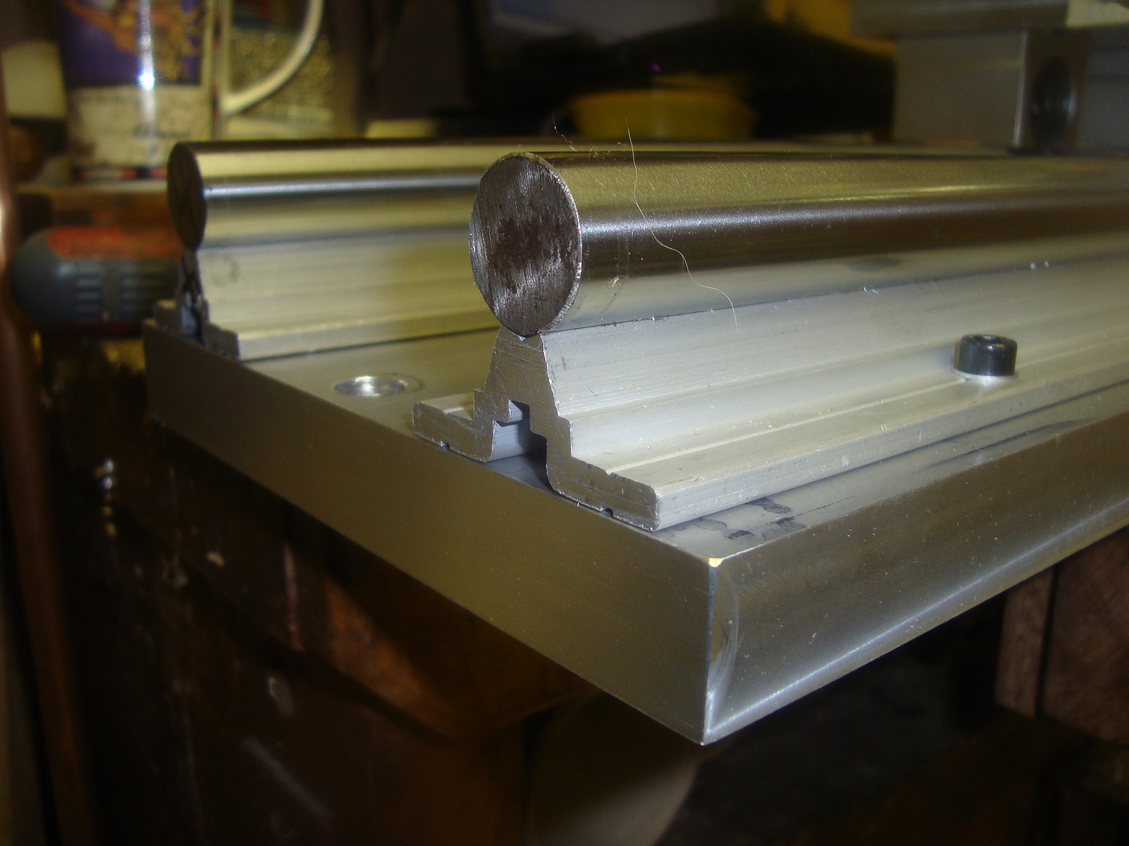

    These photos wore taken yesterday:
    Pretty self explanatory - Z-rails are bolted down and really smooth.
    I milled the alu plate square at school, shiny! Never seen such a good finish on aluminium - must be the grade.

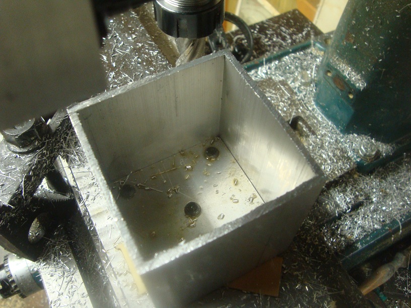

    Today I've milled the gantry sides flat at either end and drilled them. Also had to nip a few mm off the end of one of the Z rails. I was a bit worried with it being hardened, but it milled OK taking small cuts. Plenty of smoke...
    Also started machining the M16 rod for the Y axis.
    I'll post some more photos tonight.

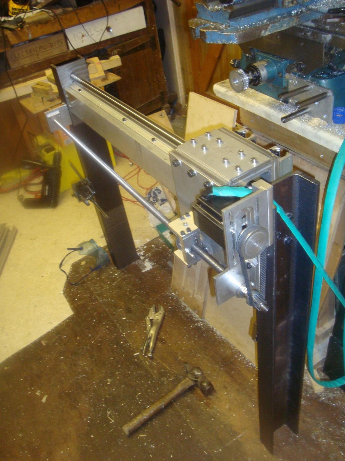

    This is how the gantry fits together.
    Detail of gantry sides. I've milled them flat etc. Unfortunately I drilled those 5 holes (for M8 bolts) in exactly the same place on both sides, forgetting that the other one is flipped over! Looks like I'm going to have to mill those 5 holes on one side to move them across by 6.5mm...dow!

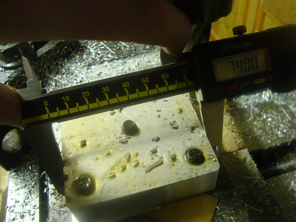

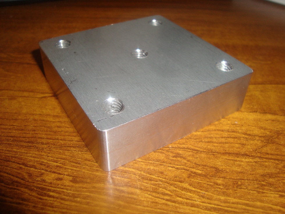

    Pretty accurate too I sawed the plate to roughly 80x80mm then used a 20mm 4 flute endmill to cut it to size. I used 2mm cut depth and 1000mm/min - no problem at all! I'm sure I could have gone faster or cut deeper since it didn't get hot. I then did a single finishing pass taking off 0.2mm at full 20mm depth and 300mm/min.
    I'm very pleased with the accuracy seeing as this is with trapezoidal screws and using backlash compensation. I guess the brand new cutter and having set the backlash compensation values to the nearest 0.002mm a few days ago helped.
    Shiny :)
    Just a shame I didn't measure the box section beforehand and relied on the sellers dimensions. Turns out it's more like 74.6mm, not 74. I think it'll be ok though...
    I'll post a vid of that latest bit of milling when I've compiled it.

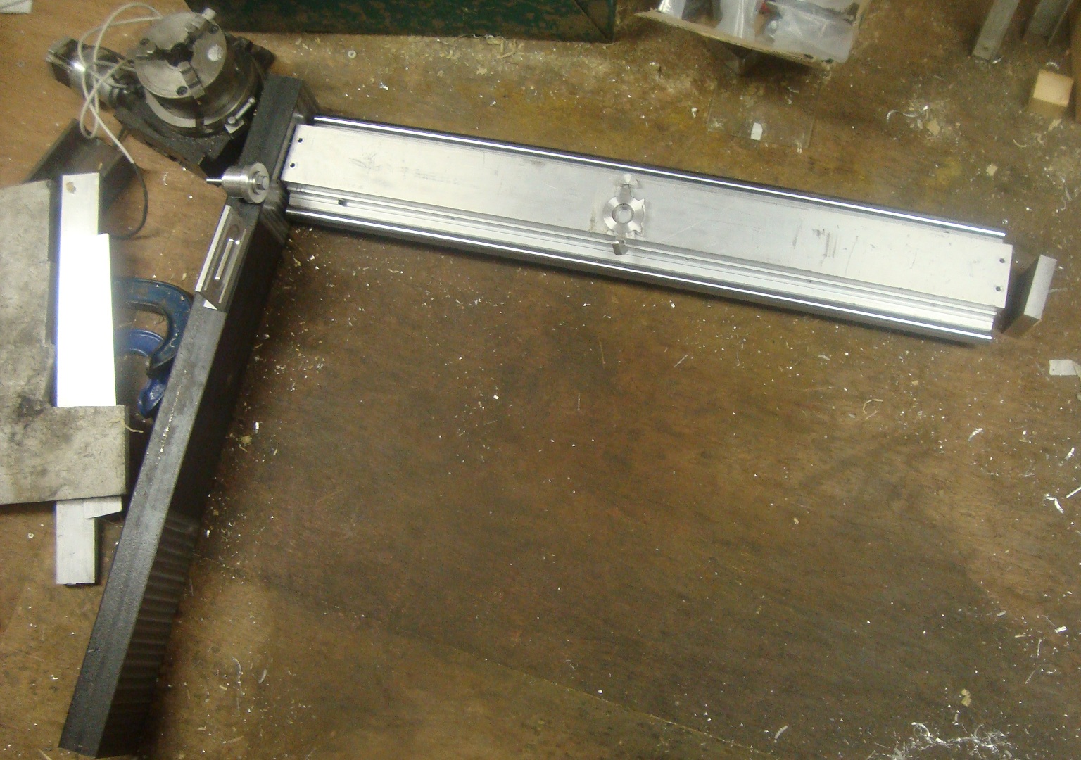

  3. #23

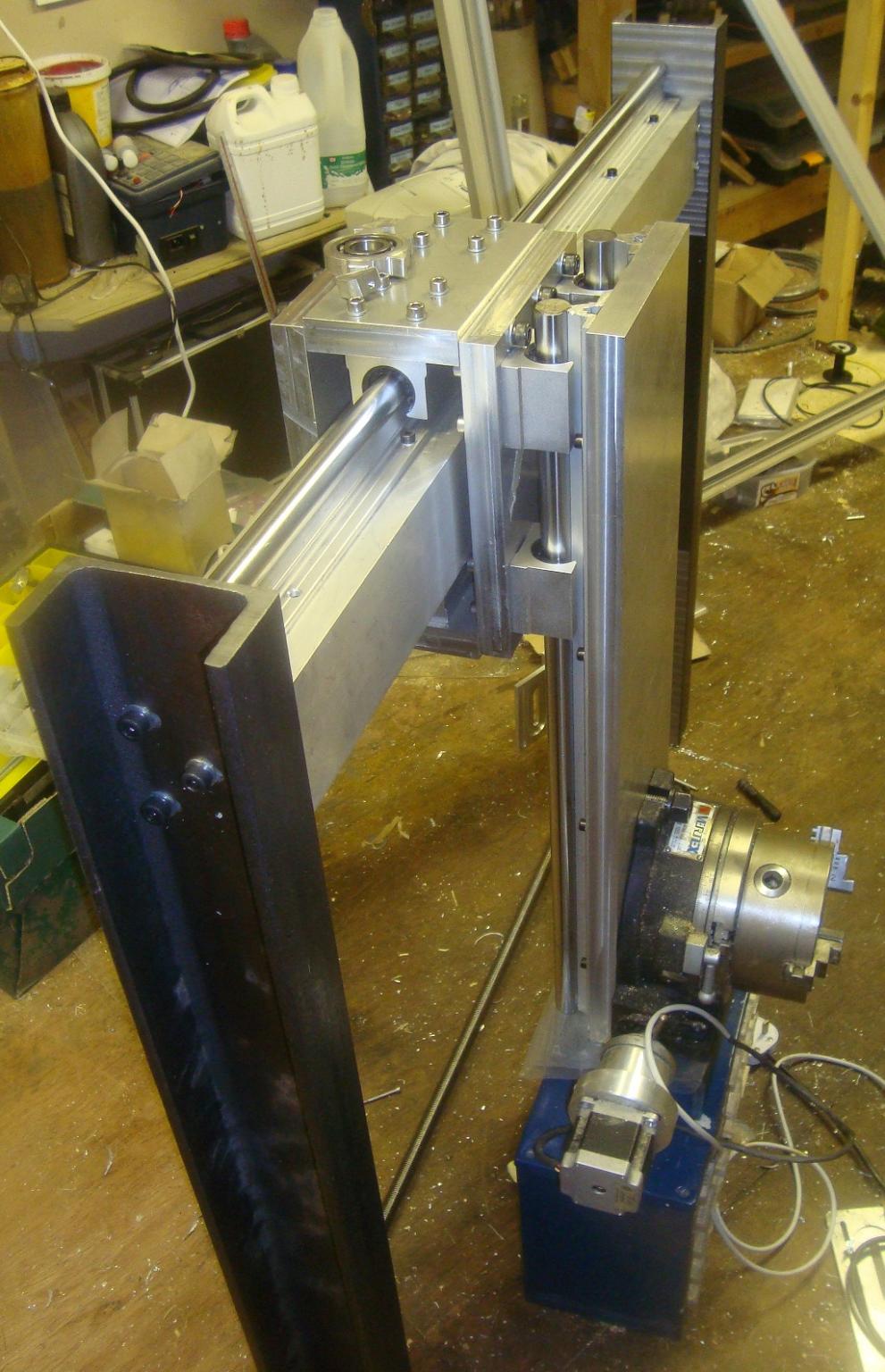

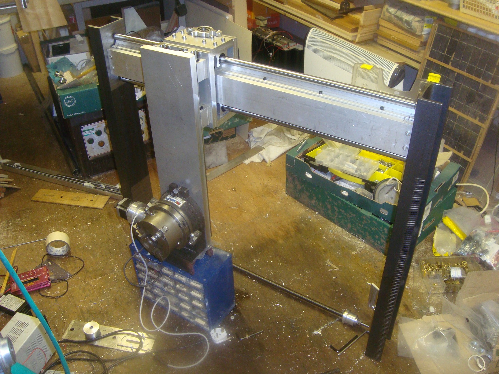

    http://www.youtube.com/watch?v=iC7lXNTPYrg
    Some progress today. I made another of the above part and assembled the 50kg(!) gantry, then assembled it:

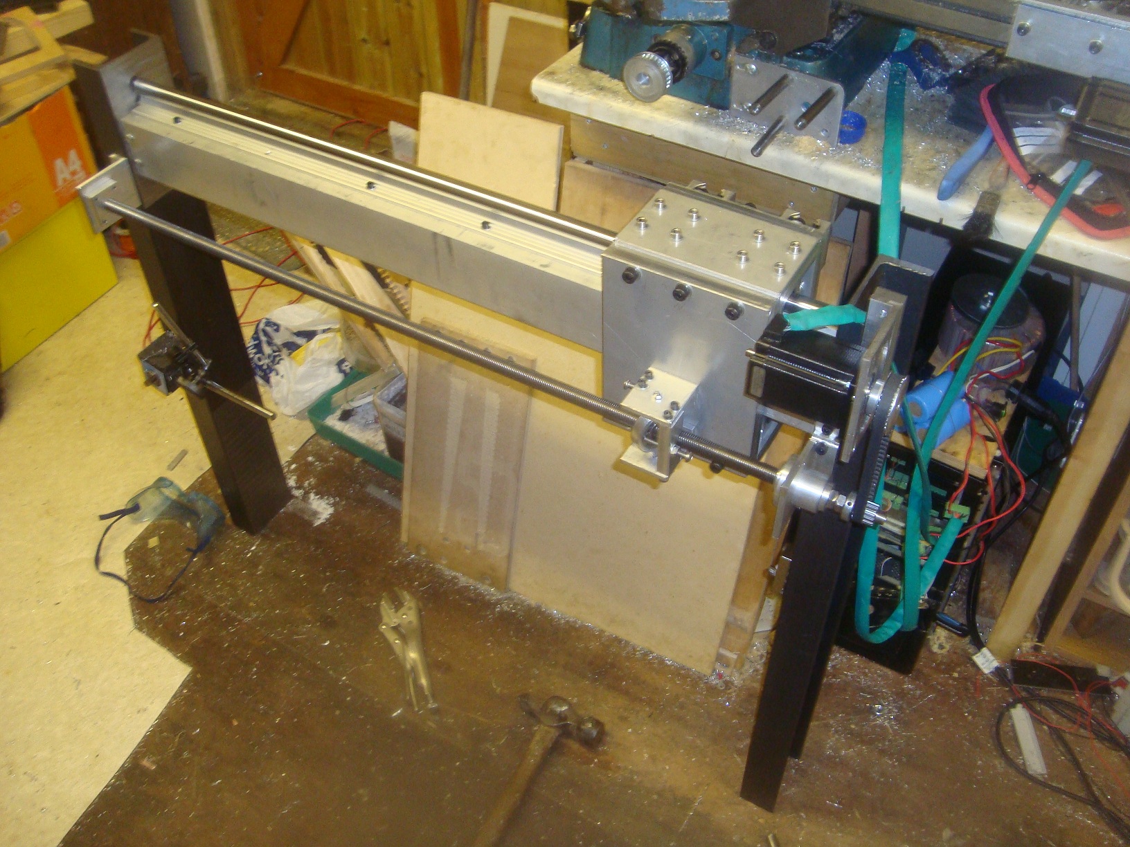

  4. #24

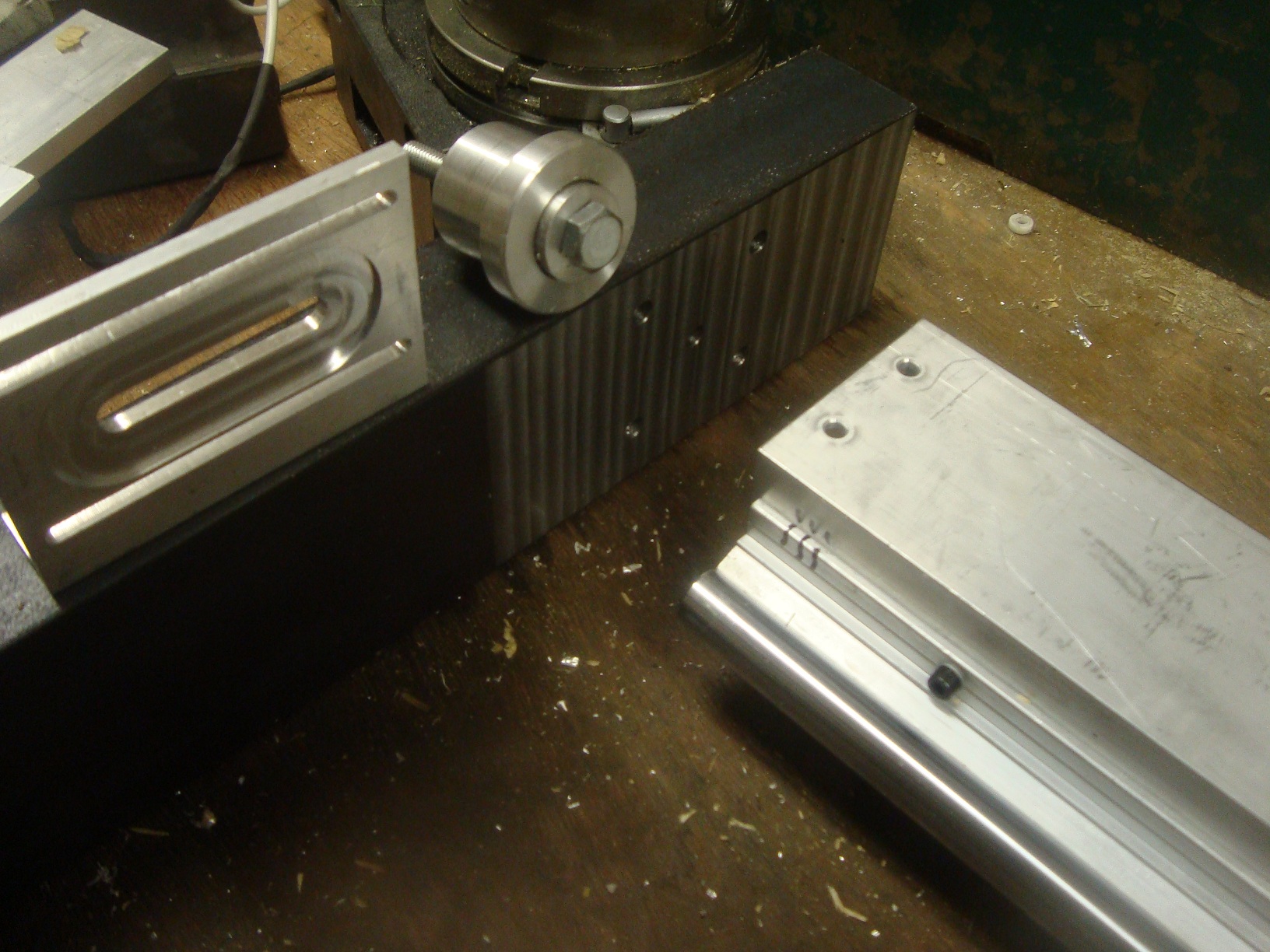

    Success!
    I made the mount for the angled bearing thingy on the Y-axis. I'm not using springs/belville washers at the moment since I don't have any...yet. Currently it's just a few bolts pushing the bearing onto the screw at the right angle, but it seems fine!
    So about an hour ago I clamped the motor mount and just the bearing for the Y screw at the motor end onto the gantry using G-clamps and mole-grips :whistling:
    Motor is half stepping, 42T pulley on motor and 28T on the 2mm pitch screw. Currently I can just get 3600mm/min rapid feed but I'm sure it'll be more if I use a smaller than 28T pulley and mount the bearing on the floating end of the screw. Still a respectable amount though I think?
    Anyway....backlash: 0.006mm :exclaim:
    I spend about an hour checking that figure so I'm pretty confident it's right. I was using a 0.0001" indicator and the reading averaged 0.25 thou.
    I think I'll settle for that :rofl:
  5. #25
    Got the motor and bearings fixed down properly on both ends of the Y screw now.
    Been experimenting with the pulleys. With 42:13 I could get 6000mm/min, but that's above the critical speed of the screw as calculated by Irving's spreadsheet, and yes it started whipping at that. So I tried 28:13 and got 4800mm/min (maybe 5000), which seemed pretty smooth. Acceleration currently 800.
    I don't think I'll use the 42:13, Irving what do you think would be best if you don't mind working it out? I've got plenty more pulleys to experiment with. The motors are the 3N.m ones from Zapp moving an 18kg Z-axis.
    I know it's a balance between high rapid feed and having sufficient torque for cutting, but it's difficult to work out where this point is since there's so many variables!
    I measured the backlash again, and got 0.01mm this time...
    I'm not sure wether to tension the screw or not. It wouldn't be too difficult to tap a hole in the end and use that to tension it with a thrust bearing, but is it going to make much difference if I stick with less than the current critical speed?

    Some photos...
    'Nut' I may well add springs/Belleville washers.
