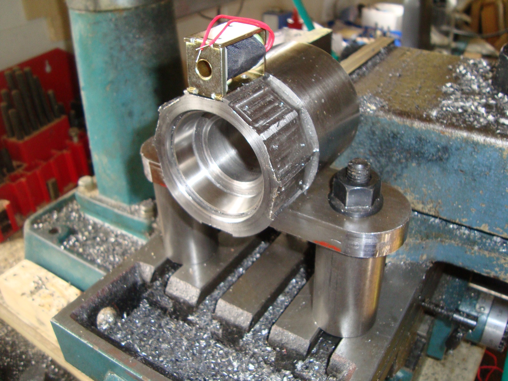

    I mentioned it somewhere else on this forum...not sure which thread though.
    They're a pair of L 68149/L 68110 taper roller bearings. It's all mild steel - shows the dehumidifier is working as it's ages since I machined it. I'll use a stepper motor via timing belt to drive it since there's no way I could afford a servo. Also putting a disk brake using solenoids to hold it steady whilst milling. When I want to use it as a lathe I can put the big brushless motor on it. 6000rpm at several Kw would make a nice CNC lathe. I made it mainly to use with the milling machine, but I may well use it on the router.
    I've machined the shaft to fit an 80mm chuck, same as my C3 lathe, but I'll make an adapter to put a 5" chuck on it.
    Using 4th axis to make 4th axis (or should that be 5th?):
    Cross section, note disk break arrangement:
    Mounted on mill:

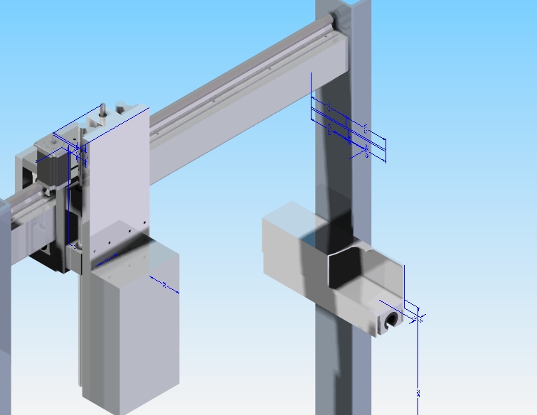

    Made good progress on the router today. Milled and drilled aluminium box section and channel to mount X axis linear bearings. Also drilled and milled one side of gantry to fit that, and put slot in for timing belt to go through. Lots of smoke and blue swarf when drilling the steel. It's a 20mm wide slot so I chain drilled @ 16mm (biggest I have) to save time with the 20mm milling cutter. Will probably make more sense when I put photos tomorrow.
    I'm 14 holes and one slot away from finishing :) Plus a bit of assembly and wiring I suppose.
