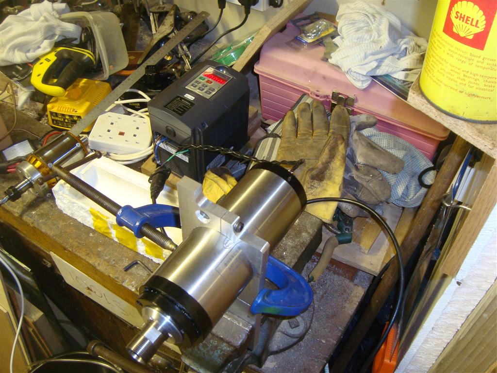

I got one mount done and started the top one. I've not got a photo of the finished mount, but you can get the general idea from here:
The extra aluminum on the side will let me fit dust extraction.

06-03-2011 #97
Spindle is mounted and working!
Runout isn't great - 0.05mm ish.
But it seems good in all other ways. I just cut some carbon fiber with it, about 2mm thick at 450mm/min with a cheap diamond burr at 24,000rpm. It's cut well and left a decent finish.
I'll post some photos soon.
06-03-2011 #98
Spindle mounted + VFD:
Water cooling... crude but it works. My mum is wondering where her bucket has gone!
Closeup:
Trimming carbon fiber sheet. Having the spindle going off the end of the bed is dead useful:
I intended mounting the VFD there to be temporary, but now I'm thinking I might leave it since it saves on cable. The extra mass on the Z axis isn't much compared to what's already there. If I switch the steppers off the Z axis now drops due to gravity. Before the detent torque of the motor was sufficient to stop this.
