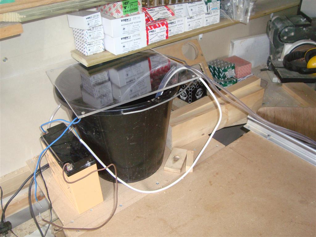

    Setting up the VFD was no problem. I've got a little 8L/m submersible pump for the water cooling. I've just tried it with a bucket of water and an odd assortment of tubing, about a couple of meters in total, and I got 1.3L/m flowing. I think that's fine.
    With 5l of water in a plastic bucket the temperature rose by about 0.25°C/min. The spindle was only drawing 0.6A from the mains.

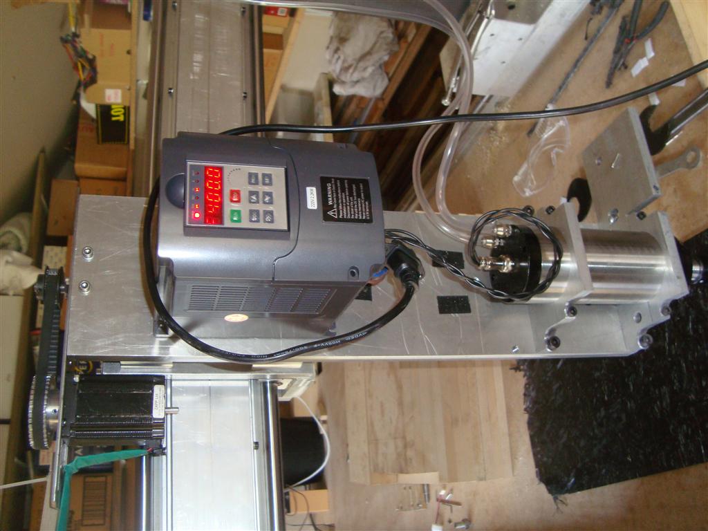

    Spindle is mounted and working!
    Runout isn't great - 0.05mm ish.

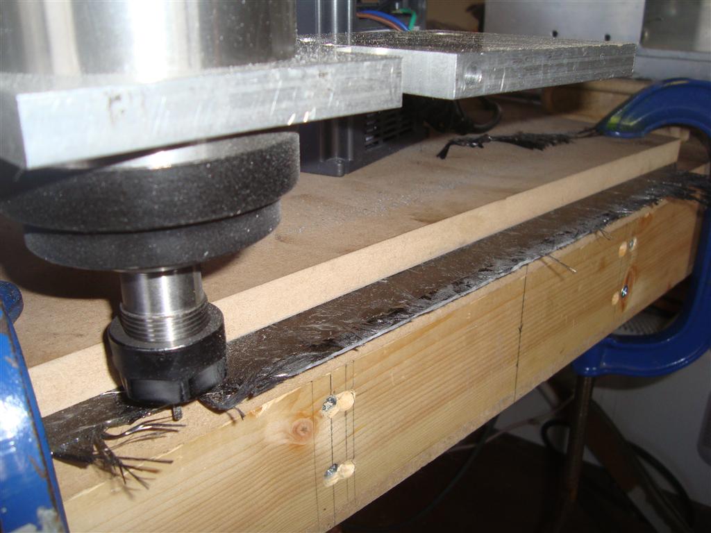

    But it seems good in all other ways. I just cut some carbon fiber with it, about 2mm thick at 450mm/min with a cheap diamond burr at 24,000rpm. It's cut well and left a decent finish.
    I'll post some photos soon.
    Spindle mounted + VFD:
Name:	DSC06991 (Medium).JPG
    Water cooling... crude but it works. My mum is wondering where her bucket has gone!
Name:	DSC06988 (Medium).JPG
    Closeup:
Name:	DSC06979 (Medium).JPG

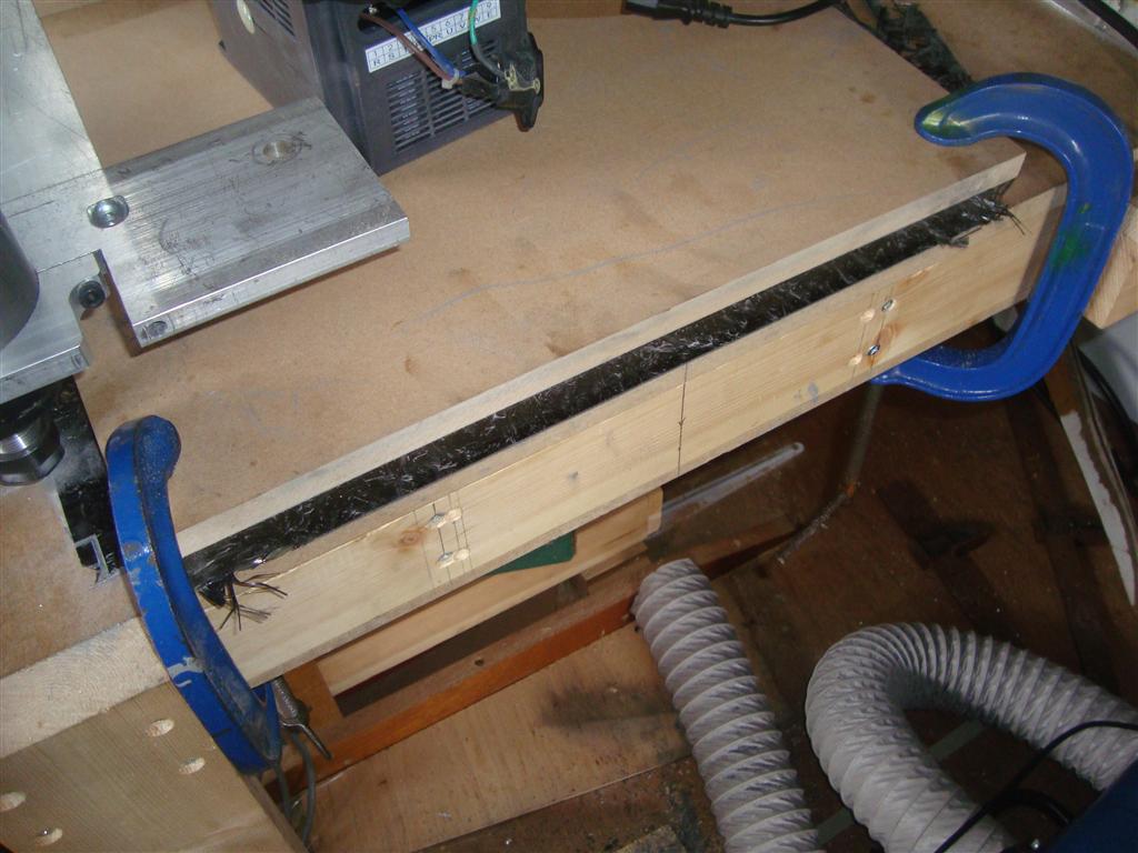

    Trimming carbon fiber sheet. Having the spindle going off the end of the bed is dead useful:
Name:	DSC06986 (Medium).JPG
    I intended mounting the VFD there to be temporary, but now I'm thinking I might leave it since it saves on cable. The extra mass on the Z axis isn't much compared to what's already there. If I switch the steppers off the Z axis now drops due to gravity. Before the detent torque of the motor was sufficient to stop this.
