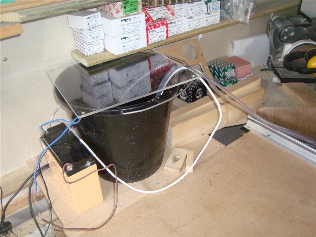

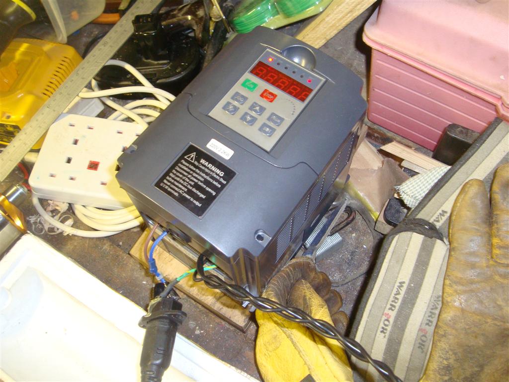

    Setting up the VFD was no problem. I've got a little 8L/m submersible pump for the water cooling. I've just tried it with a bucket of water and an odd assortment of tubing, about a couple of meters in total, and I got 1.3L/m flowing. I think that's fine.
    With 5l of water in a plastic bucket the temperature rose by about 0.25°C/min. The spindle was only drawing 0.6A from the mains.

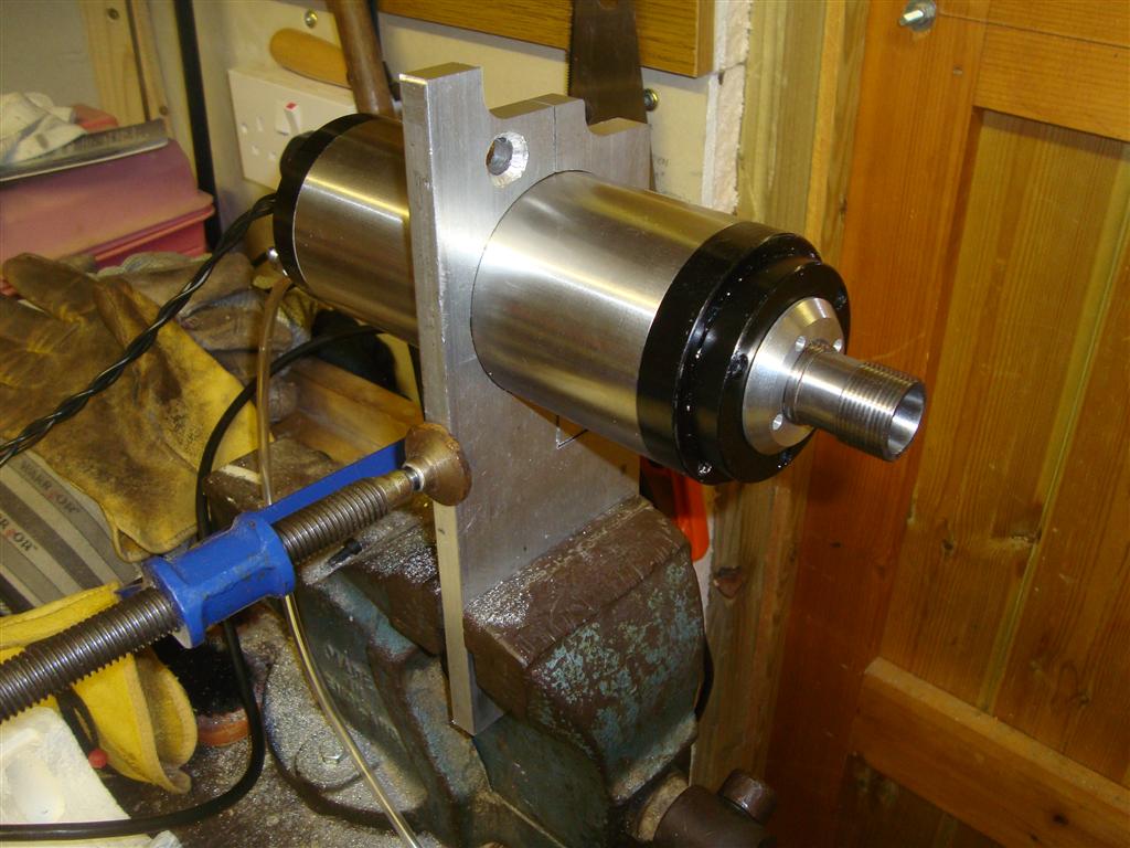

    No I didn't get it cutting. Went to my grandmas on Sunday so didn't get as much done as I'd hoped.
    I got one mount done and started the top one. I've not got a photo of the finished mount, but you can get the general idea from here:
Name:	DSC06969 (Medium).JPG
Name:	DSC06971 (Medium).JPG
Name:	DSC06970 (Medium).JPG
    The extra aluminum on the side will let me fit dust extraction.

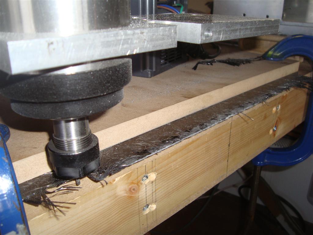

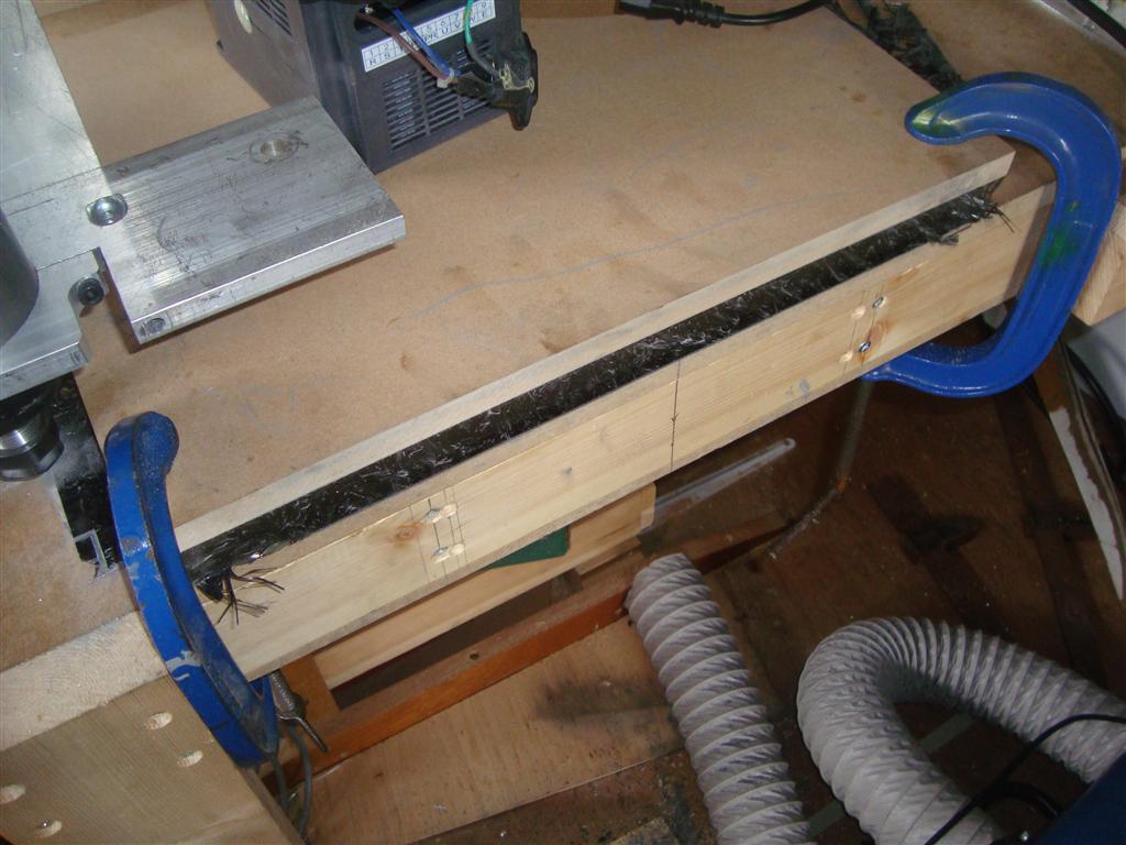

    Spindle is mounted and working!
    Runout isn't great - 0.05mm ish.
    But it seems good in all other ways. I just cut some carbon fiber with it, about 2mm thick at 450mm/min with a cheap diamond burr at 24,000rpm. It's cut well and left a decent finish.

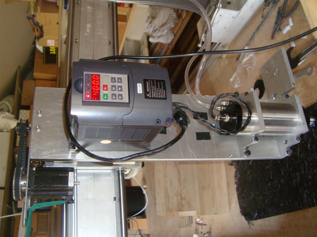

    Spindle mounted + VFD:

    Water cooling... crude but it works. My mum is wondering where her bucket has gone!

    Trimming carbon fiber sheet. Having the spindle going off the end of the bed is dead useful:
Name:	DSC06986 (Medium).JPG
    I intended mounting the VFD there to be temporary, but now I'm thinking I might leave it since it saves on cable. The extra mass on the Z axis isn't much compared to what's already there. If I switch the steppers off the Z axis now drops due to gravity. Before the detent torque of the motor was sufficient to stop this.
    I'd be more worried about the effect of vibration on the VFD.
