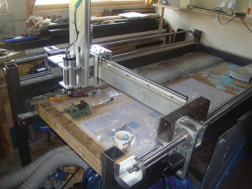

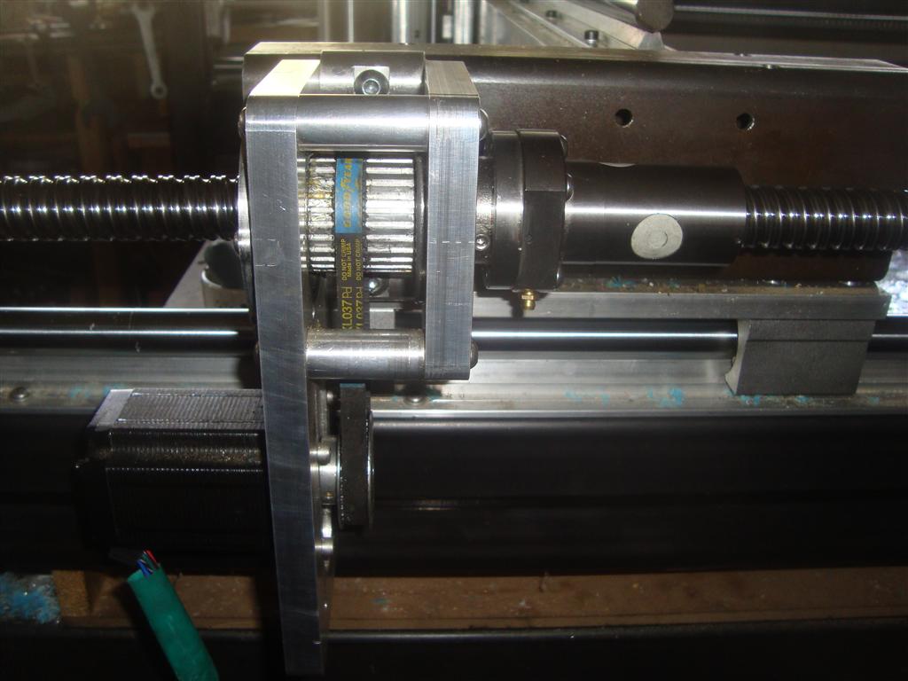

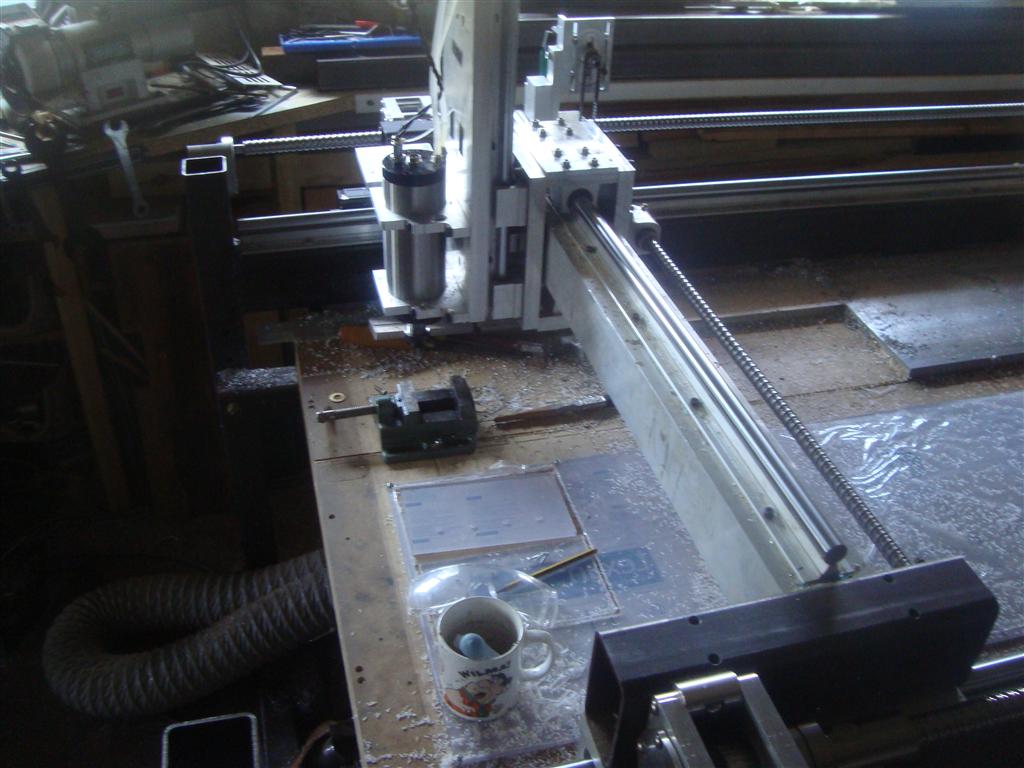

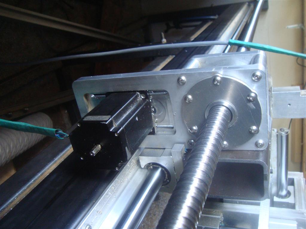

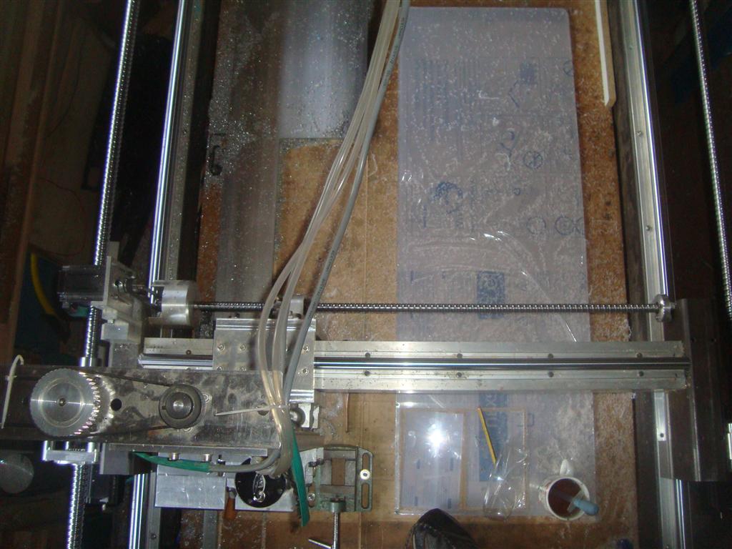

    I had a request for some more photos, so here they are in no particular order:
Name:	DSC08515 (Medium).JPG
Name:	DSC08519 (Medium).JPG
Name:	DSC08520 (Medium).JPG
Name:	DSC08517 (Medium).JPG
Name:	DSC08521 (Medium).JPG
Name:	DSC08516 (Medium).JPG
  6. #126
    Jonathan what have you used on your Y axis, I can't quite make it out
  7. #127
    Quote Originally Posted by deannos View Post
    Which part in particular?
    It uses an RM1610 ballcrew, 3Nm stepper motor...nothing unusual.
  8. #128
    Your gantry in particular, is it ali box section
  9. #129
    Yep:
    I went to a small local metals supplier and picked up a meter of 80x3mm aluminium box section for the Y rails to mount on
    It's mounted with 20mm aluminium plate milled to fit in both ends. It's adequate, but I would advise using something a bit stronger. Since the rails are on both sides of the box section it had to be aluminium since the width of steel box section is not accurate enough. Extrusion is a good option, but quite expensive.

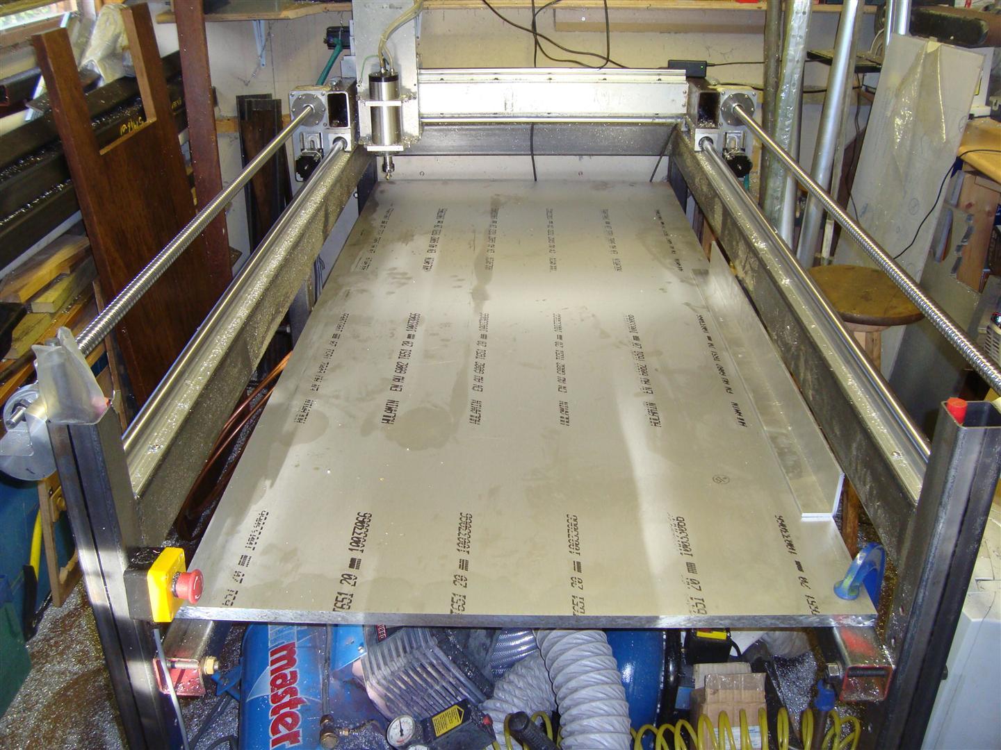

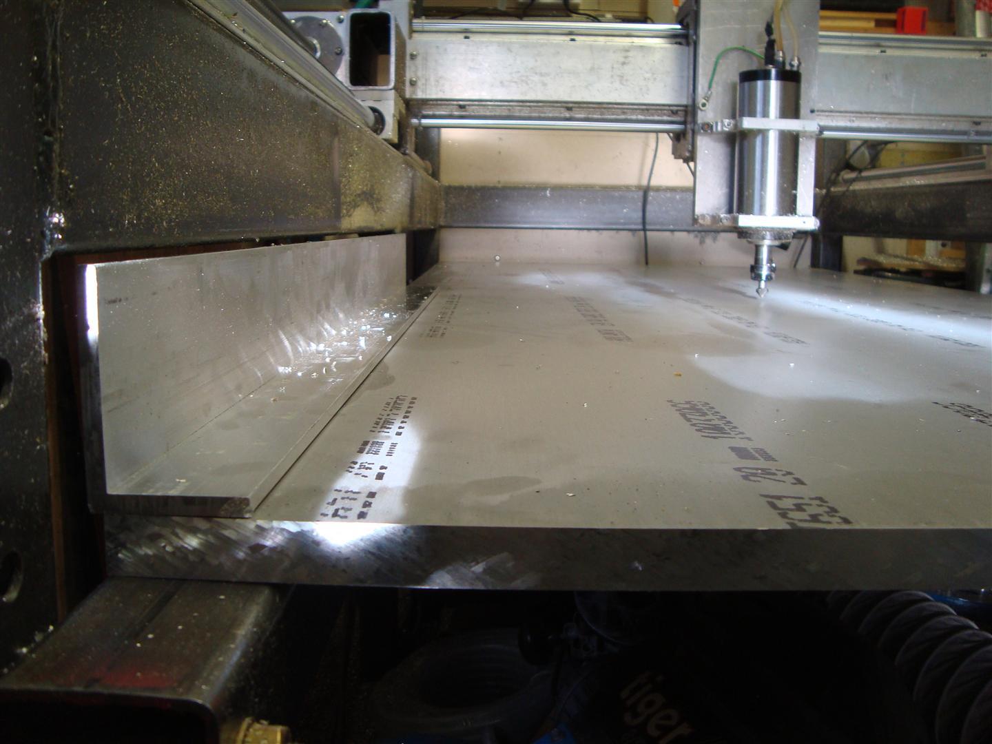

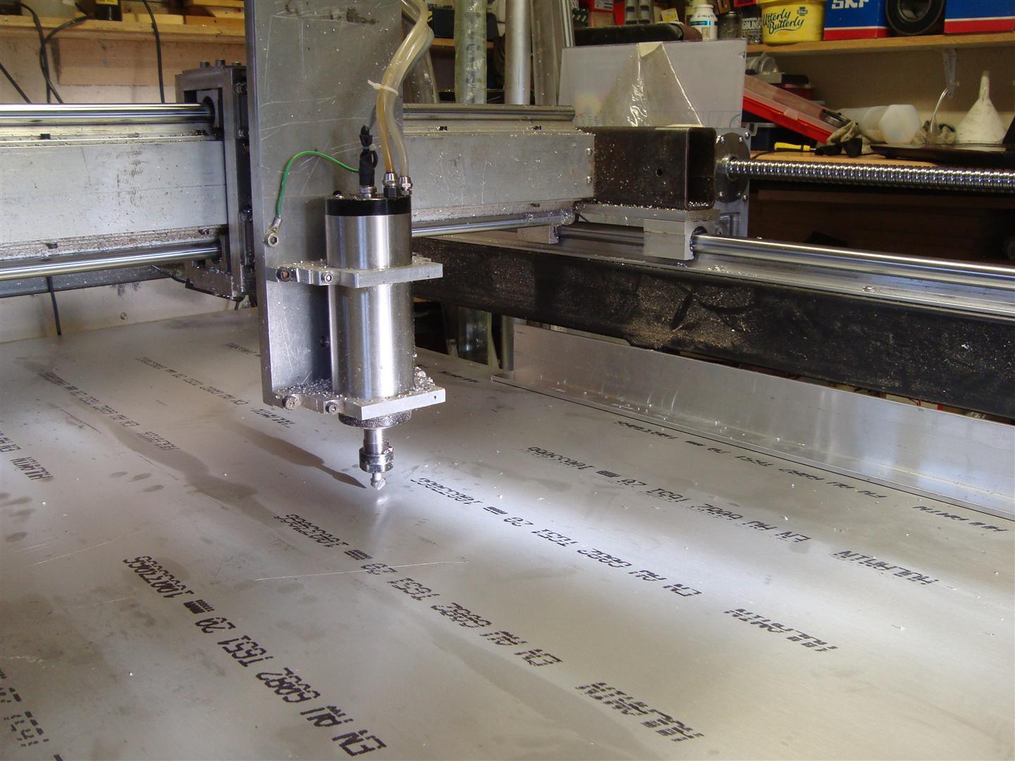

    The first of many upgrades to come:
ID:	6825Click image for larger version.
ID:	6826Click image for larger version.
    I'll be fixing 20 meters of 2"x1/2" aluminium strip under the bed in a grid to make it a bit stronger, since it's only 20mm thick aluminium. I've got 6m of the aluminium angle to go round the perimeter to enclose flood coolant, which will be the next upgrade. I'll have the router drill an array of holes to tap M8 for clamping. I elected not to go for strips (to imitate T-slots) as the difference in price is not that great in the whole scheme of things and this should be stronger although either would have been sufficient. Need to get it at the right height too...
