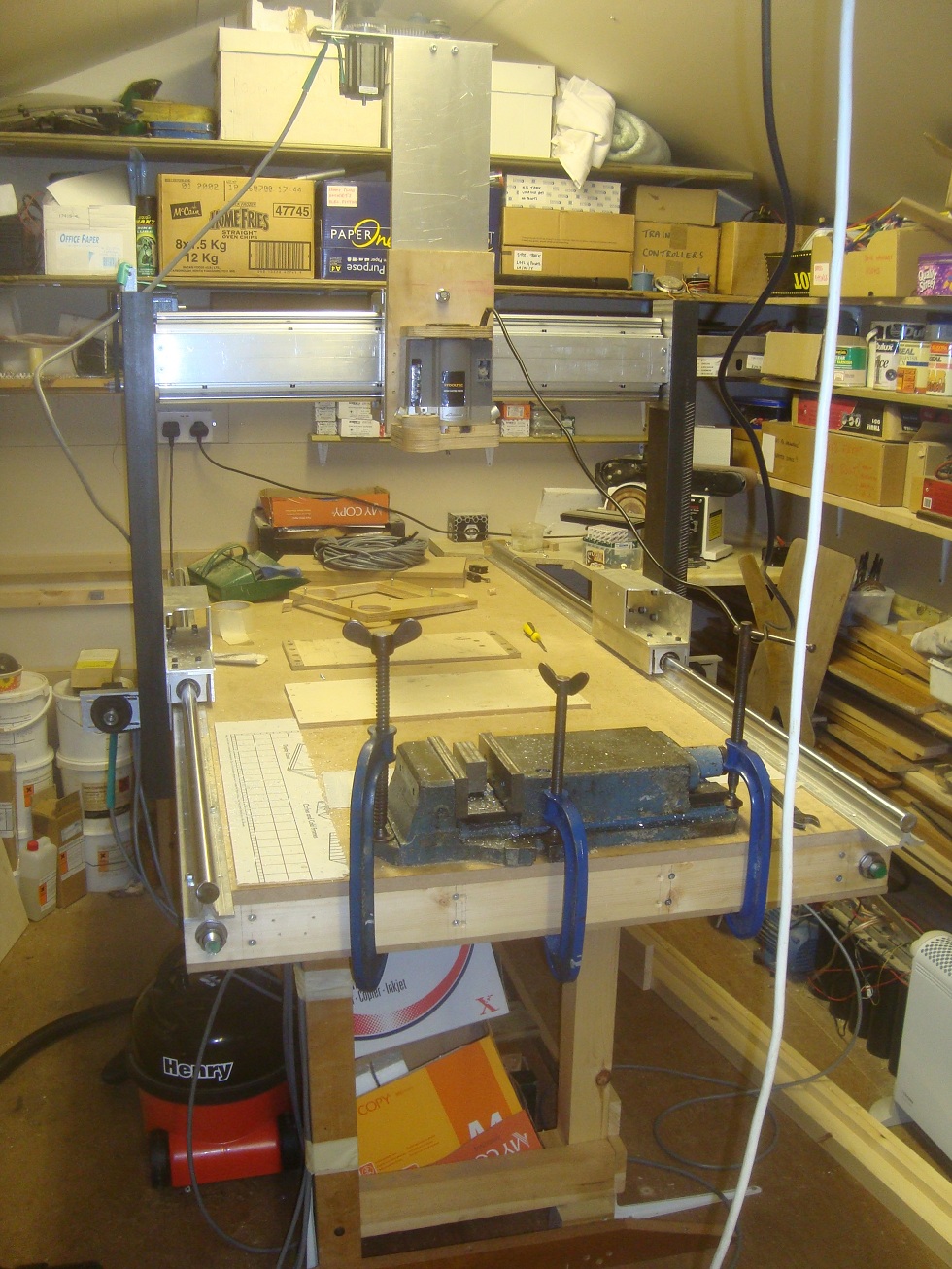

    im assuming you slackened everything off at one end (nut housing and bearing housing) and ran the gantry to that end and nipped it up, then did the same at the outher end... back and forth a couple of times to make sure
    Yes I did exactly that. I think I'll try it again.
    I saw on you-tube a video about making ballscrews and they straightened it by putting the screw between two blocks, and pushing down in the middle with a lever to bend it.
  2. #82
    sounds like a winner
    just take your time untill you know how much pressure it takes to get it to move or youll end up going passed the sweet spot and youll be chasing muliple curves up and down it till new year :)
  3. #83
    I relieved most of the tension on the X screws and now it's much better. Seems happy at 3600mm/min over the whole bed. I'm using a 42T pulley on motor, and the 28T pulley I posted about earlier on the 2.5mm pitch screw.
    Bed surfacing, not terribly exciting but it demonstrates the vacuum working reasonably well:

    Bit of a faliure! I think I'll try that again but with it mounted higher on the bed. I could see/hear the Z wobbling.

    That's a lot less aggressive than 3 flute 8mm ballnose with 1mm DOC and 2m/min I tried! Anyway I've since noticed the plywood router mount I made isn't as tight as I thought which should make a huge difference.
    I think I will look into making it easy to lower the gantry.
