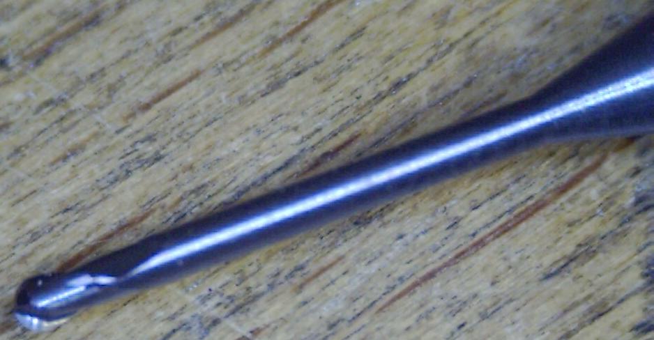

    If you think 1mm is scary, howabout this in 1.2mm?
