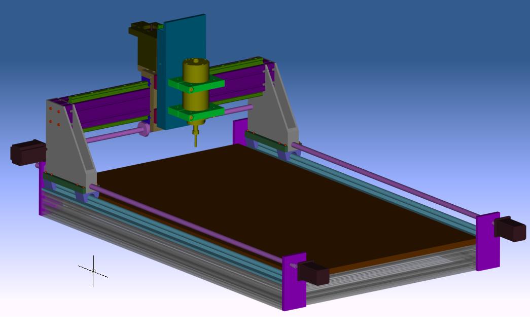

    Hi Steve,
    Here's a sketch I was working on a while ago. Double X axis motors, all ballscrews, profile rail Y and Z, supported rail X. Gantry sides are RHS with spacer block connection to gantry. Y axis ballscrew is underneath to give a low bending moment on the gantry sides. Disadvantage is risk of collision damage and swarf ingress (needs shield).
    Maybe some ideas in there.

    I agree with your design comments.. My first cnc was an endless battle with dust on exposed lead screws and bearings, really have to have a very efficient dust extraction system, or even better, tuck all the exposed stuff out of the way..
    Steve..
