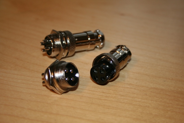

  7. Some more bits arrived today :)
    A nice project box - actually an IP66 wall mount wiring enclosure but it will house the PSU and driver cards. Being IP66 it is completely sealed but I will put a filtered fan on the side and replace the top wiring gland with a fine mesh (air blowing out the top will keep dust/crap out). It has a nice glas front so I will make up an internal panel with lots of flashy LEDs on it :)
    The second is a set of 3 x 4-pole lockdown connectors for the steppers, all the way from Hong Kong for under £6 the set, eBay shop is AllPartsPipe. They do 5, 7 and 9 pole too... all rated for 20A DC... and lots of other goodies (Power MOSFETs for instance)
