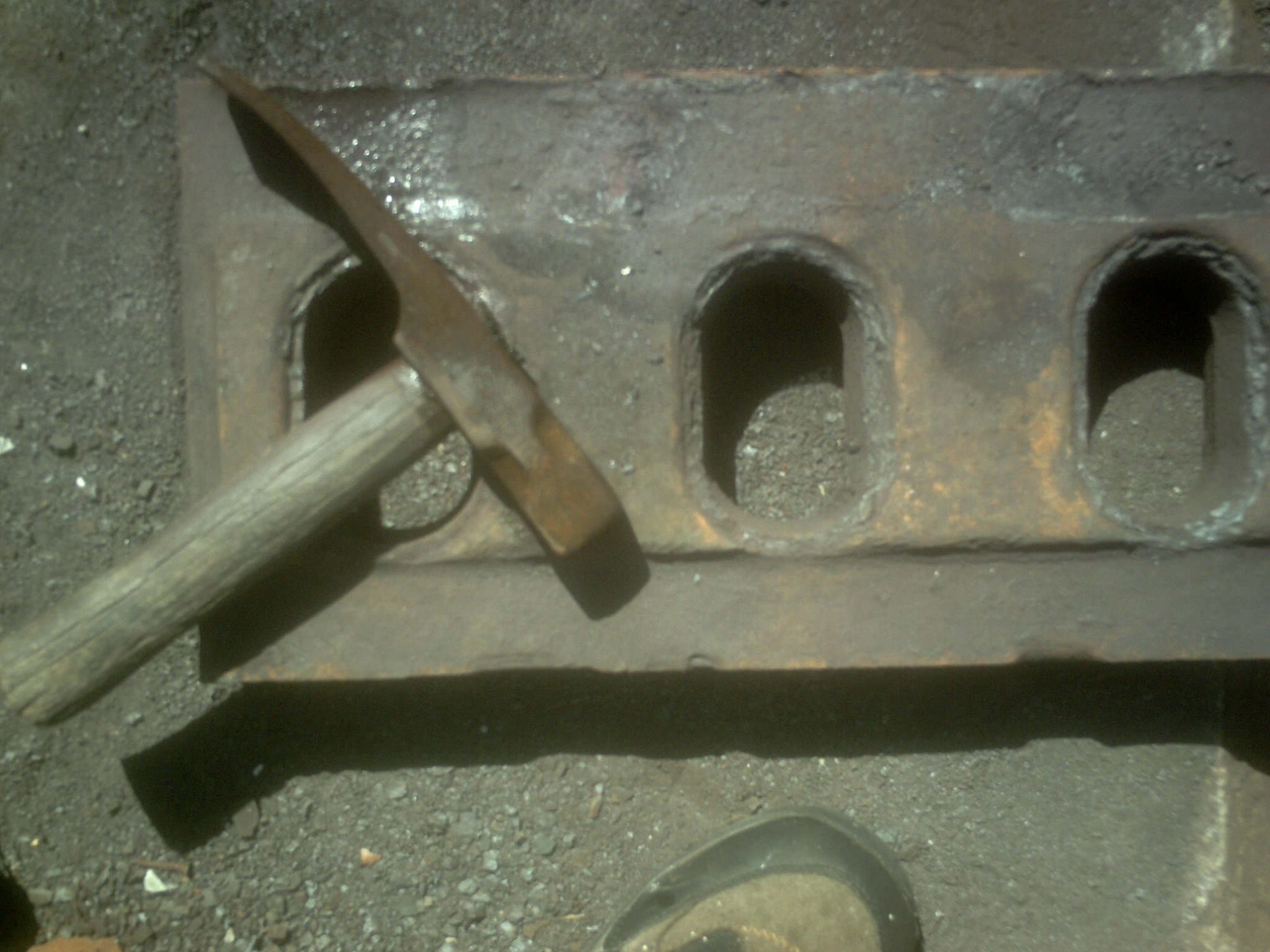

  5. THUMPING NOT PUMPING IRON !!

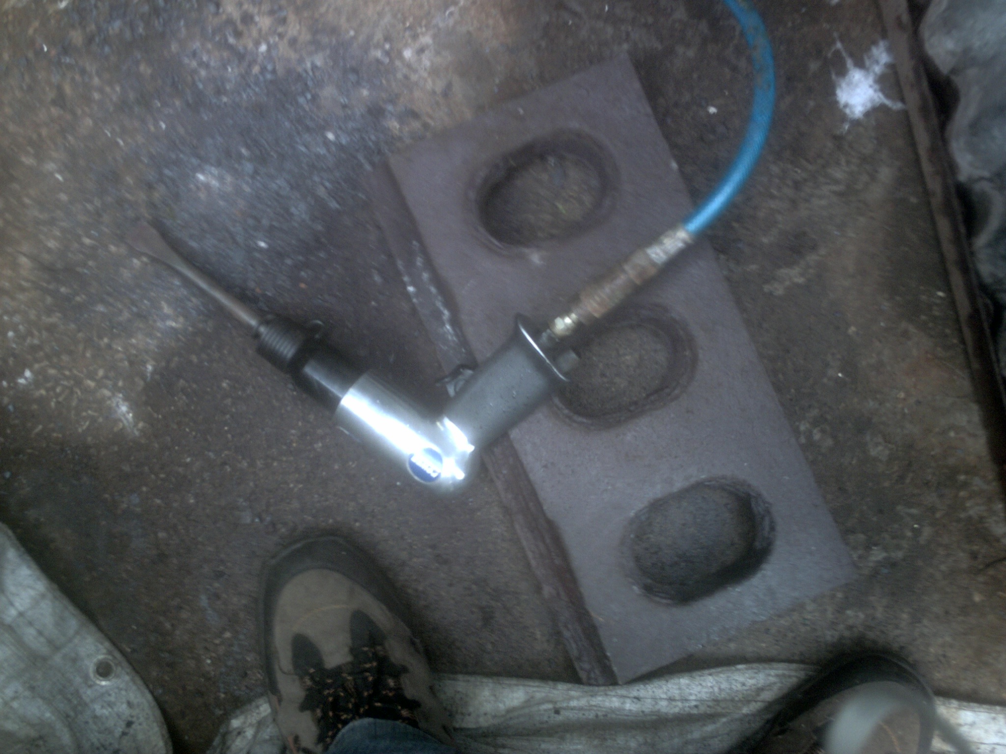

    Here is a picy of the base of my mill/grinder its a cast iron night storage heater block. Unfortunately its covered with what I find is called cementite. Aptly named, its as hard as diamond and sticks like s--t to a blanket. The only way of getting it off is with a bricky's hammer. If not removed is distroys hacksaw blades and lathe tools. This bit will be used intact but I am using this material for column clamps etc, so there is a fair bit of machining.

  6. THE SMART WAY OF THUMPING IRON
    Using one of these babies is a lot easier than a hammer especially in confined places. £16 from Aldi it pays to keep an eye on this store. Mind it uses lots of compressed air. The mill grinder I am building is based on
    www.neme-s.org/Model_Engineer_Files/swing_grinder.pdf
    Its supposed to be able to grind its own table.

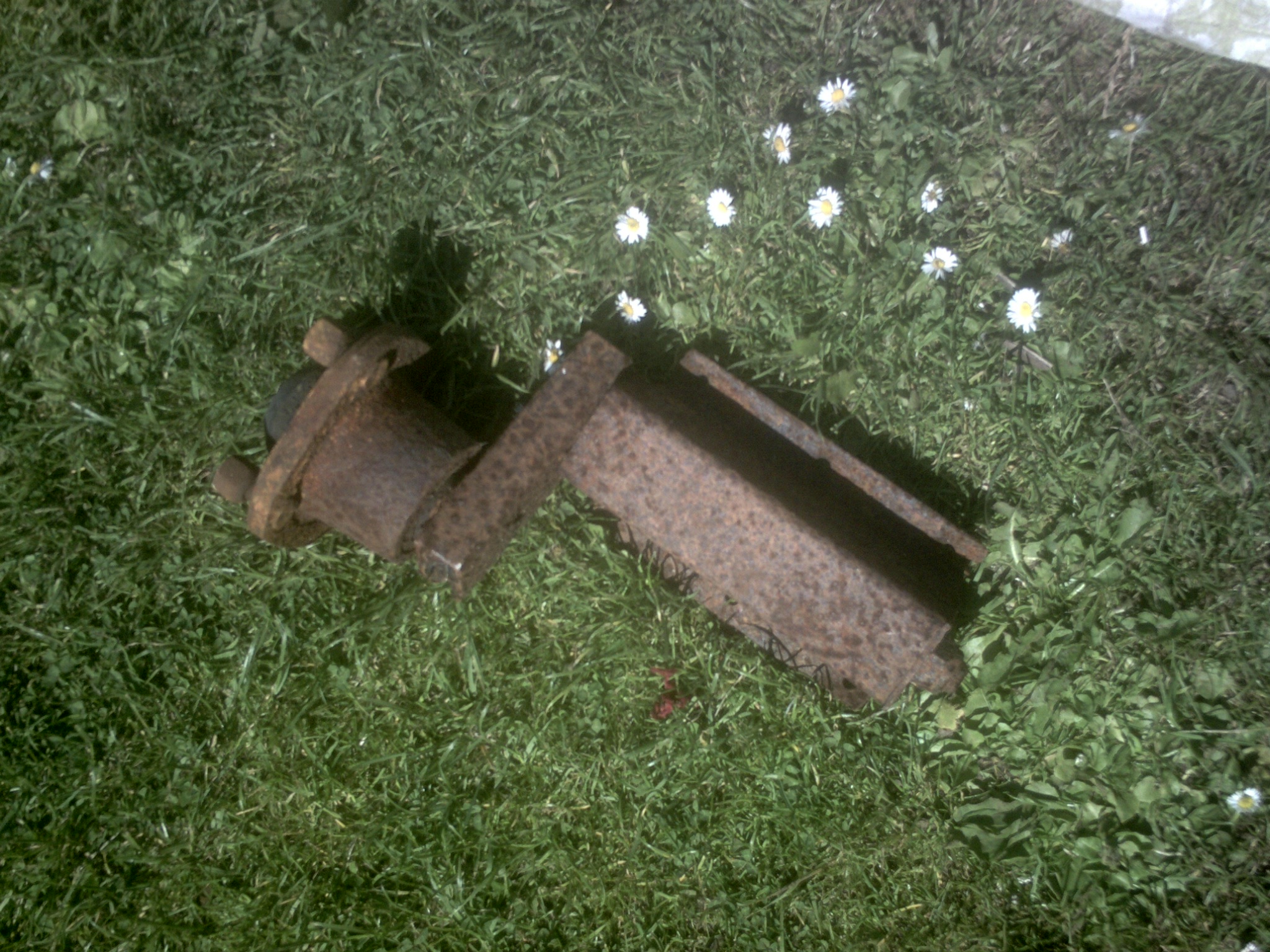

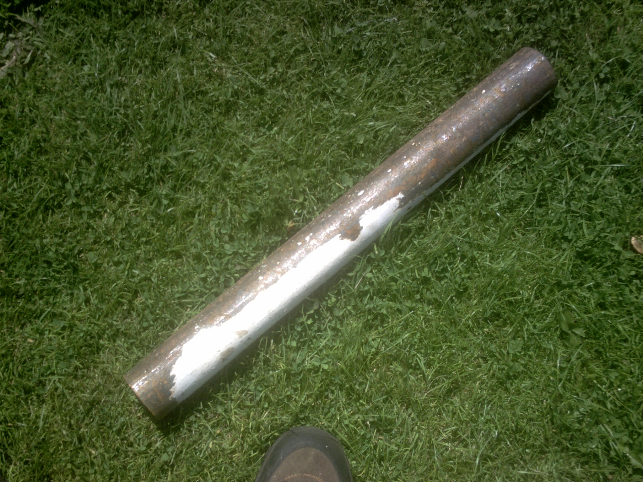

  7. Having gotten the base plate cleaned I must turn my attention to taking the flange which is to be welded to the base of the column (6cm pipe) the indispension unit has to be taken to bits. This wheel flange will then bolt the column to the base plate and can be shimmed etc for squareness. Oh I almost forgot the column has to be turned to be uniform in a better lathe than mine before welding. There is a lot to do.

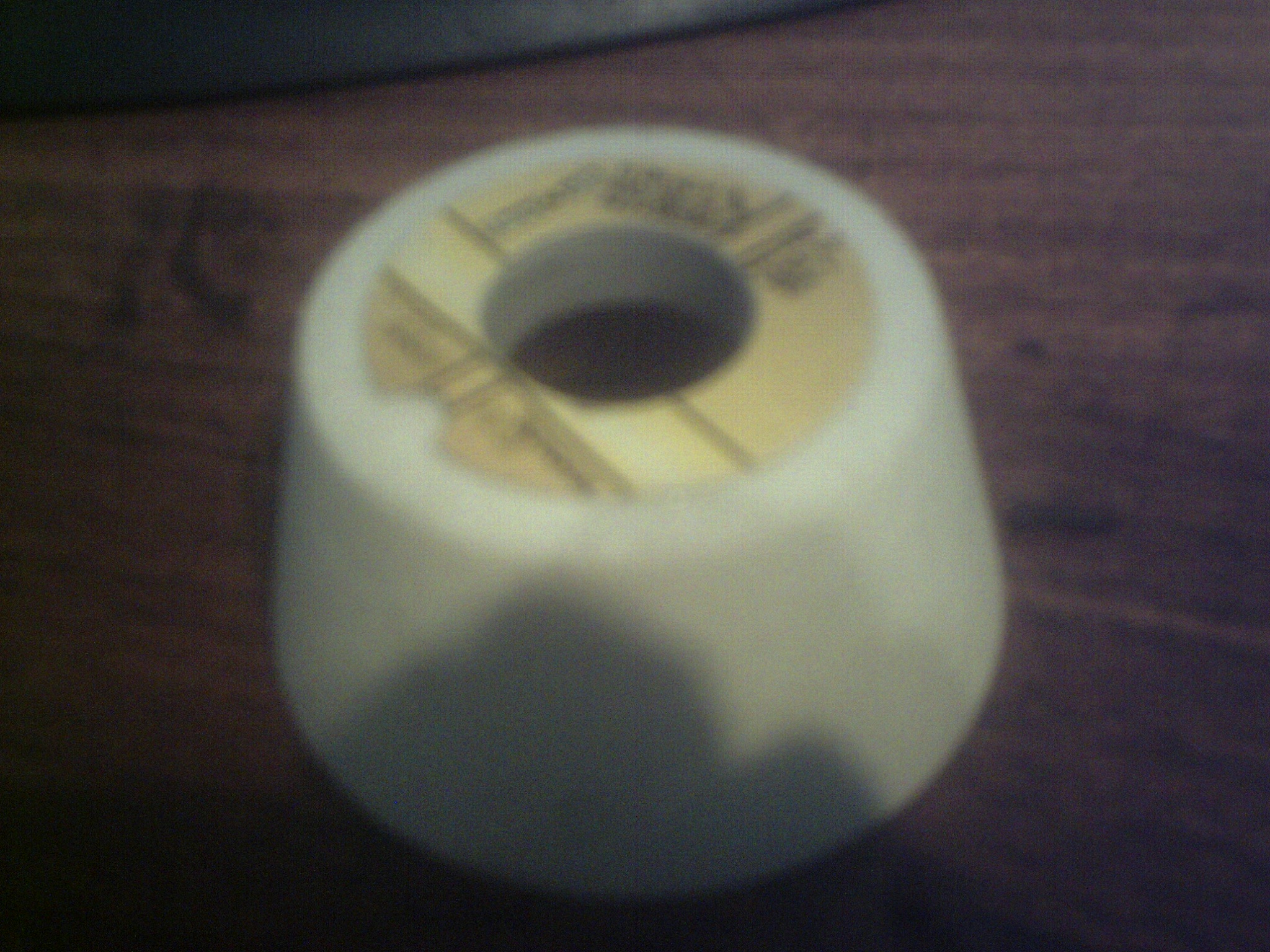

  8. It's a concrete lampshade !!
    My latest acquirsition from the Cumbria steam rally at the week end. Has a big hole though, will have to give some thought about making an arbor.
    Cheers Keith

  9. #59
    Quote Originally Posted by keith77777 View Post
    There may only be one diamond in the house that will true this thing up, but I suggest you ask her first :naughty:
  10. Grindstone cowboy
    Hi Robin in the group
    I really must broach the subject and duck to avoid flying pans.:lol: I think out of balance would be my gratest worry. Same old Steam rally as 5 years ago always the bloke drilling files. A shortcut to what I am trying to make would be the pillar drill you could make a swinging head by loosening off the head and having it rotate on a collar. Most surface grinders seem to have a trough with the gindstone doing the bis, guess this must be for safety. With having a variable speed motor at least I can keep the revs down for starters.
    Cheers Keith
