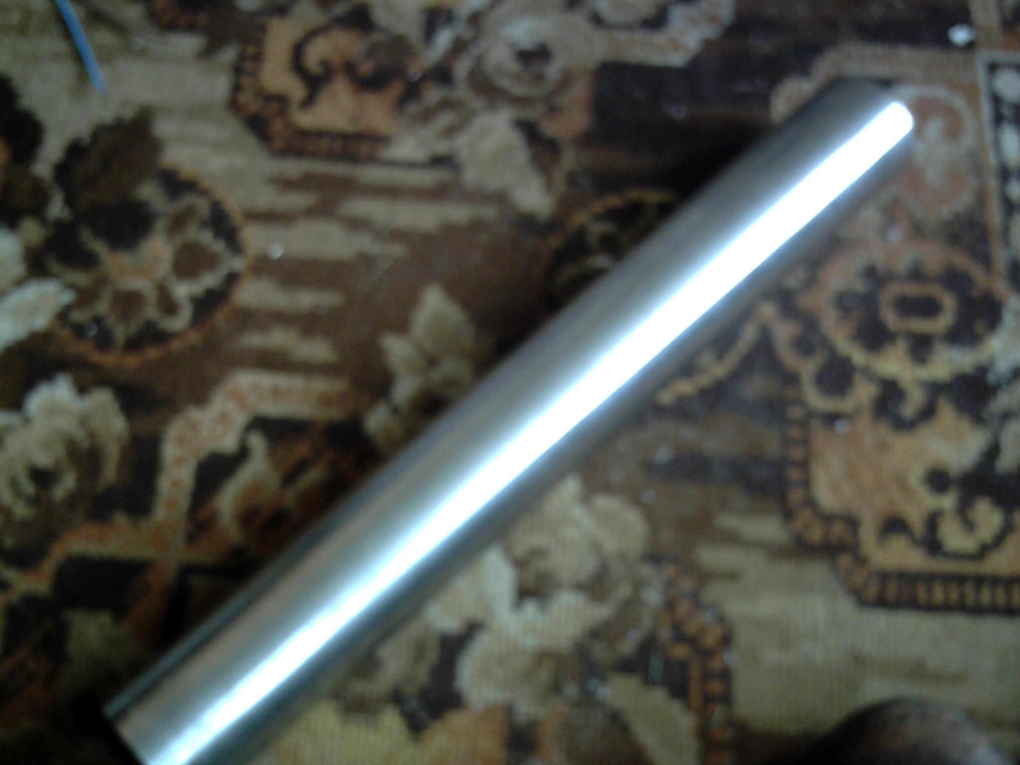

  3. Just had the column for my mill turned on a proper lathe mine only traverses the length of the compound slide so no way I could do something this length. The guy did a really good job and also trued the ends up. Next stage is to weld on a wheel flange from those old trailer parts. This will be bolted to the cast iron slab from the night storage heater(with appropiate shims fitted). You know how it is lazyness may set in at any stage. Hows your mill coming on????
    Cheers Keith Click image for larger version.

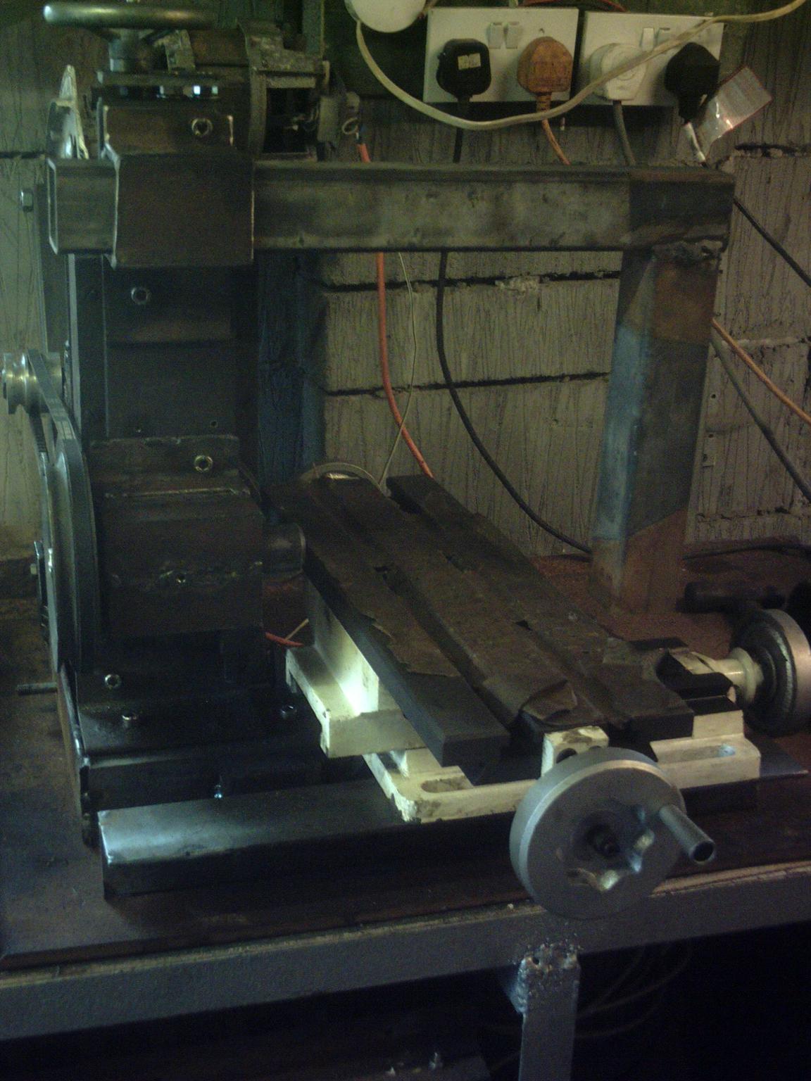

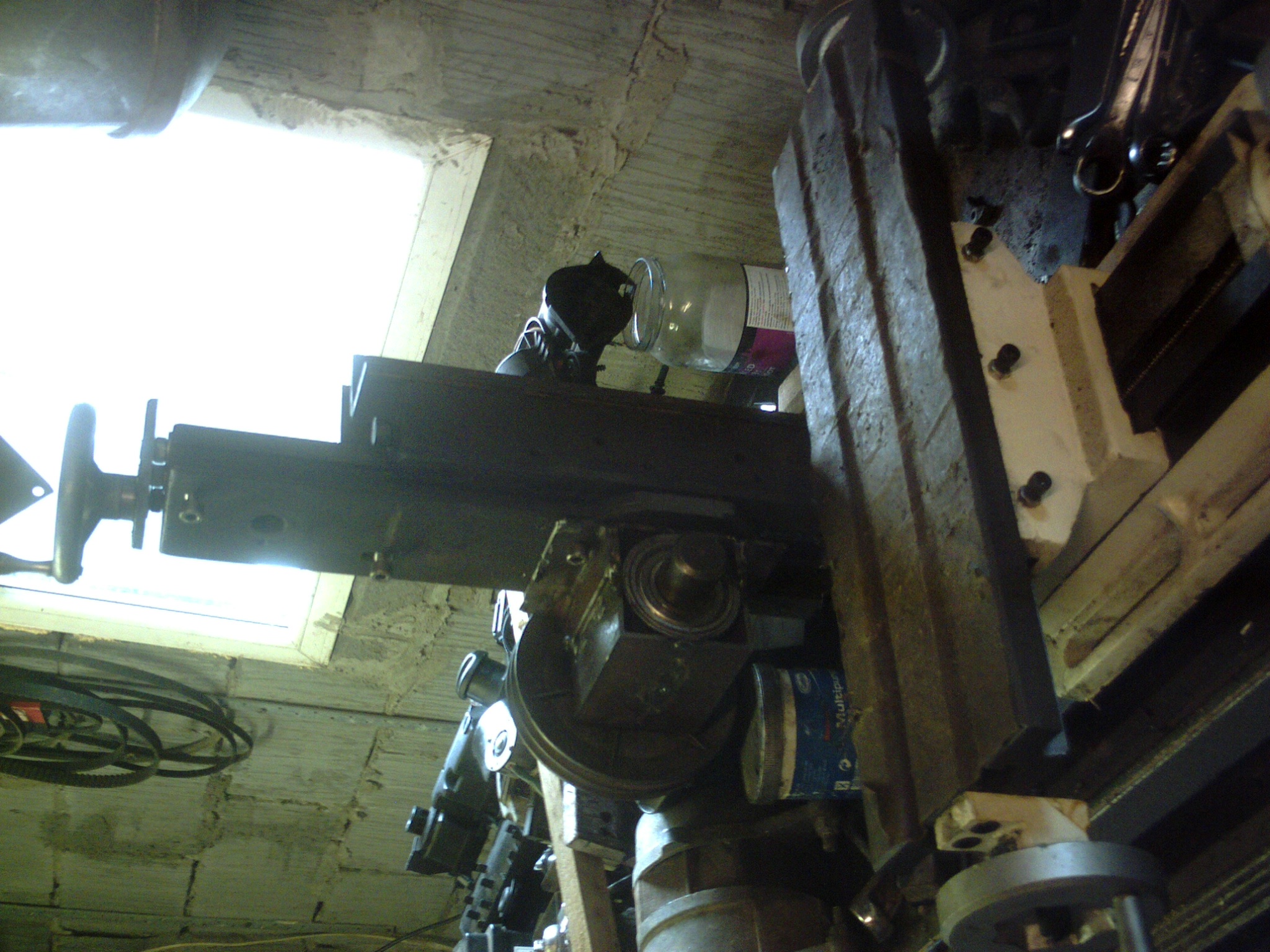

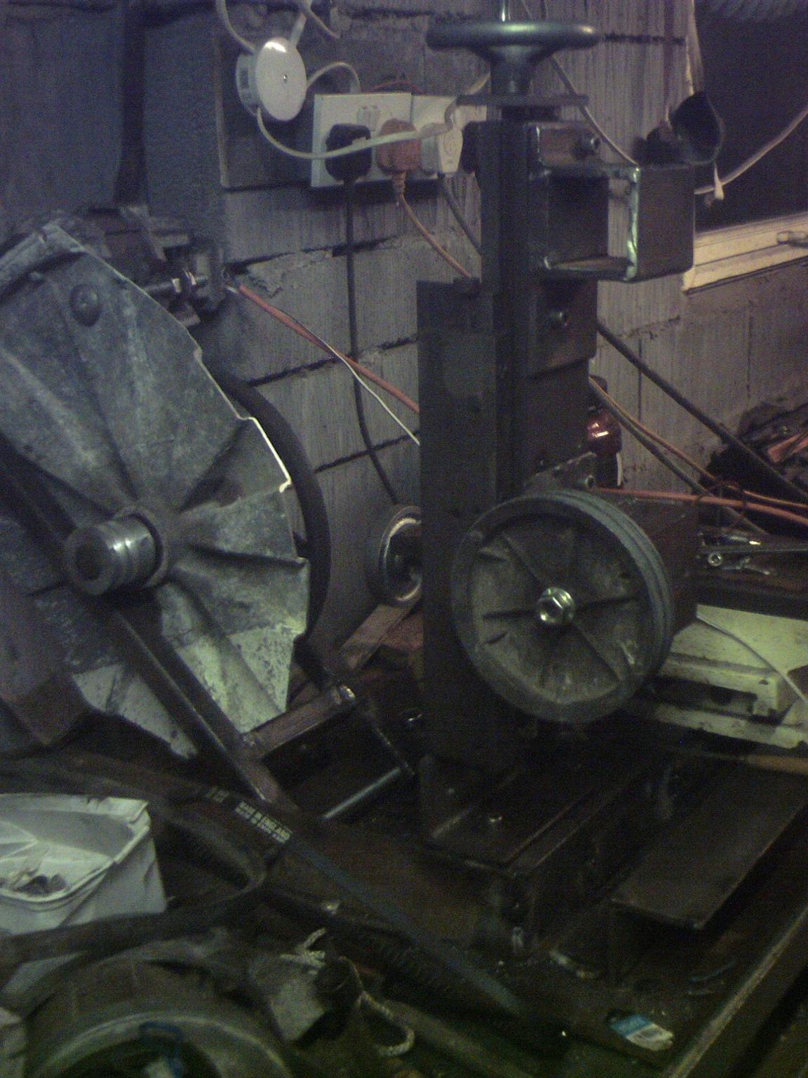

  4. Hello All
    I have abandoned the idea of making a vertical mill in favour of a Gingery imitation. I looked at various designs including the Westbury and decided driving a moving vertical spindle was too much of a problem.
    The Gingery mill is based on the old Lincoln design using flat belts much easier to accomodate spindle movement.
    The bits use angle iron bolted together (tack weld when adjusted). I cheated by buying an X-Y table.
    Spindle is from a washing machine drum and I will be useing my motor controller to avoid multiple pulleys. Click image for larger version.
ID:	10490Click image for larger version.
ID:	10491Click image for larger version.

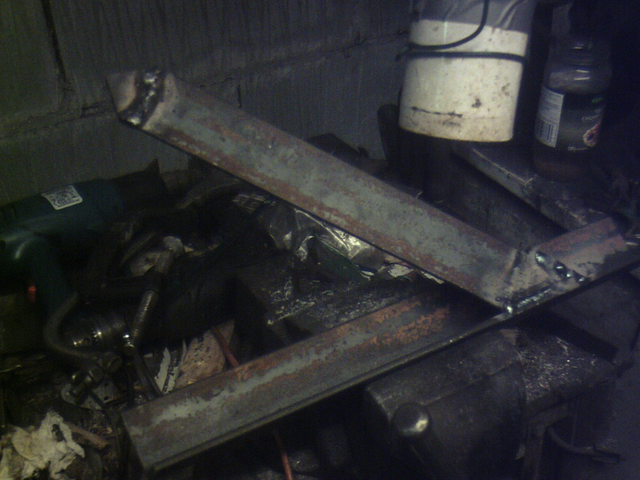

  5. Sorry for my last post having pics all over the place I am an engineer not a computer operator. Any way my mill is progressing. I have to ensure the vertical slide stays at right angles to the bed. Click image for larger version.
    For this I have made a triangle spar here it is colling down in the vice do not want to get burned fingers !!!

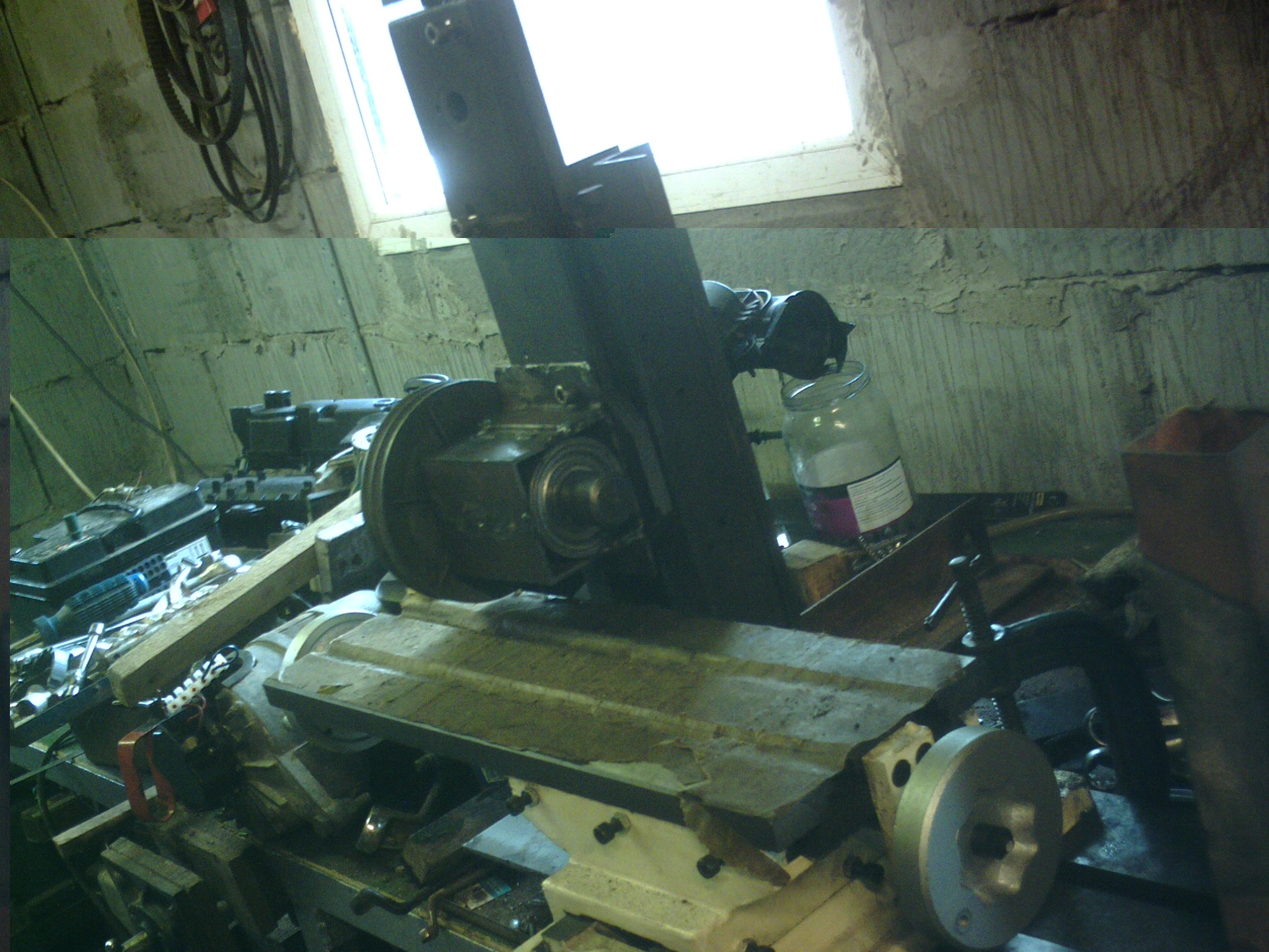

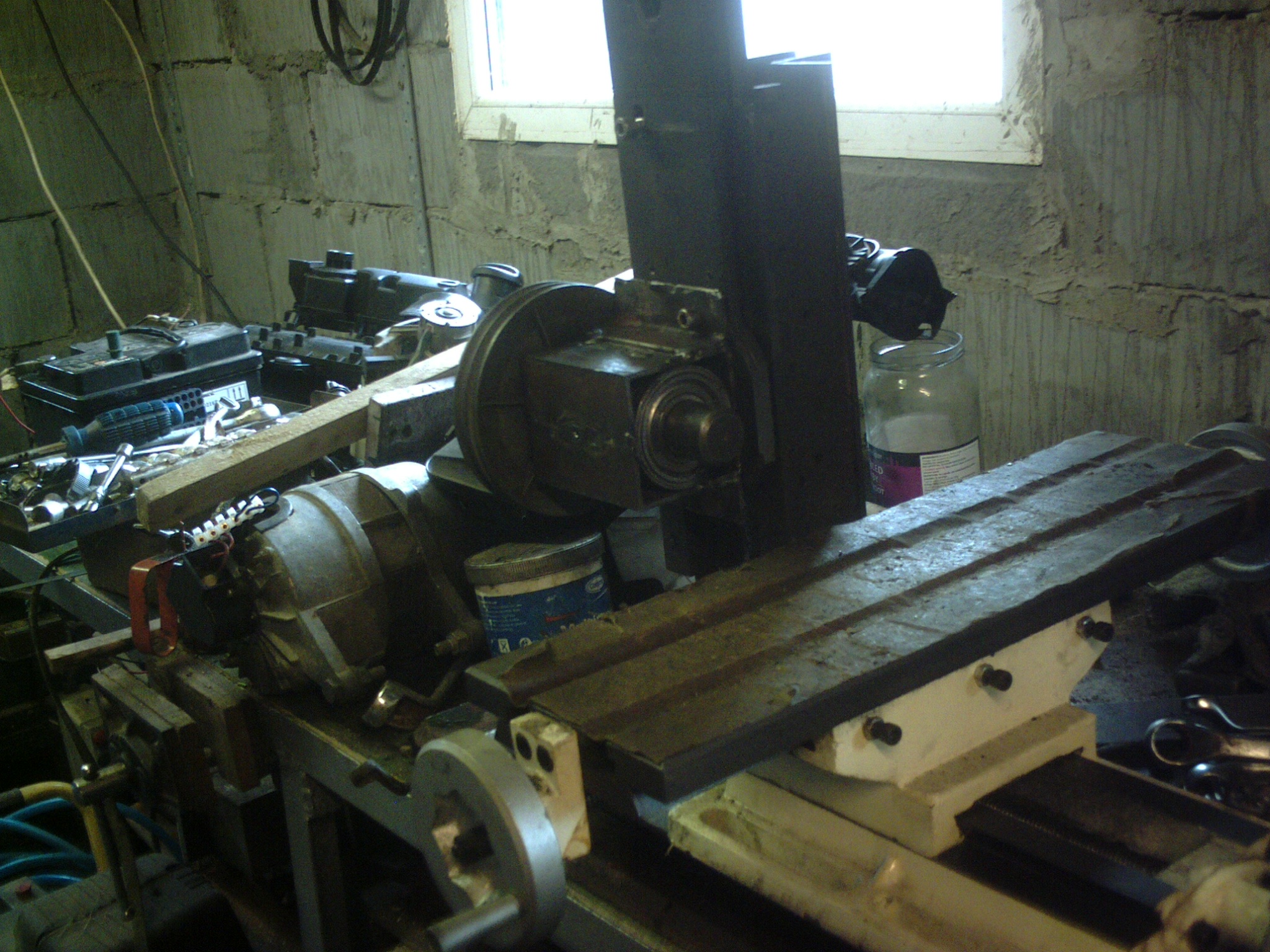

  6. Sorry Lee , Robin and Irvin
    You started this thread and the mill that I am making is not CNC at least at the moment. I have no access to machining capabilty except an old lathe which drastically needs new bearings. As I have allready said I considered the Westberry vertical mill design but here were several reports of chattering on the sliding column. Here is a better pic of my design inspired by the Stepperhead, Gingery, Multimachine designes.
    Many thanks fer birthday wishes cheers Keith

  9. Hi Wiremonkey
    Sorry for not repying for so long, I have loaded up win7 and had lost my log in.
    Its some time since I built the Gingery mill clone. Its all steel and uses the slide is off the lathe(capston) as vertical slide. I actually got the xy automated by using wiper motors and an optical system on the motor shaft. I was able to do this using CNC pro which has a stop feature. The prog is stopped until the step is successful.Most of the running gear is off washing machine parts. I boxed a drum bearing for the head and use all the pulleys and motor. I actually sell the motor controller for these universal brushed motors. These motors are ideal being around 1HP and variable speed from 200 to 12000 RPM. At present I am working on making the PCB,s for my speed controllers surface mount, I have a cheap cnc router table which is used with Inkscape and Zeus to mill out the pcb. I think the old cnc progs had many advantages eg with zeus you can stop at any point and trim the position of the tool, half way to conversational cnc.
    Not idle Ha Ha Keith
