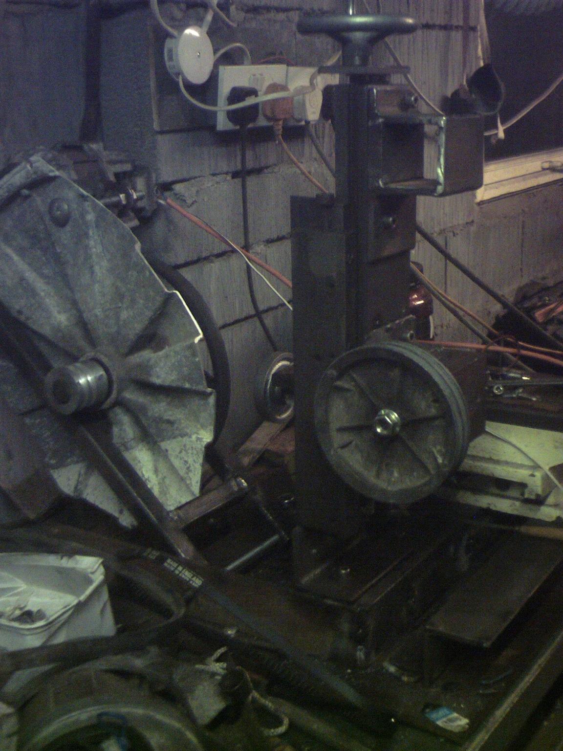

Hello All
I have abandoned the idea of making a vertical mill in favour of a Gingery imitation. I looked at various designs including the Westbury and decided driving a moving vertical spindle was too much of a problem.
The Gingery mill is based on the old Lincoln design using flat belts much easier to accomodate spindle movement.

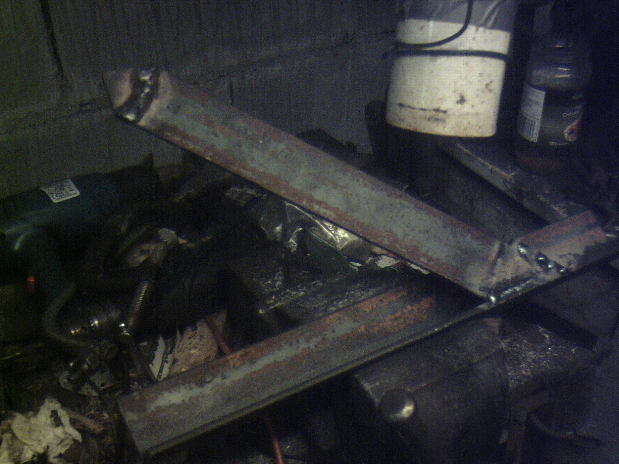

The bits use angle iron bolted together (tack weld when adjusted). I cheated by buying an X-Y table.
Spindle is from a washing machine drum and I will be useing my motor controller to avoid multiple pulleys.
