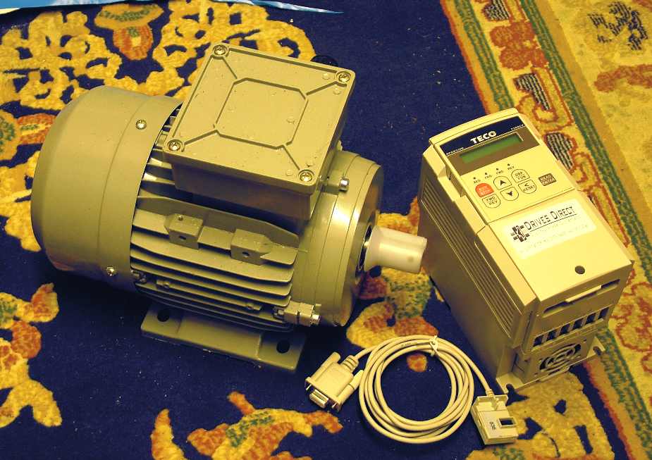

    I was feeling grouchy one day, reckoned my mill was overpowered at 2hp, noisy, had a poor selection of speeds and was not very quick... so I bought a pukka 1hp motor with a matching digital phase converter and computer cable.
    Slow to twice normal speed with no loss of power, soft starting, reverse, da woiks.
    It's been lying around ever since, but I will do it one day... honest I will

  3. Quote Originally Posted by Robin Hewitt View Post
    and your point Robin? I always finish what I start, well mostly
  4. #14
    My point?
    My point being that I believe the best way to drive a mill is a DPC but I have yet to explore the possibilities.
    I have a feeling it would be nice if the machine could autoselect the correct speed from the G code, not start with a bang, maybe apply the brakes so I don't have to wait while it slows down etc :D
