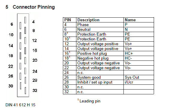

    I have the 500w Telecom PSU ( same as the E-Bay one). very much a newbie and need to know which pins to use to connect to a PM 752 Driver Board

  2. Here is the pinout. The pins you need are:
    12 and/or 14 to the +V rail on the driver P2 connector
    20 and/or 22 to the GND connection on the driver P2 connector
    hope that helps
