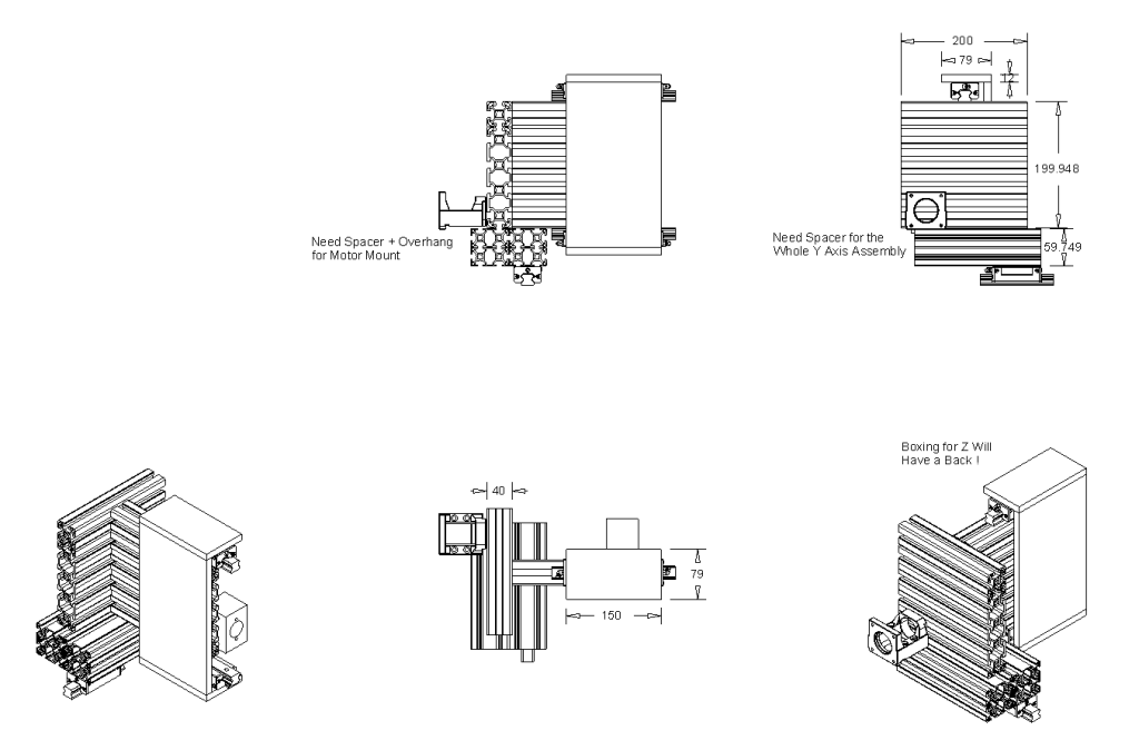

    I'm toying with a design that's a cross between Steve Hilton's beauty (http://www.mycncuk.com/forums/showth...u-lot-for-this....!) and the Heiz 1000. Work area about 1000 (+/-250 will do) by 600 with a Heiz style open base. Usual unrealistic scope of requirements, at one end PCBs would be nice the the other end ali plate of course.
    As my current tool set is limited - b&q bench drill (I call it Rumble the 2nd, love it to bits), circular saw, Trend router - I decided to try the design using ali profile and avoid the need machine thick plate. Profile is great, for bolting to profile, but none of the basic cnc parts are designed on a 40x40 matrix :lol:. The further I go into the design the more little spacer/alignment plates, whatever you call them, I need.
    The breaking point came when I tried to figure out how to join the X and Y and Y motor: bolt the Y to a plate oversized to match the spacing of the X and make a sticky-out bit for the motor housing and another to support the base of the Y span. Combine this with spacers for the X gubbins and the fact the Z box thing needs to be plate to keep the overhang down and, well, that makes quite a lot of plate already, is it really worth continuing with the profile?
    For your amusement:

    The profiles shown are stitched together from Bosh models but are supposed to represent items from the Valuframe range so while the outer features are correct the inner features are mince.

    Minimum order £100, easy :) I just looked at the cost of the Y cross beam, say 40x200x700, sobering at about £70. Still, in this CNC game everything appears to work out at about £50 to £100 per part :confused:
    Time to do the pros and cons calcs..
    Cost:
    Plate: 700x200x20, something like Steve's, £50
    Profile: as above £70.
    Weight:
    Plate: 7.6kg
    Profile: 4.8kg
    N.B.
    While not total mince, my inability to read all the instructions on botlanta web page resulted in deflection calcs that do not compare like for like, see post 15 for corrections.
    Deflection due to 200N vertical force:
    Plate: 0.02mm (http://www.botlanta.org/converters/d...c/bending.html, got to love imperial measurements, hope my conversions were correct)
    Profile: less than 0.00mm for 40x160 (Bosh profile deflection calc)
    Deflection due to 70N horizontal force:
    Plate: 0.82mm
    Profile: 0.01mm, again for Bosch 40x160
    Disclaimer: the above values are from my calcs and sources I've found, they may be total pants!
    In this case I think profile wins. k, back to the calcs...

    Too good indeed... I should check them again. Meanwhile, A quick sanity check...
    The formula is: Deflection =W*L^ 3/ 3*E*I
    Where W is force, L is length, E is Modulas of Elasticity in psi, and I is Second Moment of Inertia.
    Moment of inertia is calculated by (width * thickness^3) / 12
    So I varies with the cube of thickness.
    Looking at the horizontal force the plate is 20mm thick, the profile is 40mm thick. 40^3 / 20^3 = 8. Whoops, my calcs are 10 times that...
    A-ha, the Beam calc web page is for beams supported at only 1 end, the profile figure is for a beam supported at both ends. Note to self, just because the link comes from a CNC site it doesn't mean the linked page is what you think it is!
    There is a spread sheet around here somewhere, I'll get back to you...

    There are two here, one from Ross (#1) and one from me (#3). Mine includes the torsion calc (due to the cutting force being offset in Z from the gantry, trying to twist the gantry). You might want to consider that on top of the vertical and horizontal forces mentioned above.
    http://www.mycncuk.com/forums/showth...ail-Calculator
    As for cutting ali with simple tools, you can cut profile with a mitre saw with a metal cutting blade, so should be able to cut plate. Mine was a Rexon ~£100, but there are cheaper ones. Blade was a branded part at £44 - you can get cheaper but I didn't want it to let go and do me some damage.
