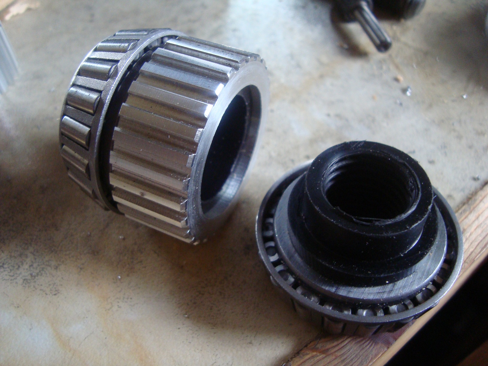

  8. #28
    Why not use ballscrews on the X-axis, but spin the ballnut instead of the screw. I know it's a bit more work to set this up, but it removes the resonance issues and greatly reduces the rotating mass...
    I'm doing this on my router, just with threaded rod not ballscrews:
    One of those on each side of the gantry.
  9. #29
    Hi Jonathan..
    That looks well funky.. I would like to see the completed unit included how you attach the motor..
    Steve..
  10. #30
    I'm attaching the motor just to the side of the gantry on a sliding mount thingy....much like I have on the Y-axis (see by build log). I'll mill a slot in the gantry side for the belt to pass through. The outer rings of the tapered roller bearings will be held in some 20mm aluminium plate, with bolts between the plates to apply preload to the bearings.
    It'll be a while until I make that.
    Note how I've made the delrin (might use brass...) nut in 2 parts, squashed together to eliminate backlash. That's the theory anyway.
