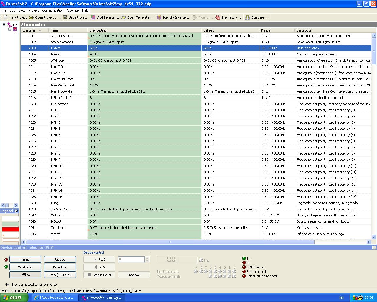

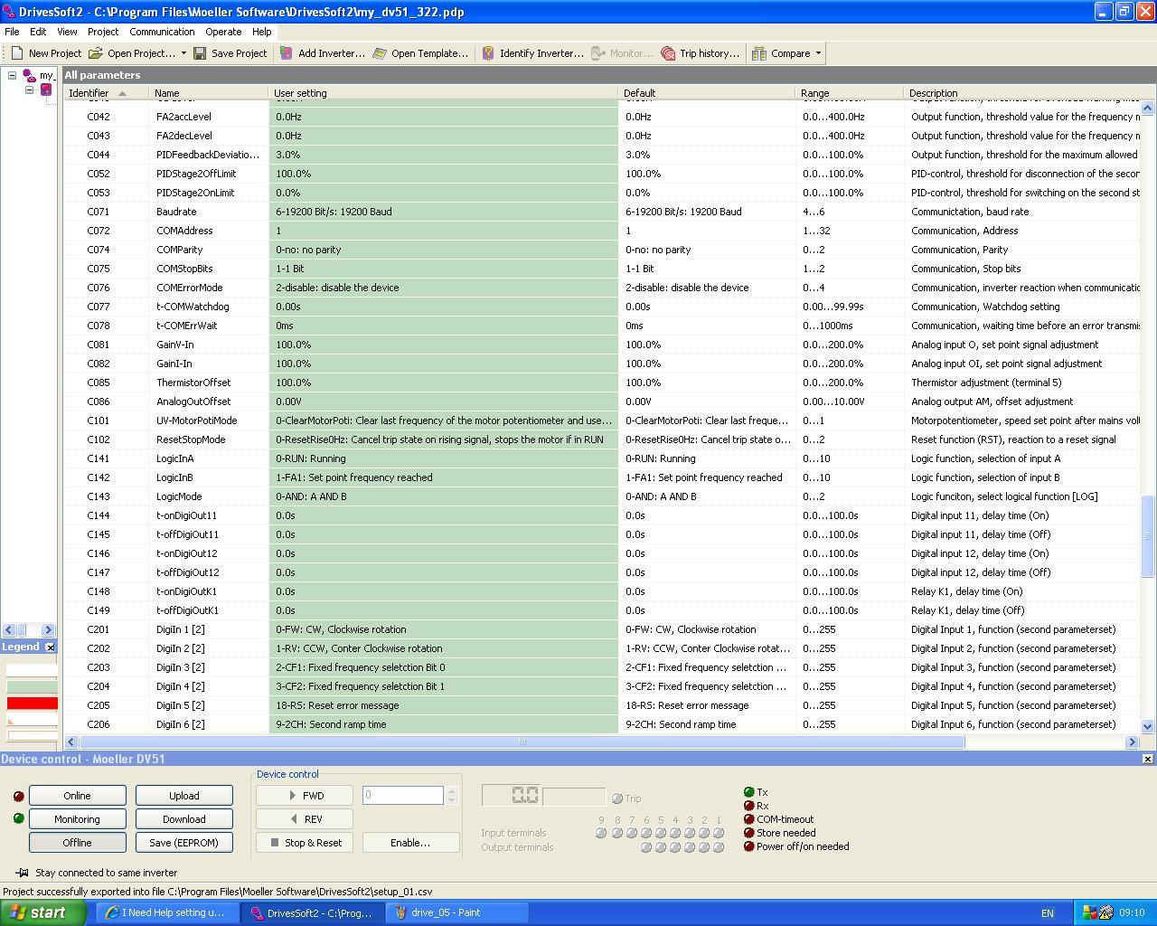

    I've started setting up my VFD, but can't get very much speed out of the spindle. Display shows about 8-12Hz and spindle is turning very slowly and whistles slightly.
    Spindle is the 1.5Kw water cooled one from 'lovehappyshopping', freq 400Hz, speed 8000-24000rpm, 8A, 3phase, 220V. Checked the windings with multimeter and there are no shorts.
    VFD is Moeller DV51-322 (1.5kW). I so far have set the following:
    H203 (power) 1.5Kw
    H204 (poles) 2 (also tried 4)
    H207 (voltage) 230V
    A016 (max current) 8A
    A003 (base freq) 133Hz
    A004 (max freq) 400Hz
    A044 (V/F mode) linear constant torque
    The rest I've left as defaults. I've also installed drive software on my PC which enables easy viewing of the rest of the settings. There are perhaps 100-150 settings listed and I don't know which ones to change to get the spindle to run quicker.
    Any ideas?

    This is the unit. I also bought the keypad (contains a pot which I've been trying to use to control the speed), mains filter, and braking resistor (not fitted yet):

    The software which comes with the drive shows all the possible parameters. The idea is that you can set them in software, then download them to the VFD via a RJ45 cable, but I've yet to get them to talk to each other, so I'm using the software to look at possible values, then type them in manually on the VFD panel. I've saved these parameters out as a csv file, attached below.

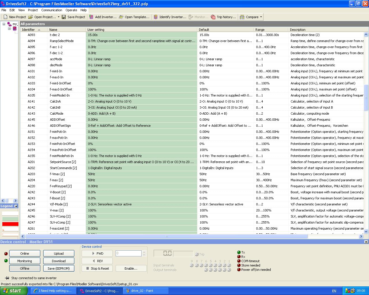

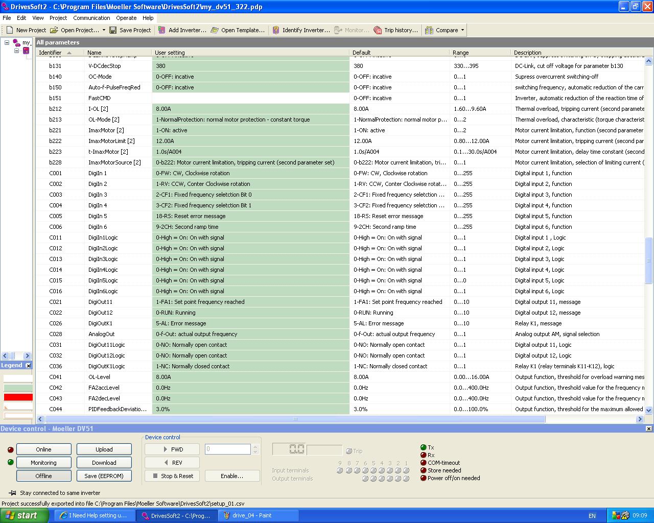

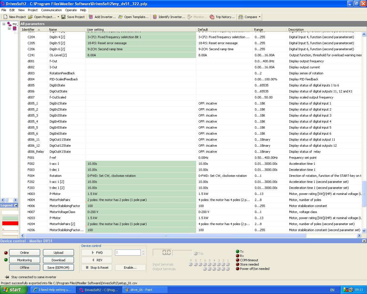

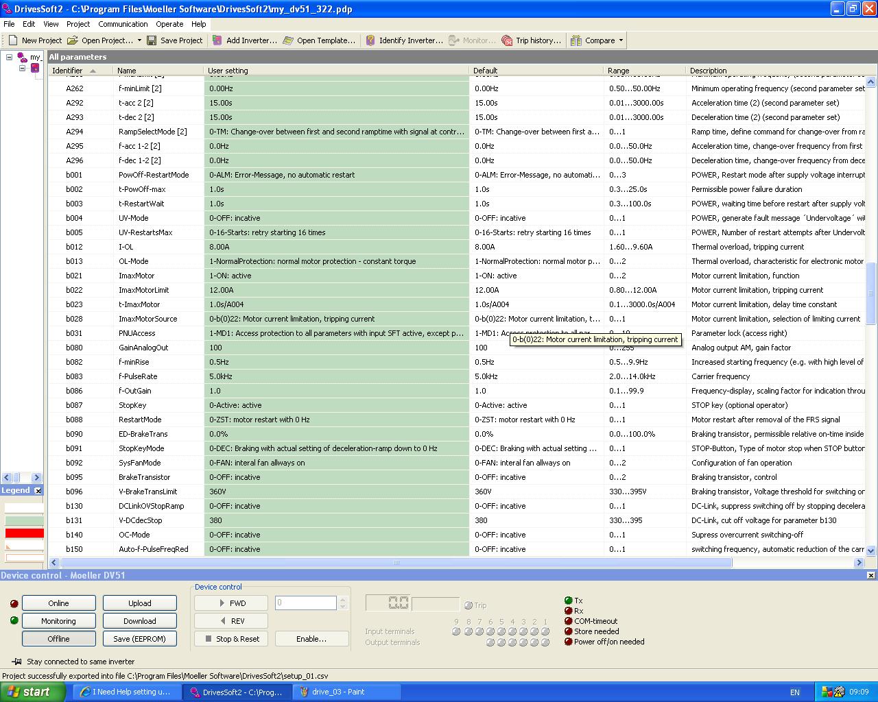

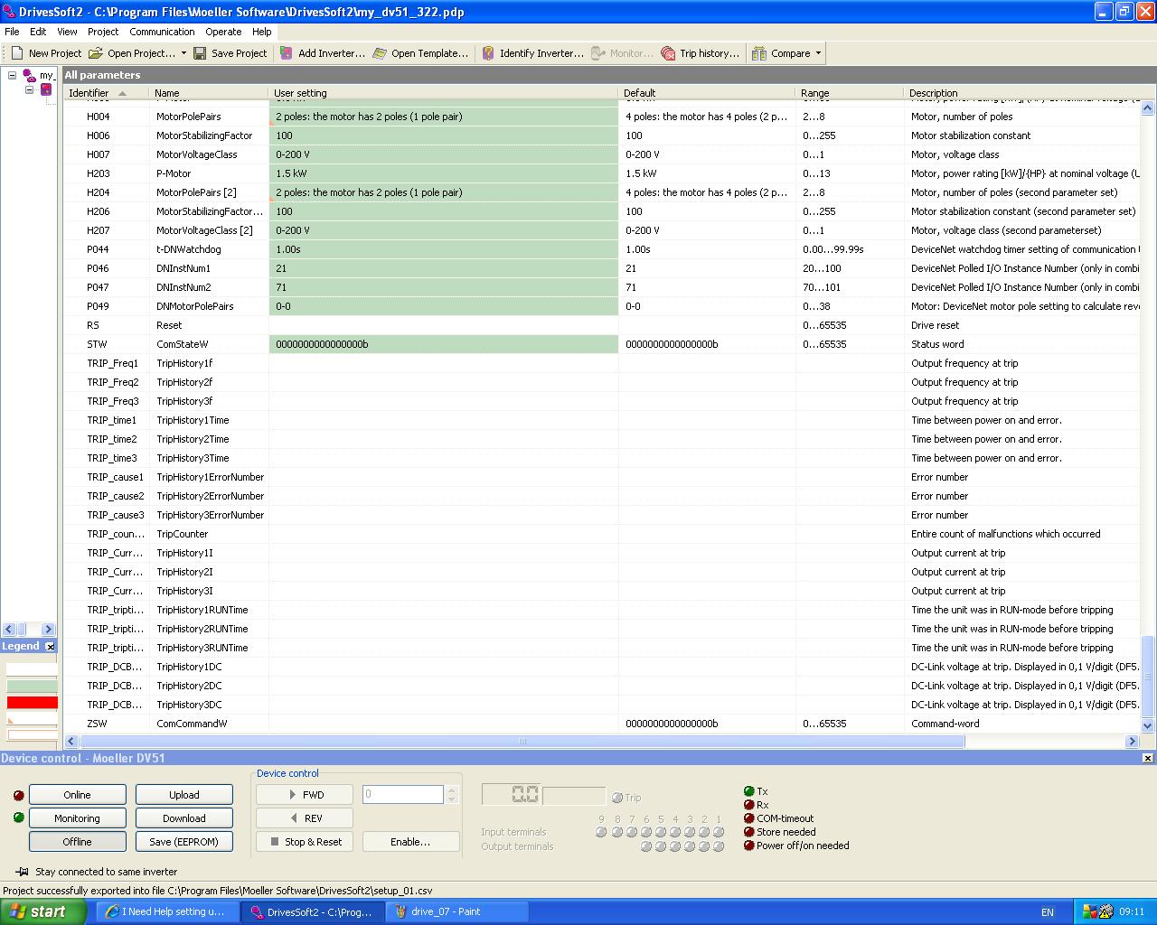

    I've also attached screenshots of the software showing all the parameter (sorry there are so many pages!)
    If I rotate the pot position on the front panel it will start whining, then spin up to a very slow ~12Hz. I can't get any more out of it.
    I then tried changing to 2 poles and 50Hz base freq but the spindle got hot quickly and ran roughly, so I stopped it straight away. I thought that base freq was the minimum speed, which is quoted as 8000rpm, so I had put 133Hz here because I'd read about overheating problems if you run these motors too slowly - although this might just mean air cooled ones. Or does the base frequency refer to the mains freq?

    CRACKED IT!
    Read around more and found a thread about setting the base freq to 400Hz (this was for the Chinese VFDs). Tried this and success! On the previous screenshots A003 and A004 should both be 400Hz it would seem.
    I'd kept the 2 poles as you suggested John, thanks for that. You mention base freq as 50Hz - it doesn't seem to like this, maybe that is for motors used on for lathes, drills etc rather than these Chinese Spindles?
    Anyway, working now. When I press the green {I} button, then spindle quickly spools up to 50Hz (stays cools, sounds nice). I can then rotate the pot and send it all the way to 400Hz.
    There are settings for this start freq and end freq (A061 and A062) which were 50Hz and 400Hz, which seem to be the ranges controlled by the pot.
    I then set the accel and decel to 2 seconds (default was 10sec) and it all still works fine. Since I'll be using small tools, with low inertia, I wonder if the braking resistor was a waste of money!
